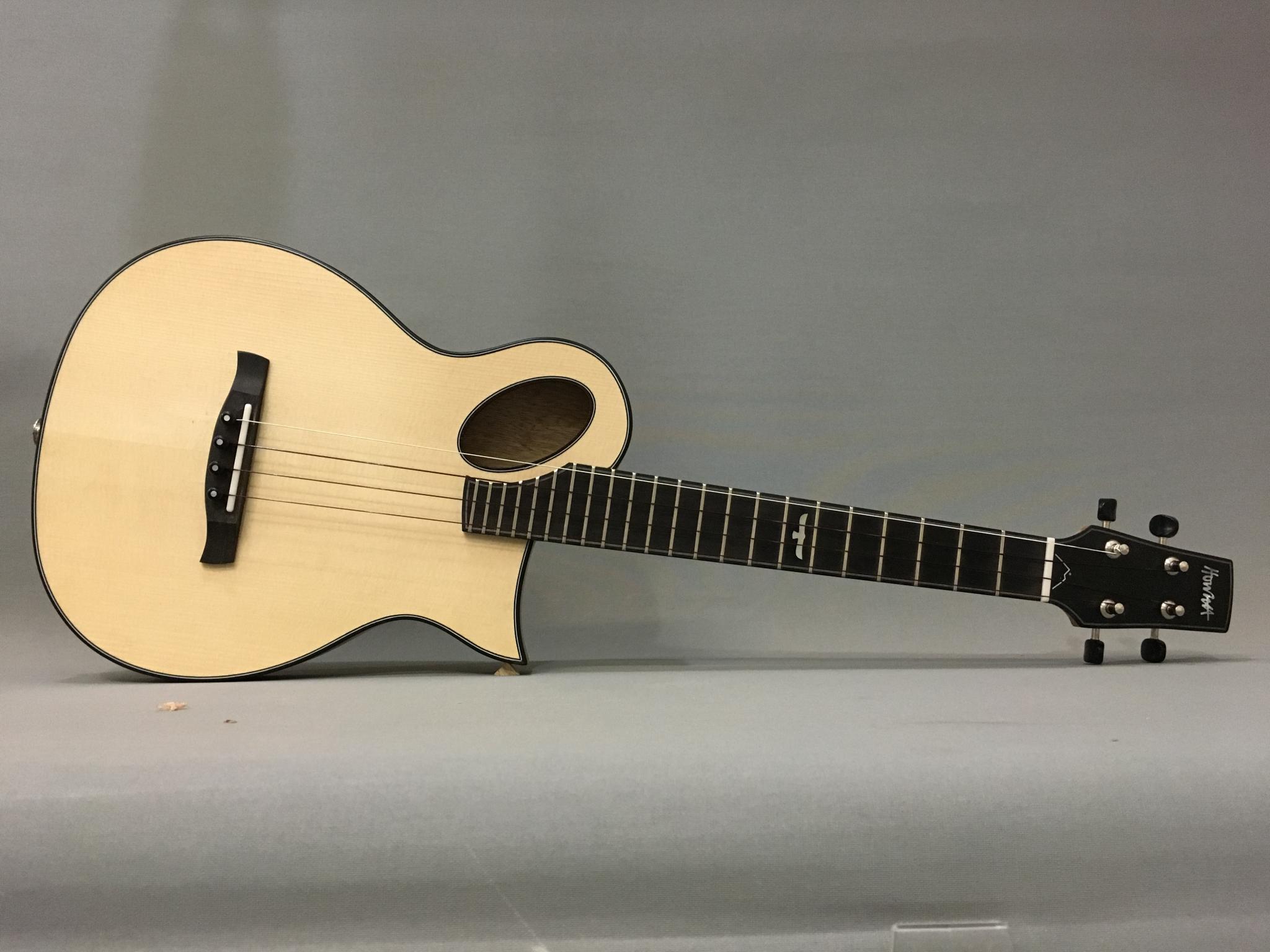

    And just so you know. I am a full time ukulele maker building stuff like this on my CNC router:
Name:	RTNO Front.jpg
