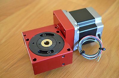

    I just remembered I bought a few of these a few years ago. Very high quality wormscrew mechanisms. Might be worth a tryout
    Rino Ondrives Worm Gear Reducer 30:1 Vexta Nema23

    They look like a top bit of kit - accurate to about 0.1 degree if I've read the Ondrives data correctly.
    They're certainly worth trying.
    Looking at the OnDrive website for Nema mount version, it looks like you can get either an 8 arc minute, and a 30 arc minute version, which is 0.1333, or 0.5 degrees.
    It all depends what kind of accuracy is needed. 0.5 deg works out about 1.3mm of movement at a 300mm diameter. Off course the 0.5deg figure is the worst case scenario.
