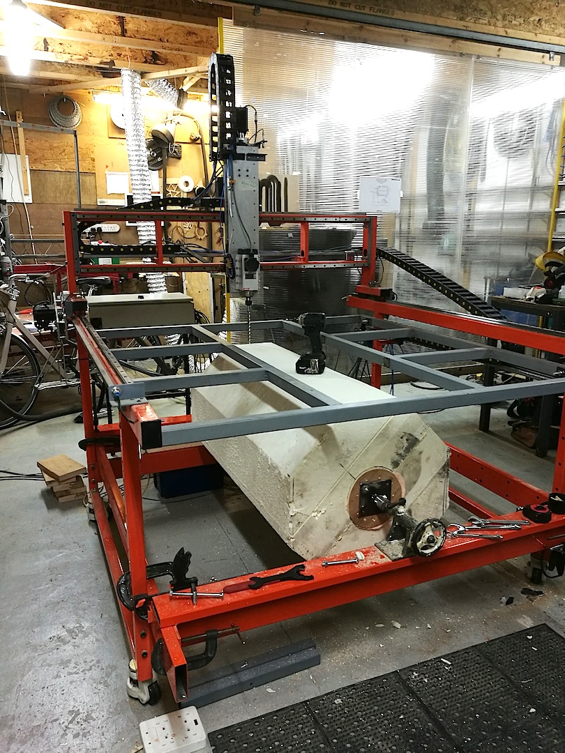

    I'm starting to mill some larger blocks of hardwood on my 4th axis using rotary indexing machining and I can see from the play in the wood when roughing at the extents of the block that the issue will only accelerate as I mill out to the edge of the stock. I've not had this problem with continuous 4th axis machining as i've been parallel milling down the centre line of the axis where there is least radial load on the stock.
    I've not really looked into this it only occurred to me tonight that maybe what I need is to be able to lock off the 4th axis between indexed rotations. Looking at my 4th i'll have to attach a brake rotor to the back of my 72t pulley.
    How have people solved this problem before?
    Anybody got a neat solution or a link?
    ps since the 4th was built i've changed the design a bit but its a standard belt and pulley set up with a nema 34 and an er32 shaft

    Just out of interest this is the kind of outsized 1200x600mm block of foam I attached to the 4th for milling out a sculpture in the past. Strictly parallel milling right down the centre of the 4th axis.

    I was asked to make copies of two sandstone statues from a building in Glasgow from photogrammetry captured models.

    More torque or more braking :)
    Only real solutions are, a bigger motor, more gearing (could go to double belt reduction, or screw and pinion), or add a brake.
    1st is likely to be the most expensive.
    2nd you lose speed.
    3rd you need to consider programming it (typically done through custom M-codes)

    Thanks for the feedback. Hmm I might have posted before about the big 3D foam milling, probably not this particular project though, see pic.
    I’ll start to look into the custom brake On/off coding and see if its something I can think incorporate without too much hair loss :). Yeah bigger motor could do, similarly the gearing as not concerned with speed just needs to work within the motors torque sweet spot.
    I was actually thinking not for this machine but another about making a big manual 4th/5th axis trunnion for a post lockdown job coming in. Something in which I can manually orientate large foam blocks, to orientate the part to mill a 5 sided objects using indexing milling strategies. I can just program each face separately, orientate the block, lock it off and run the file. As these will be in foam a small amount of rotational deviation will be ok and saves me tonnes of work and money trying to make a electromechanical version at short notice. As long as the tool tip is set accurately to axis centre/s should be ok.

    Yes and no, would be the answer to that.
    The big benefit of using a closed loop stepper in this application, would be they do tend to self correct to a certain amount so would move the stock back into position, and they would let you run things far closer the motors limit, however any movement could still scrap the part.
    It's a case of balancing up your needs, and what compromises you can make.
    I have just thought of one option if you don't need much speed, how about mounting a stepper onto a cheap rotary table?
    They should be adjustable for backlash, and they'll give you lots of gearing in a compact format

    I was in the workshop today trying to learn how to program simultaneously 4th axis and had a bit of wood on the 4th. When I put some pressure on the edge of the wood I can see a small amount of movement at the motor. I’ve got a digital driver on that 4th and wonder if it might also ‘have a go at’ self correcting, not as good as a closed loop thought i’m sure.
    From the movement I could see it looks like the wee pulley on the motor needs some mechanical advantage help so I think your idea of the rotary table might be better. I see people using 30:1, 100:1 gearing, what kind of gearing is on a rotary table. At this point I wish I knew more about mechanical engineering. ..
    All things considered was pretty surprised my attempts without using specific kinematic actually worked to program some simultaneously 4th axis action just using a basic mach3 post processor?!
