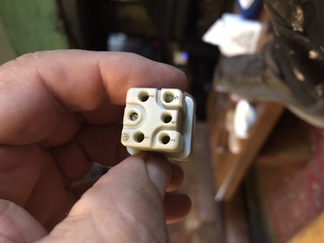

    Hi chaps, don’t you just get sick to death of Chinese crap with no manuals. Ok, I have three wires coming out of the huanyang inverter.these are U,V,W. CAn anyone please let me know which terminals on the spindle electric block, these go into. Click image for larger version.
ID:	28013 please see picture. Thanks, Michael
    Just an update, I found some information on the web. And wired the U,V,W terminals to the spindle block pins.1,2,3. Start the power and the spindle sounds like it is spinning up, but it’s not turning at all. Any ideas out there
    Do not power up the motor unless you sure that you connected it properly and set drive parameters correctly :)
    Do you have a multimeter that can measure resistance?
    You should be able to check between pairs of contacts, hopefully you will find 3 pairs with a similar resistance, the 3 coils of the motor. One of the other contacts could of an earth, which could be connected to the body of the motor.
    Quote Originally Posted by DaveL View Post
    In which case you really don't want to wire one of the phases to the spindle body... that would be a great way to get a very nasty shock.
    OP - Take care.
