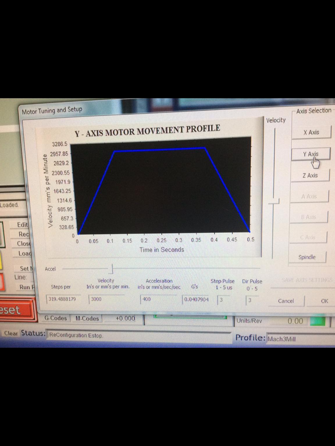

    You could still find that you have a problem with missing steps... what makes you think the TB6600 is quicker than the TB6560? If you're using Mach3 then I'd look on your motor tuning page and try upping the step-pulse duration if it's less than 5uS.

    I wonder what your settings are in the softwares 'motor tuning' pages?

    Slow?, that's strange - you have the stepper set to 200 steps (i.e. no micro-steps). Normally people configure the driver to around 800 steps/rev but that would make the axis even slower (4 times slower). When you read the switch positions you are reading from 1 through 6 (and not the other way around?) Have you changed any motor setting in the control software (Mach 3?)
    Good morning Doddy, I not sure what I’m doing with the dip switch’s as the old driver had 7 switch’s and the new one has 6, I’ve not made any changes to the setting in Mach 3.Click image for larger version.
