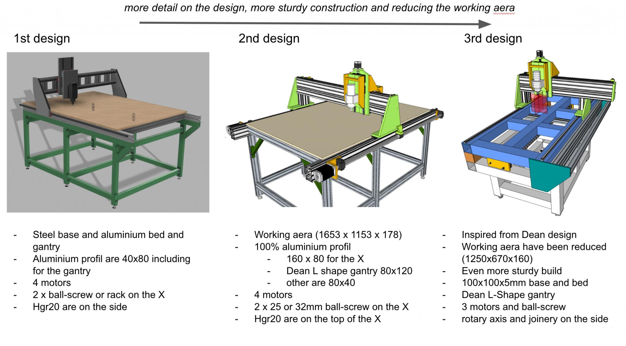

    I would do 2x in the L shape.
    The increase in weight is not an issue.
  2. #22
    Thank you for you reply pippin, I will make a draft with LShape (180x90) x 2 (It had approx 17kg to the gantry weight).

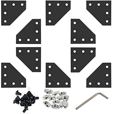

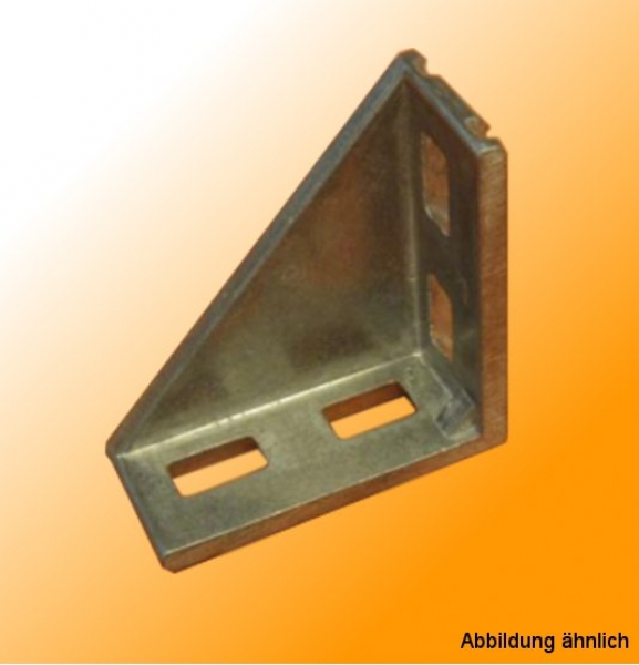

  3. #23
    I would use only cheap chinese side plates single and double row cast angle connectors in an aluminum build. No complicated stuff and is more sturdy
Name:	?image=aHR0cHM6Ly9pbWFnZXMtbmEuc3NsLWltYWdlcy1hbWF6b24uY29tL2ltYWdlcy9JLzYxOHl5cFExa2hMLl9TUzQwM.jpg
    these inside hidden connectors and connections are good for furniture not \CNC machines
