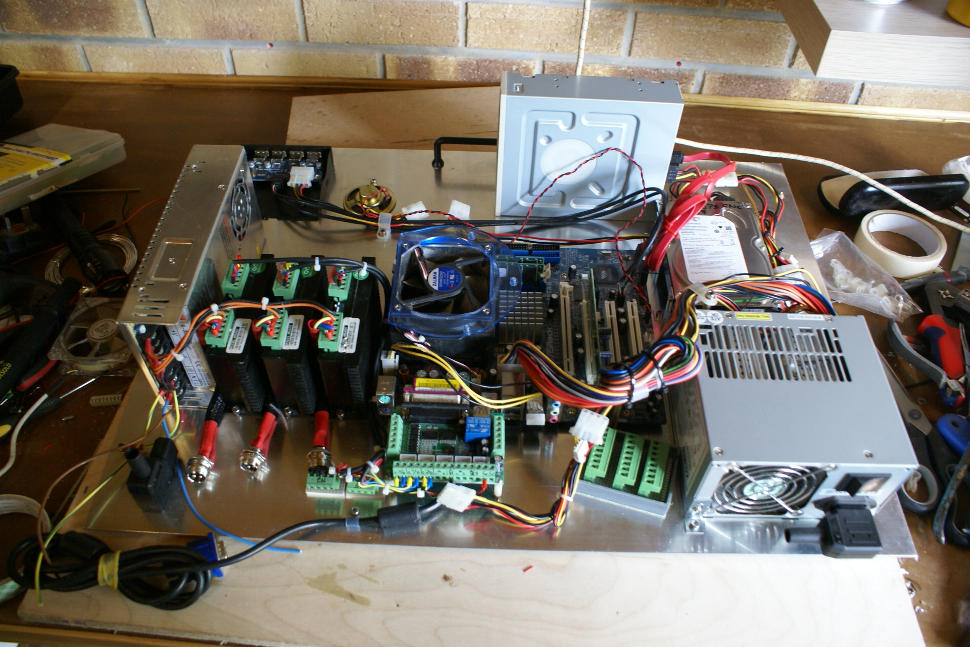

    Hi, I am rebuilding my computer and control box to sit on an ali plate mounted vertically in a cuboard on drawer slides.
    Now I need to think about the interface bracketry. The computer control (PWR,RST and leds) will go to the worktop box using a db9 cable and the CNC signals will be on a db15. Steppers will be on good ole GX16s. I just need to create a bracket with the right shape holes for it all.
    Does anyone have any links to files of the db cut-outs? I need to pull them into Fusion 360 to 'punch' them out on the design so I can 3D print a bracket.
    Every link I have looked at seems to be CAD files of the actual connectors.
    Ta in advance for any help.
    Happy Lockdown !
    Rob
    Every type of hole you want to stick it in, Knock your self out Rob.
    https://www.protocasedesigner.com/cutouts/

    Thanks Dean, I looked there, they are in inches. I suppose I ought to bite the bullet and magnify them by 25.4. I went metric in the '70s.

    Just scale the drawing up with by 25.4

    Just did

    Bugger me can't help some folks.!!. . . . Get the calculator out you lazy bugger, or if you really want to be lazy just use the scale and the magic number 25.4...
