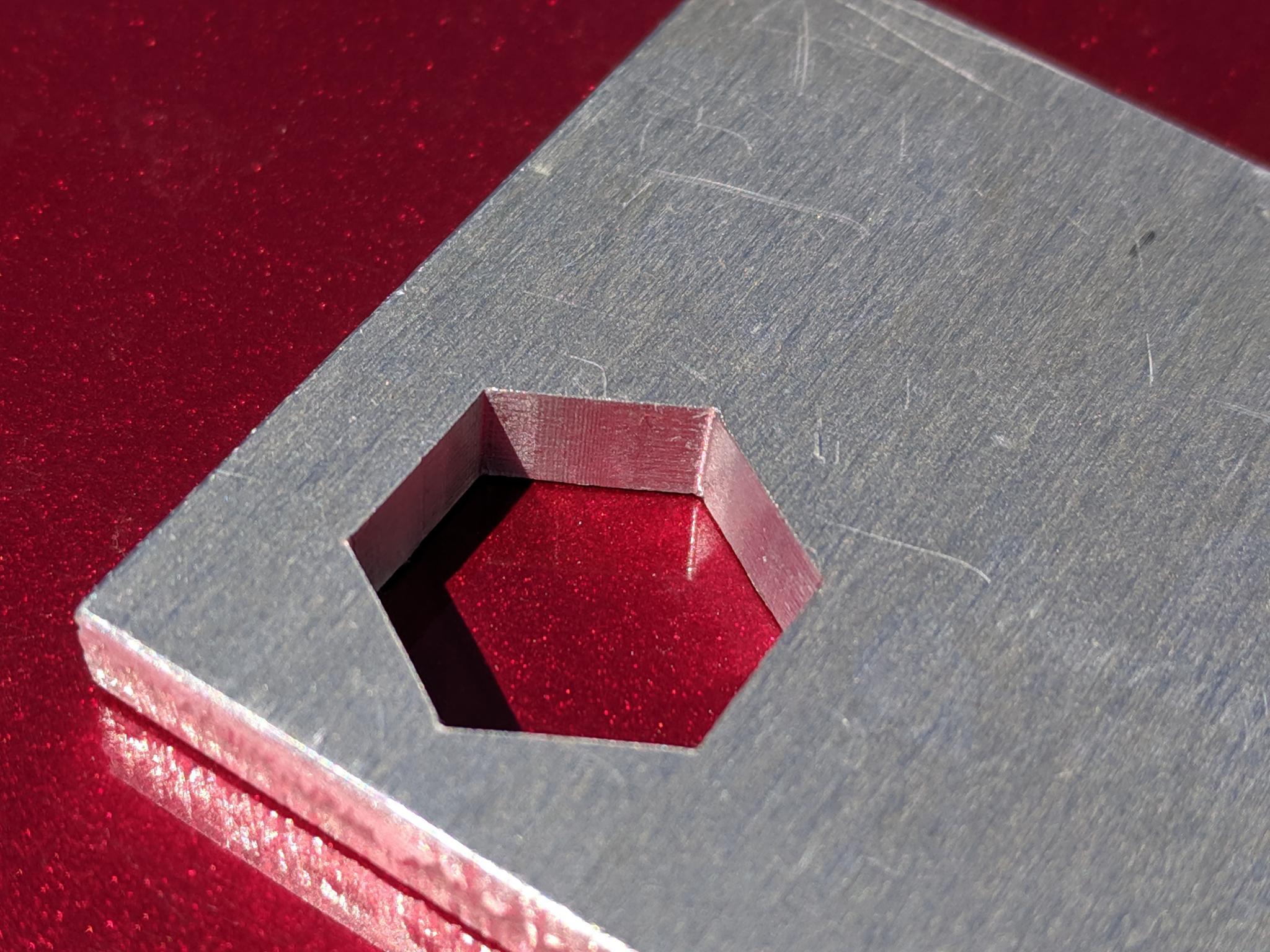

    I was bored during the lock down and my mind started wandering.. I had a spindle encoder on my little mill and was wondering if I could gear the x/y axis to cut a polygon. One of the developers of linuxcnc did something similar on his lathe as a proof of concept.
    So - it began...
    after figuring out my 144 count encoder wasn't nearly high enough resolution to do a decent job I upgraded to a 20,000 count per rev enocoder
    Then putting it all together..
    Nice rhythm you got going there Sam.. . . . Nice Job.
    Email: [email protected]
    Web site: www.jazzcnc.co.uk
    Amazing what is possible, thanks for sharing it here.
