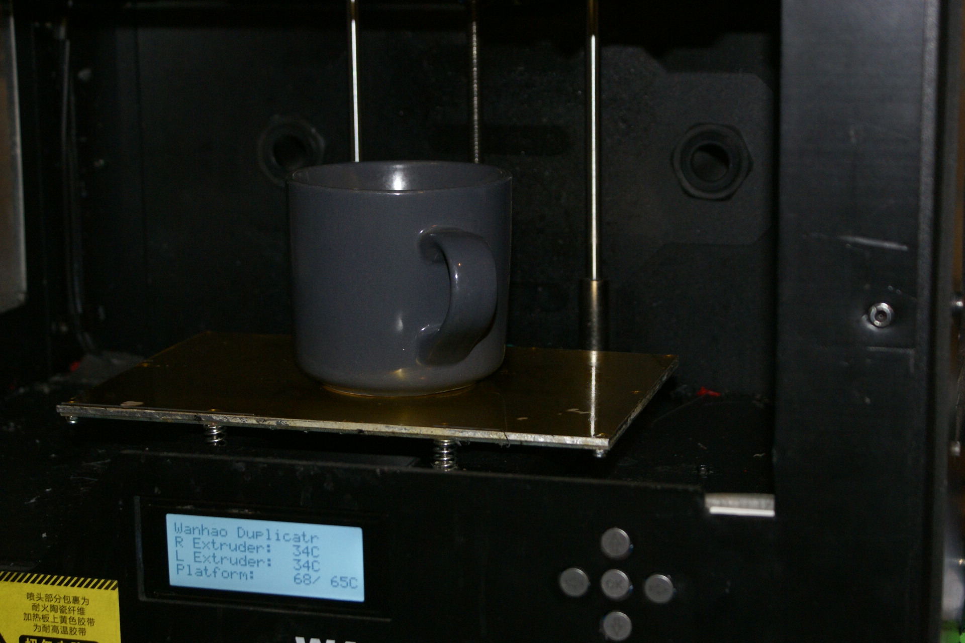

    Oh - by the way, if you have a heated bed you can use it to keep your coffee warm.

    Must print some more choccy bikkies.
