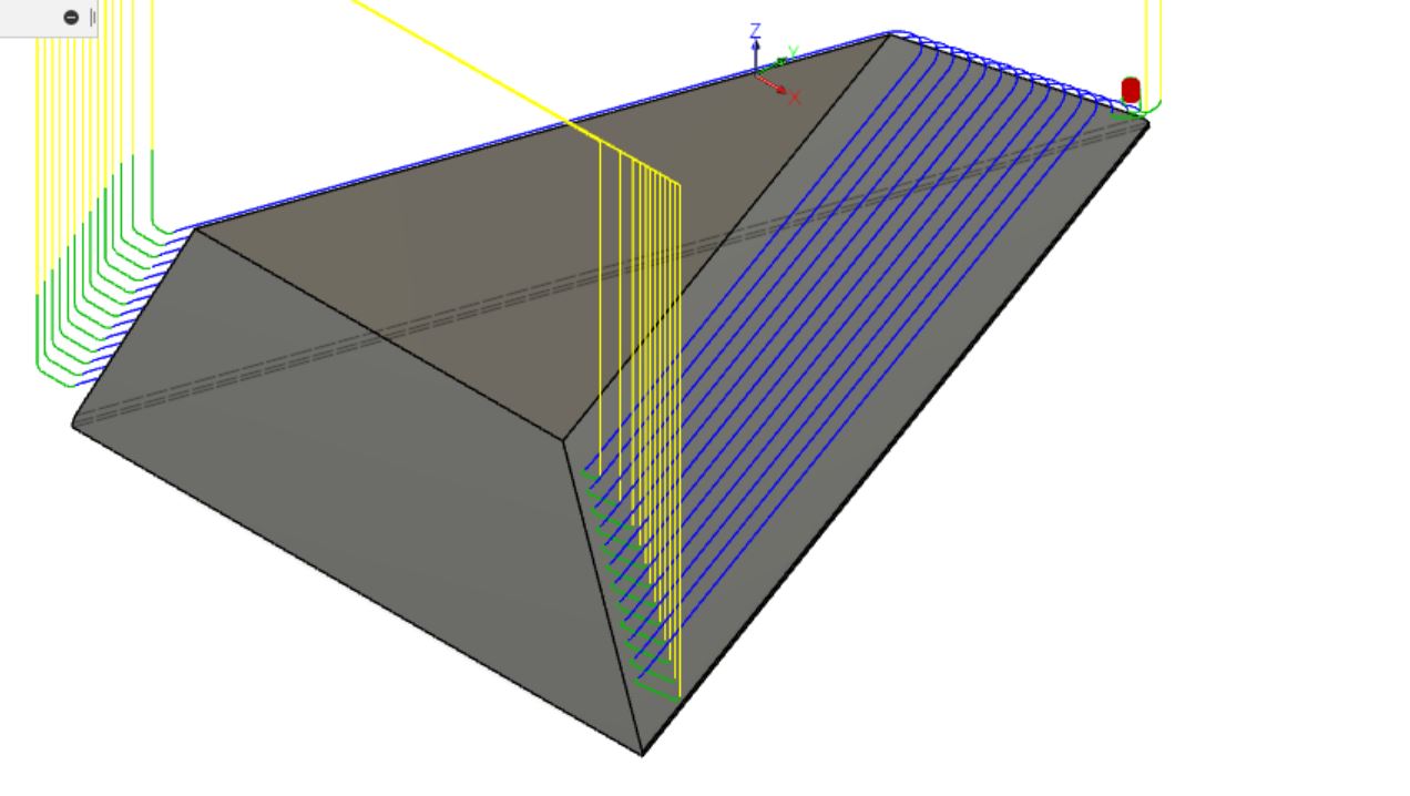

    I think this should be a simple 3d shape to cut - a simple flat triangle with a 72deg chamfer on 2 edges - the idea is to cut 5 which will then be stuck together to make a pentagon pyramid.
    the whole thing is quite small (25 mm from base to point) and I'm using a 1mm flat bit - I went for a 3d contour and it generates to toolpaths except for 2 very annoying things.
    I selected 3d contour and used the top and bottom contours to cut to
    the cut doesn't go all the way down to the bottom contour
    It won't cut along the vertical (short side) -I've tried using other modes with the same result
    I'm clearly setting something wrong in using contour (I've only used it in 2d mode before) - can anyone help me with what I'm dong wrong ??

    Share your file, happy to have a look at it later...
    In the meantime - is your tool long enough? Maybe increase the additional offset for the machining boundary...
    Chances are you'll sort it on your own after a bit of button mashing - F360's a bit like that..!
    Wal.
    Cheers Wal - I can't seem to be able to attach the file itself- saying invalid format - I'd be very happy to email it.
    I just tried it with changing the bit parameters to 1mm by 70mm long - didn't make any difference :-(

    Try zipping it..?
    just add .txt to the end of the file name
