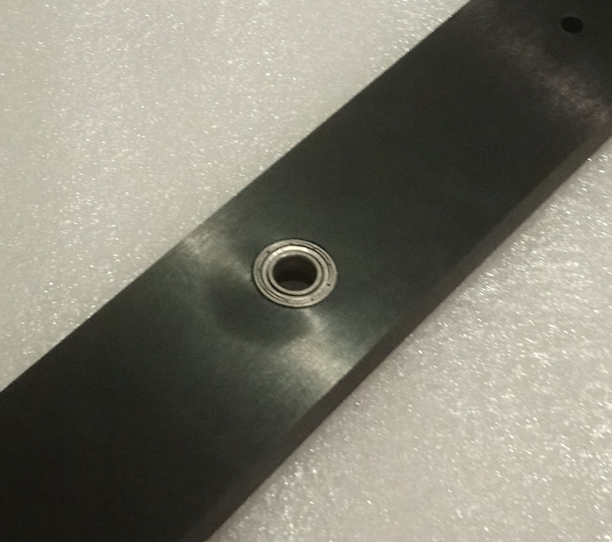

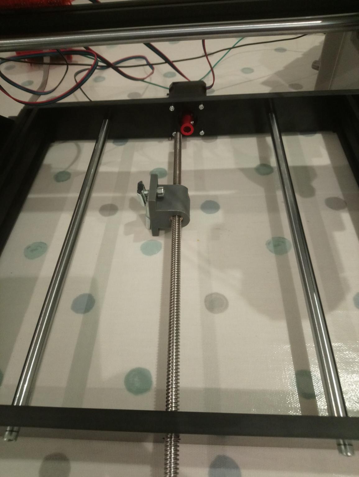

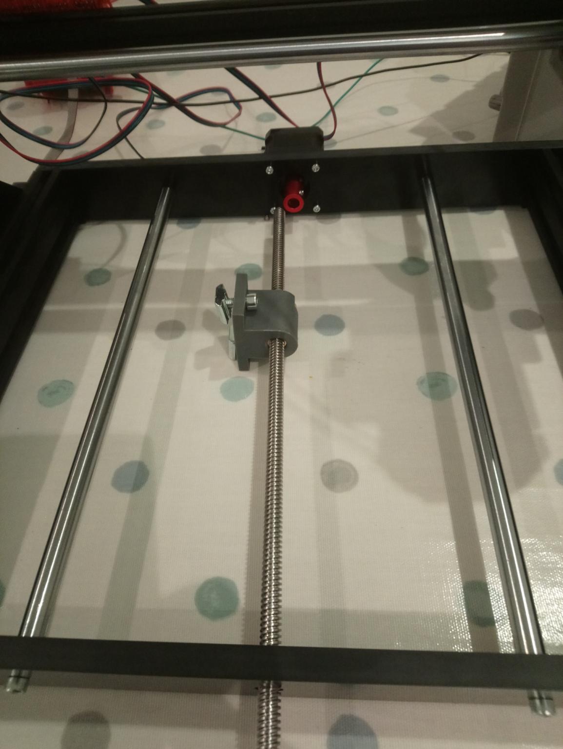

    Problem 3 is more difficult (in my head, at least) as my mechanical skills, experience and resources are not great. The "loose" end of the Y axis lead screw fits into a small bearing fitted to the front rail of the machine, which is made from bakelite. The bearing has not been pressed squarely into the rail so the lead screw does not marry up with the stepper motor on the back rail of the machine. The mis-alignment is enough to prevent the lead screw from rotating if it is forced into place. I am thinking that I might be able to get the bearing out if I can rig up a rudimentary press using maybe a vice, a small 1/4" square drive socket to push, and some plywood to support the rail, with a hole drilled in the plywood to accept the bearing.
    However, i'm worried that I may break the bearing or the rail. The screw is 8mm diameter, the bearing is 16mm OD but the hole I need to use for access to push the bearing is only 10mm diameter. So I could only press against the inner half of the bearing and I worry it would just break.
    I'm also wondering if it is worthwhile to try and use a vice to press the bearing properly home instead.

    I haven't tried pressing out the bearing in a vice.. but that's how I'd do it. bearings are tougher than you think. Just don't hammer anything!

    Have you tried using a hair-drier to warm up the plastic surrounding the bearing? They're just 3D-printed and so the material should soften.
