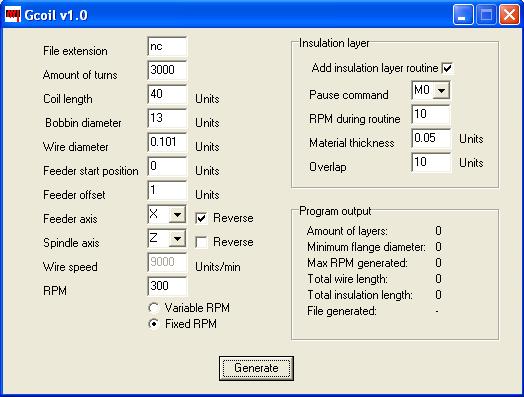

    I have posted about this before but I added some more programs so here is an update.
    Gsuite is a set of free gcode tools, mostly for PCB engraving. The source is provided with no license. Use it as you wish.
    Here is a summary of the content:
    I added some more programs. Here is an update.
    http://pilotpage.monosock.org/filead...suite_v1.2.rar
    Edit: v1.4 added:
    http://pilotpage.monosock.org/filead...suite_v1.4.rar
    Gflat v1.0 – Creates a milling pattern to flat the bed of the milling machine. It can generate both a conventional milling or climb milling path.
    Gopt 1.0 – Optimizes both drilling and milling paths. Tool changes are supported as well. This program is completely new and has different logic then existing optimization programs.
    Gpath v1.1– Removes close parallel tracks. This leaves only one track to be milled between pads which increases track quality. Handy for engraving fine pitch SMD IC's.
    Gskew v1.2– Compensates for skew or un-squareness in the milling machine. With some tweaking, the drill holes in the via's and pads can be aligned exactly. Handy for double sided PCB's.
    Gtime v1.1– Calculates the time it takes to finish the milling job. No more surprises. The job time is accurate to within about 10 minutes for large boards.

    New version: 1.3:
    http://pilotpage.monosock.org/filead...suite_v1.3.rar
    Edit: v1.4:
    Changes:
    Added a new program: Gcoil.
    Gcoil enables you to use your normal CNC milling machine as a coil winder.
