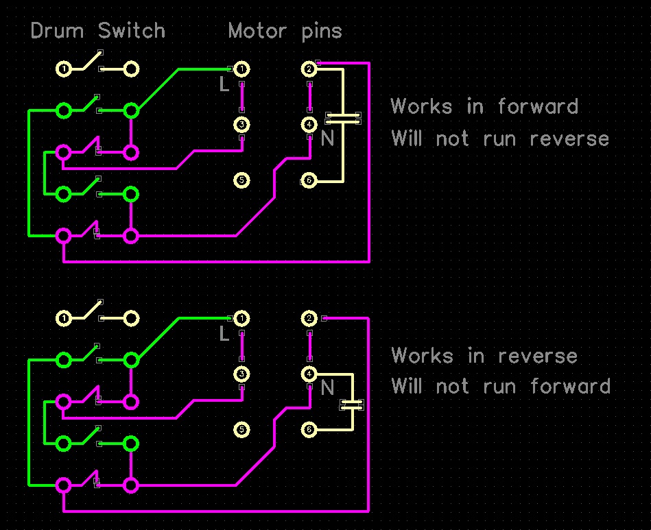

    Hoping someone can verify my assumptions:
    This is the motor on my Boxford VST (has one capacitor outside the chassis)
    My assumption is that by rotating the bars 90 degrees (red lines) the motor will run in reverse.....?

    Hi Mark,
    I think some of us can.
    It is just that i would want to see where the capacitor wires are going. just to be sure.
    Basically one moves 1 power lead from one side of the capacitor to the other.
    I cant really see where all wires are connected now so...
    I guess you have this setup.
    http://www.electricneutron.com/wp-co...-capacitor.jpg
    Grtz Bert.
    https://www.google.com/amp/s/www.ele...er-supply/amp/

    I have fitted a switch that impliments the bus bar change... it will now run in reverse ok but i get a single thud in foward but no rotation
    I swapped live and nutral which i didnt think would make any diffrence but i am now assuming if a swap them back over, it might run forward but not in reverse....?

    If there is something obvious I'm doing wrong, let me know :)
    If not, i shall continue the hunt for infomation on this motor.

    How it changes direction, depends on what kind of capacitor setup is being used.
    Essentially you need to swap how the two windings and capacitor are connected. If all you're getting is a thud, it sounds like you've missed the capacitor out of the circuit, or have shorted the capacitor out.
    I have tried searching for a suitable diagram, but have so far came up with nothing simple.
    I'd suggest putting it back to how it was, then try reversing direction with the bus bars.
    If that doesn't work, try moving the capacitor connection by moving the right/outer connection.

    I think I might have cracked it.....
    I have wired the cap to pin 4 instead of pin 2 (my error // I think my drawing is correct but my actual wiring is wrong)
    So in forward, pin 2 is not seeing the cap but in reverse it is.... ill know in an hour or so if I can get my hands in there with a mirror a light and a spanner :)
  11. #8
    No joy....
    Now it will run forward but not in reverse...…
    This has me baffled.
    It will run forward but not reverse with the Cap on pin2
    It will run reverse but not forward with the Cap on pin4

    This switching scheme rotates the removed bus bars through 90 degrees, is there a way I could cause damage by trying the cap on the other two pins?
