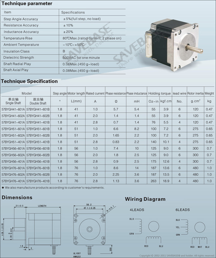

    The 0.25 ohm resistors should give you 2 A maximum. Your DIP switches are set for 75% current so that gives 1.5 A - not far from your measured 1.4.
    You should be able to identify your motor from this data sheet:
  6. #116
    I doesn't seem to be any of those! Body length is 53mm, phase resistance is 1.4R and phase inductance is 1.9mH.
    I found that when I set the current limit switch to 100% it ran worse.
    I could increase the voltage to the board. The motors nor board run hot. Is it safe to do so, and should I make that mod listed earlier - http://www.mycncuk.com/forums/showth...ll=1#post19305
  7. #117
    Did you measure the body length including the boss? If so it should be 51 mm and is probably a 57BYGH51-602A and produces 100 oz.in (about 0.7 N.m) at 2 A. Your resistance and inductance figure aren't a mile off considering the quoted tolerances.
    I know the voltage rating is higher than 24 V but, considering the reliability (or lack of it) of these boards I would be nervous of doing so. Some of the mods suggested on various sites are decidedly dodgy!

  9. #119
    Just measured my motors which are the 76 mm type and they measure 77.6mm so I still think you have the 57BYGH51-602A type.
    Your waveforms look strange to me. The voltage across the current sense resistors should go between 0.5 V and - 0.5 V at 100% torque or 0.375 V at your 75% setting. Is the earth on your oscilloscope properly isolated from the board? If I remember rightly the isolators on these boards only isolate the signal lines not the earth. Are all three outputs the same?

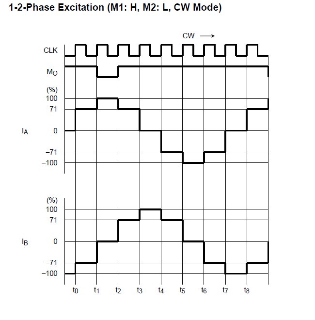

  10. #120
    Doh - I think I must have had a senior moment last night! I was assuming that the current sense resistors were in series with the motor but of course they are the other side of the output bridge so the current is unidirectional there thus it should be going from 0 to 0.375 V.
    Still the waveforms don't look right to me. I can't check on my board as I no longer have access to an oscilloscope but according to the data sheet the motor current waveforms should look like this:
    The waveform across the current sense resistors will of course be rectified.
    Hope that helps.
    Russell.
