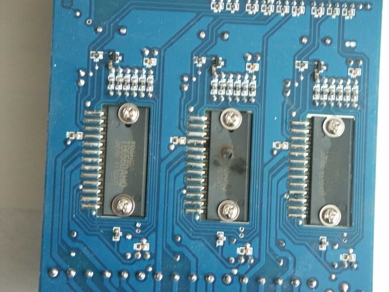

    Yes and do not not even once go over 24V with nema23 steppers or
    you can put out the frying tonight sign just like my bit of electronics did.

    Hi. Great thread! v interesting to read. Thank you guys for sharing.
    My Question: Is it possible to establish the cause of the exploding chip? and how to prevent any future damage?
    ........1. Back EMF caused it?
    ..................could it be the board has insufficient protection
    ..................maybe additional protection should be added - as described by irving2008 in this thread
    ........2. Something fries when a PSU of >24v is used?
    or some other reason?
    Surely too higher voltage from the PSU would have damaged the chip there and then?
    Does the delay in chip exploding (ie when next turned on) hint at back emf damaging it during motor rundown or at the end of last run and that damage only apparent when you next turned the device on and it exploded?
    PS. Anyone in the M25 with a CNC set up that I can come around and admire / ask a few questions about their implementation of driver board vs software and motors? Im a newbie starting out. I'll happily pay you for your time in beer!

    I don't really understand this as the actual Toshiba TB6560 chips have an absolute max VmA and VmB voltage rating of 40 volts and the operating rage is up to 34 V. Since it was the chip that blew and not something else on the board then I can see it was a pure over voltage problem providing your PSU was putting out less than 40V but preferrably less than 34 V. The Chinese data sheet for the whole circuit board states a voltage range of 16 to 24V for NEMA 23 spec steppers and 24 to 36V for NEMA 34 steppers. I don't really understand why there is a difference in voltage stated for NEMA 23 and 34 providing the current limit DIP switches are set so as not to exceed the particular Stepper motor current per phase for your wiring configuration (series or parallel). The power supply voltage selected just defines how quick the current limit value is reached for each pulse as it is driving an inductive load.
    The when the current pulse is turned off the inductance of the winding tries to maintain current flow so generates a large reverse voltage. The protection diodes are there to clip this reverse voltage and absorb the current from the motor in discharging the winding inductance.
    The larger your winding inductance the slower it will be before the current limit is reached when applying a pulse causing reduced speed and torque and also causes a bigger turn off reverse current as the inductance stores energy.
    A good fast stepper will have low inductance and series resistance.
    What is you stepper motor specifications Resistance, Current rating and Inductance in the wiring configuration you are using?
  10. #40
    So is it that Mr ChinaMan's circuit doesn't provide enough protection be it through poor design or poor component choice
