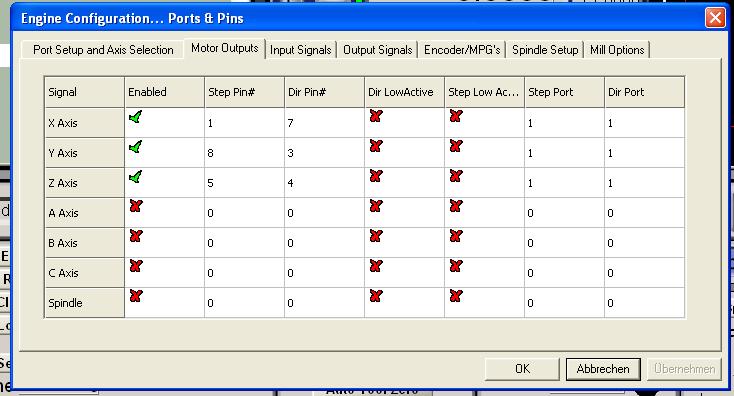

    the connection of the stepper motors is ok. Attached you´ll find screenshots from my mach 3 config which should be as suggested. I think the problem comes from PIN 1 with the permanent voltage of -0,22 V.

    Ok i checked you details against the manual located here www.lz4gv.com/CNC_files/3Axis_Driver_txt.pdf and it checks out correct so if all the wires are properly secured then it must be a problem on the board. I will assume you are using nema23 motors and the voltages for that motor are correct? they are wired for parallel operation?
    Have you tried swapping the motors around to eliminate they are he problem? Check the bios on your pc and swap between ecp and epp if you can, some bios have these together or separate. If all this is ok the power up and switch on (not running any operation and check for voltage on the output pins of the board to the motors (A+). Which ever one is not working trace back to before the driver chip to the input pin and see if it is getting a supply. If not then the chance are it will just be one of the opto isolator IC's. You can confirm this by swapping it for one of the others. If they are ok then it will be one of the driver chips. I hope this gets you going in the right direction to sort it.
    Paul

    thanks for the detailed answer. Can you do me a favour and check on your PIN 1 (X-Axis Step) the voltage you have ? I have permanent 0,22V. For Y Axis and Z Axis i have step Pin voltage of 0 V, when i move axis in MACH3, voltage changes to -0,02 V. So i asked myself if PIN 1 also should have 0 V when axis it not moved. Or is it normal that PIN 1 has permant voltage of 0,22V ?
    Andy

    ok, thanks Y/Z Axis working. X not working. I figured out that i have permanent -0.22V out of PIN 1 (X-step). While for Y and Z i have 0 V and -0,02V when axis is moved. So does anybody knows why i have these -0.22V permanent output ? The DIR PIN for X axis is working - so only the PIN 1 is the problem. I checked in mach, an no other functions are related to PIN 1.
    Thanks for any input - step by step t will work someday..
    Regards from Germany
    Andy

    yes now everything is working. I took a different computer and voila ! First i did use a Fujitsu Siemends Laptop - X Axis not working, now i use IBM Thinkpad - and everything is nearly fine. For Christmas holiday i want to get a cheap second hand desktop pc to get the full 5 V out of the parallel port.
    Anyway - my x-axis is still sometimes losing steps. I don´t know if this is a general problem with this chinese board or if there´s a mechanical problem. But each day my machine gets better...
    Good luck
    Andy
