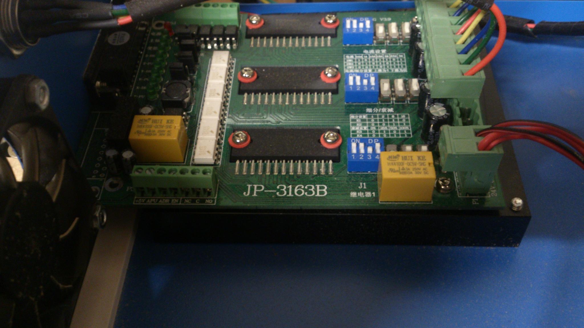

    OK so iv been trying to set up my 6040 cnc and to be honest i can run it and i have cut some MDF with it, but im not 100% happy with it. The problem i have is if i set the motor tuning to the recommended setting the steppers jam. To prevent this i have to run them at less than half the recommended settings. Here is a video of whats happening maybe someone can help,

    It would help if you gave some details about power supply, voltage, motor specs if you have them and driver.
    That would be a start so people can make an informed opinion. ..Clive
    Also do you have Mach3 set to mm or inches ?
    yer sorry this is what i have
    http://www.ebay.co.uk/itm/CNC-ROUTER...item2c5eac77af
    and this is what in the box and the steppers

    i dont know if that helps.. i also have mach3 set to mm .
    thanks for the help Mick
    It looks like you have this setup;
    3163B Stepper Driver
    set to;
    Dynamic Current = 2.5A
    1/8 Microstep
    50% Standstill Current
    57HD5401-14S/8 Stepper Motor
    1.8 step angle
    6.6V
    3A
    2.2 Ohms
    8mH
    17kg/cm
    4 wire
    24v 8.3A DC PSU
    1605 ball screws
    And that being so, the settings you have seem to be okay as far as I can make out.
    However I did a conversion of the motor torque setting and 17 kg/cm = 1.6671305 Nm, this is not so good but as your video shows they are not under load.
    I think you could reduce the microstepping and see if that helps, remember to change the Mach3 'steps per' to match.
    5m pitch
    1.8 deg motor
    1/8 microstep (8)
    360/1.8 = 200
    200/5 = 40
    8 * 40 = 320 steps per
    Reduce microstepping to 2 by setting K1 ON, K2 OFF

    ok thanks ill try that. im rite in thinking at the moment they are both set to on. so all i need to do is switch k2 down on all three . Then change the steps per to 80 . I do have 3 of these i could try and see if its any better if that dose not work .

    The problem with these motors in the inductance is far too high. Check these out:- http://cnc4you.co.uk/resources/60BYGH301B.PDF and see the difference, the motors you have require a much higher voltage to drive them. I would be selling them and getting some with lower inductance. ..Clive

    On the picture I looked at it says on the terminals 24V, Gnd, so are you sure it can be powered by 36V ? if it can then it might be a good idea to try the other supply.

    I agree I have a feeling that those drivers are only OK up to 24V So unless you like magic smoke don't go higher. Clive
