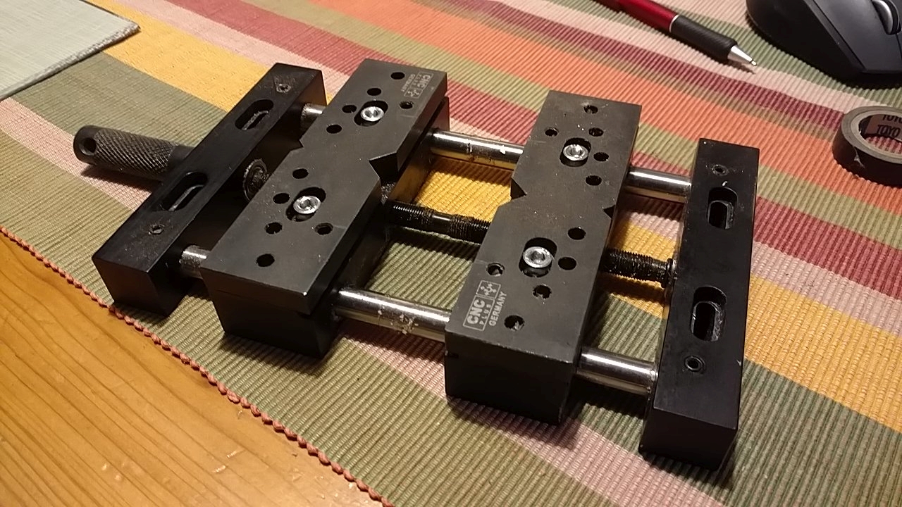

    I got one of these https://www.bk-faserverbundtechnik.a...8dtdn1fc9dls67 with a height extension and find it quite useful. I'm only a hobbyist but it's quite solid and has a low profile (without the height extension) Click image for larger version.
ID:	28285 and the price wasn't too bad.
    Andrew

    There is a base version that is cheaper https://www.bk-faserverbundtechnik.a...8dtdn1fc9dls67
    which might be usable. it's 82euros + shipping
    Andrew

    thanks for the suggestion, i would prefer fixed jaw as it would be easier to find the work zero
