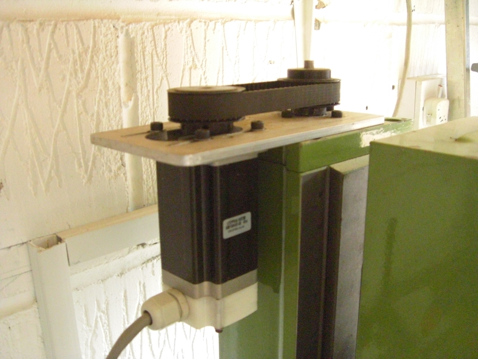

    I think I would increase the stepping and adjust the scale accordingly. I would also put a reduction belt on the Z axisClick image for larger version.

    Thanks, I've changed to a higher step count and it seems to have worked. I'll probably add a belt drive at some point too.
