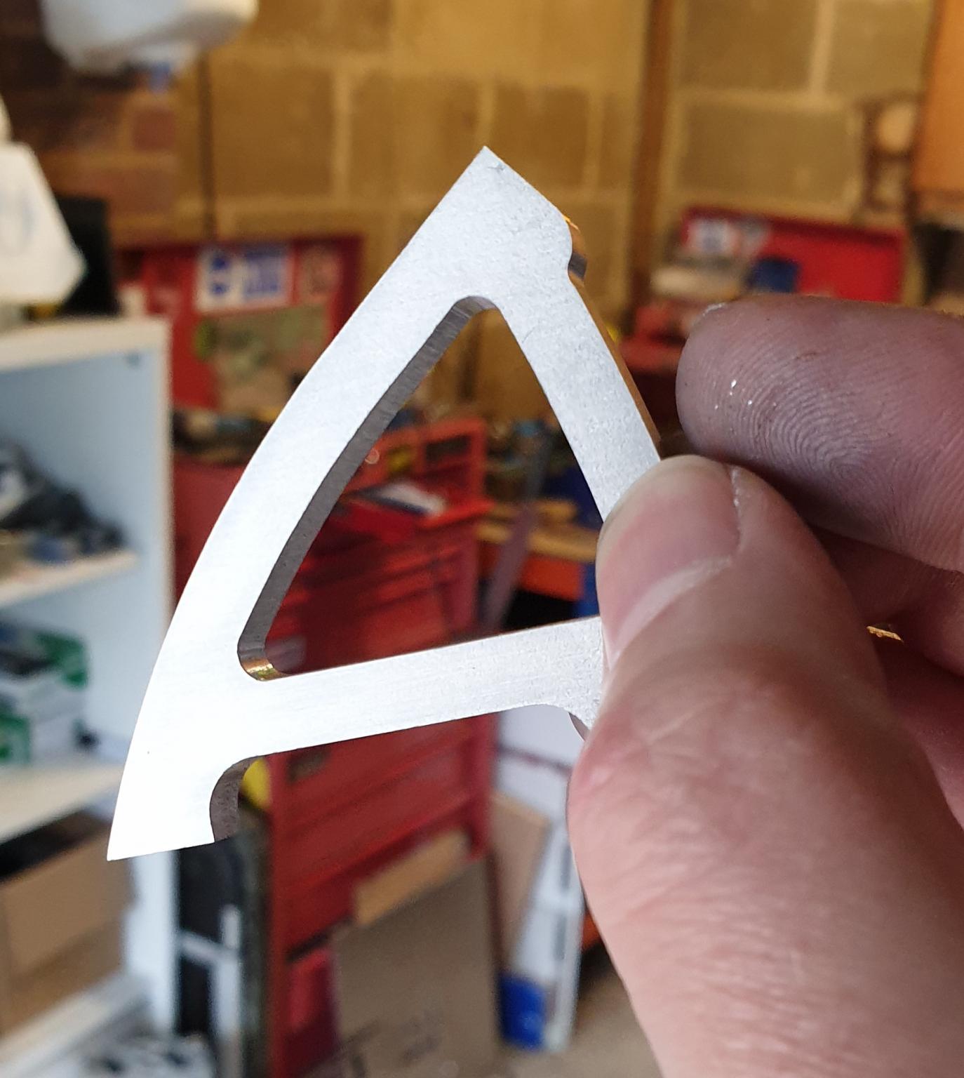

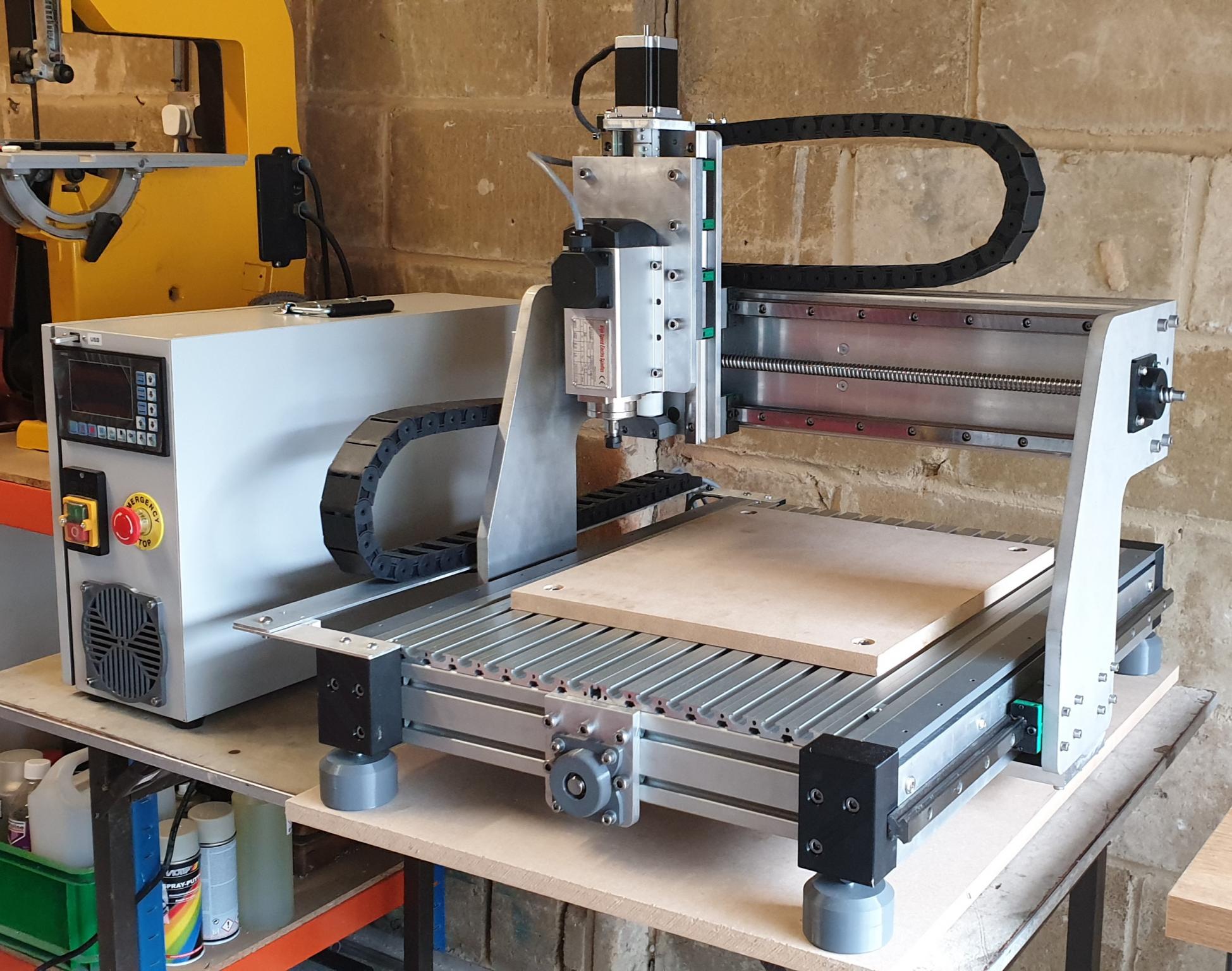

    I just wanted to say a big thank you for everyone's help here especially Jazzcnc for pointing out some purchase choices. I knuckled down and finally finished it a few weeks back, a few days before returning to work. I've not had that much time with it since but so far (apart from some settings issues) I've been super pleased with how its going. I had to think a lot about the controller and eventually settled on the DDCSV2.1 for now. Anyway here is the finished build and pretty much the first cut I made.

    Good job, looks rather quite nice and compact! Will you be putting it in any enclosure or fences around to prevent the material from being thrown all over the place? I have mine in an enclosure with a 24v 100mm fan pumping the airborne dust outside. Not to mention it also is a damn sight better on the ears as the noise is reduced by a good near half of what it would be without an enclosure.

    Quite possibly yes as I was testing some cuts today and I'm pretty my whole street could hear it, not great on a Sunday. Its mainly gonna be used for aluminium and delrin so that tends to just gather around the machine so I'll need to look at extraction close to the spindle at some point. At the moment its my trusty old hoover :)
