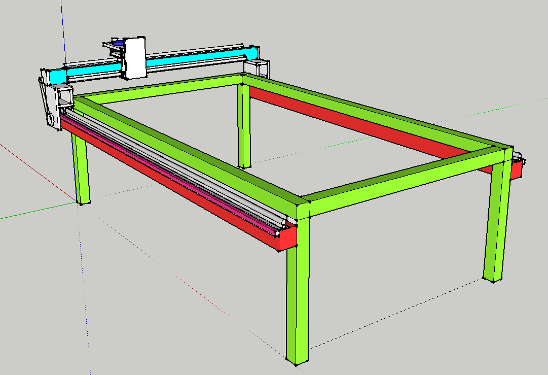

    Afternoon all.
    Planning another build, this time plasma. This time i shall try rack and pinion with single shaft drive. something like this

    As much as this at the moment is the rough plan, as with most things I will make it up as I go along to a certain extent. Would welcome any feedback at this stage though.....
    WHERE DO I BUY RACK AND PINION FROM? Seems expensive at Zapp?

    Have you calculated the inertia of that shaft? At that span is like spinning a ball screw
    What motors? Plasma needs to be fast

    Thanks for replies;
    Boyan: im hoping I wont have to worry about the inertia in the shaft, because, unlike a ballscrew I can place inline shaft support bearings to reduce the whip?
    After shopping around, Zapp doesnt seem overly expensive when taking into account they do free postage at that type of money, and you do get good service and can ask stupid questions.
    My linear rails have arrived (SBR25 for X) SBR20 for Y, and SBR16 for Z (please dont wince, for my application they will be fine)
    im half way through building the frame (il apply pictures of the frame once done)
    Before, I order the Racks, Im hoping to harness some brain power from you guys
    Although this isnt going to be a commercial machine, I hope to make it well enough for it to be used a lot, and on a wide variety of thickness material, in order to achieve this, based on my limited research the maximum cutting speed I think i need to achieve is 6000mm a minute
    Im hoping to get away with stepper motors (only because I have them and some 70v drives), and a old computer with parrelel port
    (but servos and ess are not out of the question) I know how good they are from other machines...
    MOD1 rack seems cheapest, assume I use a 22 tooth pinion, driven from, lets say a 200 input belt off a 100 tooth drive off a stepper motor. so essentially per stepper rev, Im achieving 44mm actual movement
    i shall illustrate this as follows
    a) 22/200/100 = 22 1:2 == 44mm
    b) 22/100/400 = 22 1:4 == 88mm
    assuming I have the servo drives set at 400 pulses per rev, my parrelel port will need to kick out 6000 / 44 = 136 * 400 (54,400) PULSES PER MINUTE which I think is achieveable from a < 1khz parrelel port kernal?
    but im tired, so can somebody shed some light?

    Been cracking on with this, as with most things I do, the design got tweeked from original drawings as I went along. Here is a video summarising where im at, and also details my present predicament. Welcome any feedback you can afford me
  9. #8
    Hi Matt,
    Maybe you could put a limit stop in to prevent the pinion disengaging from the rack and jumping, leaving the spring to keep the rack fully meshed at the end of a travel move.
    Cheers,
    Rob
  10. #9
    Neale's Avatar
    Lives in Plymouth, United Kingdom. Last Activity: 7 Hours Ago Has a total post count of 1,748. Received thanks 299 times, giving thanks to others 11 times.
    Essentially, I think you have a geometry issue here. On the gantry, the arm is positioned and pivoted so that the pinion moves roughly at 90deg to the rack. However, the X pinion arm is pivoted so that the pinion moves almost parallel to the rack. I know that it's not quite parallel, but it's close enough that even with a very strong spring, there is relatively little force acting to keep the pinion engaged. Would it be possible to use a fixed vertical plate going down from the gantry with a pivoted horizontal arm carrying the pinion? I can see that that might give belt tension issues, but that might be an easier problem to fix!
  11. #10
    Split the plate, fix the top one, pivot the bottom, adjust belt sizing accordingly.
