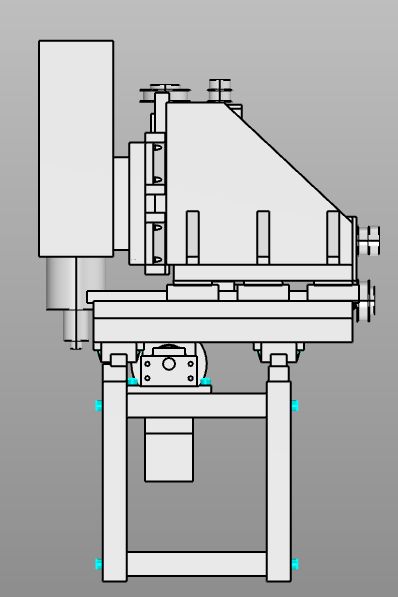

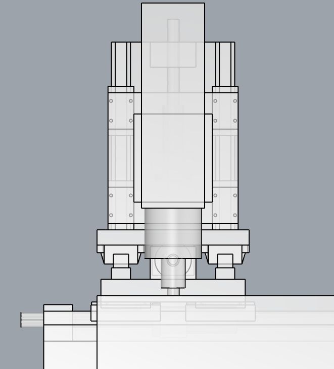

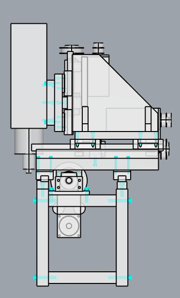

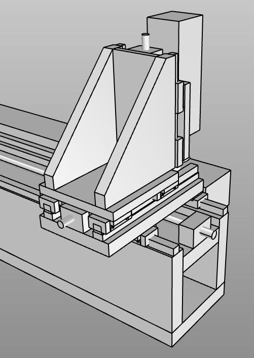

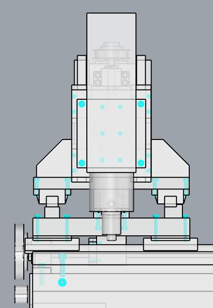

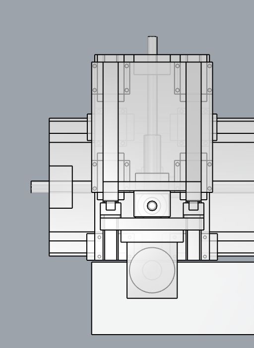

    I'd like to start a discussion about my next diy project, please comment.
    This would be a tool for a single/specific job, with following requirements (based on workpiece size and tools used):
    travel length: 1100x100x50mm
    precision (positioning accuracy,straightness): 0.05mm/300mm C7 ok
    positioning repeatability: at least 0.05mm (minimum backlash)
    working speed: 8mm/min
    acceleration: 3m/s^2 or better
    max cutting forces: 180N (8mm 2fl carbide TiCN DOC=14mm WOC=2mm HSM toolpath S19630 F4466 P=1.38kW CF=17.3kg says FSWizard)
    Since one axis is extremely long compared to the other two, "traveling colum" seems to be best configuration.
    I made an initial sketch to get some idea about size and mases:

    Z axis~16kg
    Z+Column~34kg
    Z+Column+Y~50kg
    Does someone have experience with chinese DFU ballnuts (eg from aliexpress/BST automation)? I was thinking 1605 for YZ and 2010 for X. Would they be stiff enough?
    I'd like to use double ballnuts on ballscrews to eliminate as much backlash as possible (quality BK/BF supports too).
    I have older chinese single nut rolled 2010 "C5" ballscrew with correct length but it has some backlash under load, so I thought that double nut variant would be better, sacificing somewhat the ease of motion.
    Another option is to use used/nib/nnb brand name preloaded/double-nut ballscrews, but that would complicate things since I would have to work with what's available at the moment (sizes,lengths), and prices are higher even for the used stuff.
    Thanks for looking.

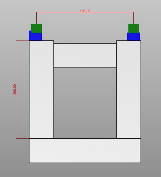

    I've sketched a solution for X axis base. Tubular structure would be made from a 50mm thick granite slabs, glued and fastened together with screws. Steel rail supports would be fastened on top with screws and epoxy, and then shaped and ground to create plane for mounting rails. Would a rail span of ~200mm be enough (I see that span used on gantry machines)?

    Quote Originally Posted by mbele View Post
    I've checked preloaded brand name ballscrews on ebay, and found few solutions for Y and Z. I have to select ballscrew for the min possible diameter (inertia) and required stiffness.
    Considering 180N load and 0.05mm allowed error, can I assume that total stiffness of the machine at the tool tip should be no less than: 180N/0.05mm=3.6N/um? Would then a 12mm dia ballscew with rigidity(K)=120N/um be enough?
Name:	50mm granite slabs w steel supports rail span 198mm.jpg
    Hi mbele,
    This is gonna be an intresting build if your total allowed error is <0.05mm @ 180N
    What servos can run at 180n at operating speed. Did you check the stepper calculator on this site?
    Also please check what happens with 180n force in all directions at the tool tip on all (moving) parts combined.
    One does realise quite quickly that everything looks like made of rubber.
    Grtz Bert.

    Can someone comment on base structure and x/y configuration? I have option to make base out of 30mm or 50mm thick granite slabs. I used gantry stiffness calculator I found here to get rough numbers, and it seems that 30mm would work... I don't know how to upload modified excel file, so here are the params I used:
    Length=1500, material 5.00E+04 / 2.7E-06 / 24000
    Z load=500 simply supported
    X load distance=150mm, 200N
    Box section, width=250 height=230 thickness=30
    (Young's mod for granite is 10-70GPa, I used 50)
    It showed 4um deflection due to 50kg load, and 0.25um tool deflection in torsion. Actual base length will be shorter, depending on the x axis block span, so I expect better results for deflection.

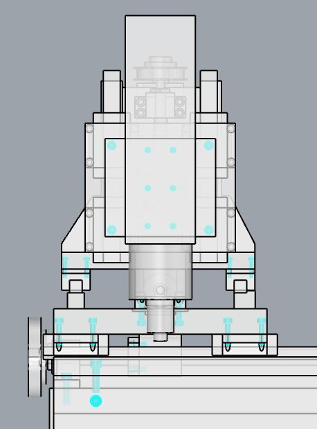

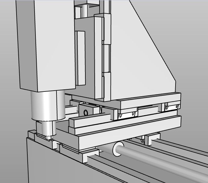

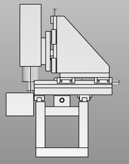

    I think I figured YZ axis arrangement. Options:
Name:	27-4 y20z15 fixed Y nut.jpg
ID:	27612Click image for larger version.

    and
Name:	27-5 y15z20xLGW fixed Y nut.jpg
ID:	27614Click image for larger version.
Name:	27-5 y15z20xLGW fixed Y nut front .jpg
    Column would be made of aluminium, y bed 30mm thick, sides and Z bed 20mm, Z ballscrew support and supporting triangles 15mm. Rals for X would be Hiwin QHH20 or LGW20, for other two axis I can use SHS15R or LGW20 (that's what I have available).
    Base structure looks flimsy compared to the rest of the machine, so I'm thinking of using 50mm thick granite slabs...

    Hah, back to the drawing board...
    1. Z axis travel is too short, I use following calculation:
    (max tool stickout - min tool stickout) + max stock height + clamping height + safety
    minimum: (35-10) + 25 + 10 + 5 = 65mm
    2. To implement apron type chip guard, I need to extend Z axis overhang, and since arrangement was optimised to make tooltip as close as possible to the linear components, arrangement does not make sense any more - Y overhang needs to be extended for 60mm and axis travel is only 100mm
    3. rigidity of X axis ballscrew shaft is 7x less than Z axis ballscrew, so there's no point in beefing up Y and Z if the percentage of their impact on the whole system rigidity is small. X axis rigidity can be improved by increasing shaft dia, but that raises inertia, so 2.7Nm/840gcm^2 stepper would work better than 400W/360gcm^2 AC servo, but that puts me in the no-feedback scenario, so there's no point in using servos on other axes...
