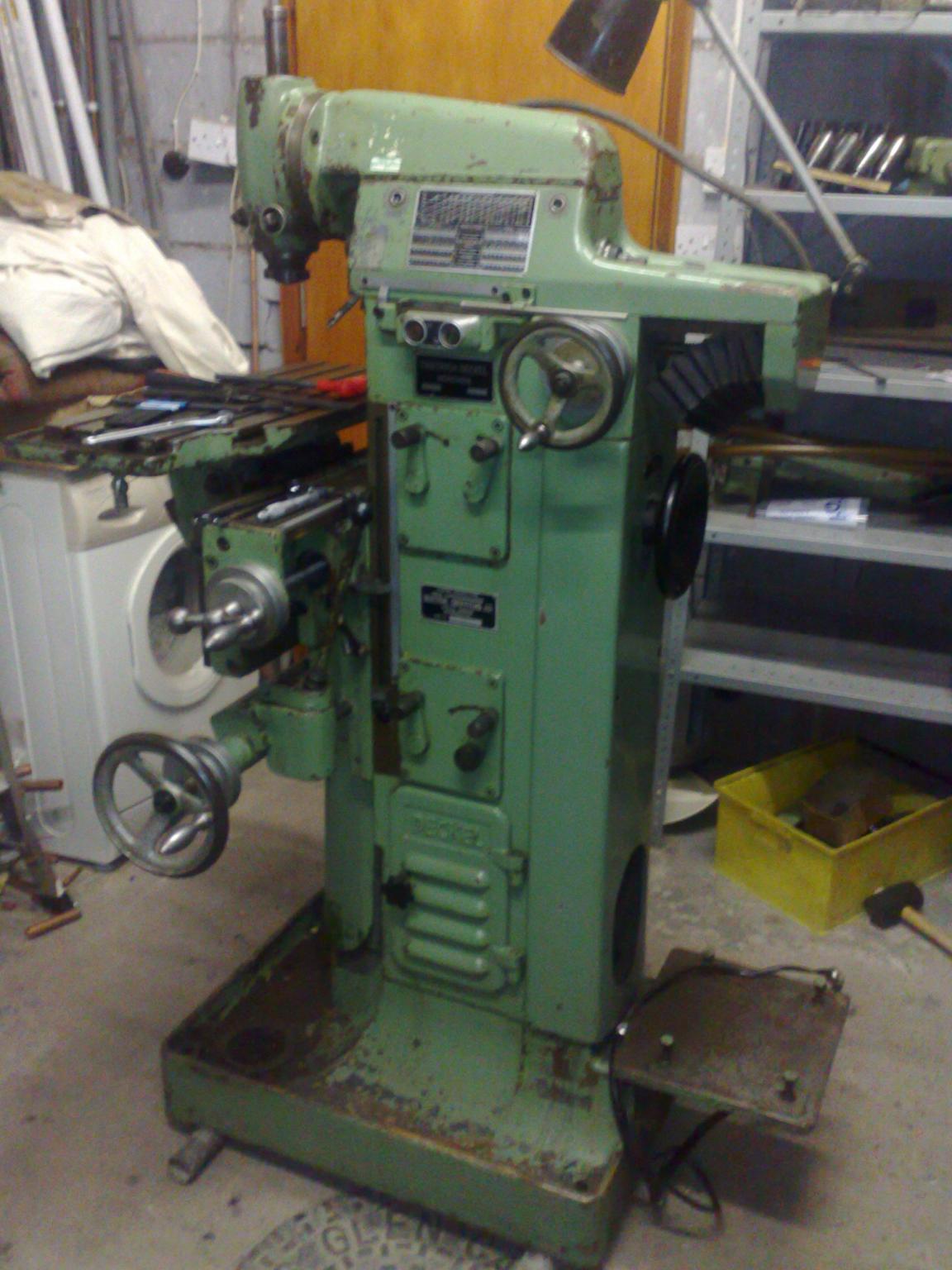

    Have had an old Deckel FP 1 mill in my shop for years and it still does good work. (Pics attached ) but I have been tempted for some time to use it as the base for a CNC conversion
    Rather than interfere with a classic, I have planted an Axminster compound table onto it https://www.axminstertools.com/axmin...d-table-400385 and converted that table with stepper motors and Chinese ballscrews.
    I built my panel and with all sorts of problems along the way. I then downloaded a licensed version of Mach 3 and with a few more problems managed to get the table moving in X Y plane. That is a very abridged version of what went on, but with a simple routine I managed to cut a pocket.
    Clearly I needed a Z axis ( not easy on a Deckel where the usual Z motion lifts the whole table)
    The quill has very little backlash, so I have added a Heath Robinson drive to give me the Z motion and it all seems to work fine
    https://www.youtube.com/watch?v=lpDV7Lj5mTY
    Sooooohh, I know this is a rough project, but If I can get an understanding of the processes then I will move to building something a little more refined .
    So I now want to make the machine loop through the same repeated routine to a given depth.
    I am told that IF and GOTO instructions are not supported by Mach3 and if I try to use a parameter to define the depth , increased at the start of a subroutine I get a vague error message which tells me it does not understand the word .
    How would others program this to cut progressively down to say a depth of 6mm

    Heath Robinson?, hey it works. Actually the ball-screw adaptation of the XY table would be an interesting write-up for anyone here looking to produce a CNC mill on the cheap.
    I guess you're manually writing the G-Code?, many/most here will use a CAM processor (e.g. CAMBam on PC) to generate the tool paths, including the decreasing Z depth, and the output from the CAM processor will be the G-Code to feed into mach3,or similar. I'd be going this route, personally.
    To answer your question - I've never tried this with Mach3 (though have done similar with LinuxCNC), you *could* (many ways to skin a cat), use a subroutine to perform your pocket operation at a single depth, and use a loop and G-Code incremental mode to create the increasing depth.
    Something like (and this will be full of errors - so use it to understand the concept, not to test, -- prefix = my comments, not valid G-Code) It's nasty, it's probably naughty but it might give you ideas. But see (a) above - look at CAM processing instead! Again, don't run this at all!!
    O0001
    G90 -- Absolute mode
    G0 X0Y0Z10 -- Move to 0,0,10mm
    M98 P02 L60 -- 60 Loops, (60 x 0.1z = 6mm) ... Z will start at 10mm and ultimately drop to 4mm safe clearance height.
    M30 -- program end
    O0002 -- subroutine to perform one pass on the pocket
    G0 X0Y0 -- reset to X=0,Y=0 - if your G-Code returns the spindle to the start position of the pocket then you don't need this, but you must be positioned to XY that's safe to plunge into the work piece
    G91 -- incremental mode
    G1 Z-10 F100 -- plunge down 10mm
    G90 -- absolute mode
    -- << do your pocket stuff here... NO Z movements!!!! >>
    G1 Z9.9 -- retract 9.9mm, the difference between this and 10mm is your plunge depth, here, 0.1mm
    M99 -- return from subroutine
