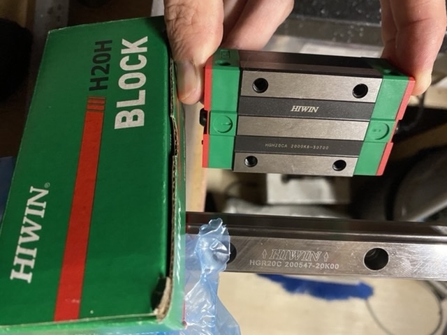

    Based on your recommendations, I ordered the rails and carriages from Fred at BST - excellent communication, great pricing and quick turnaround. Time from payment to delivery was 8 days (paid Sunday evening, received Tuesday the following week).

    I'm going to test bolt things together this weekend to measure up various bits and pieces and see how she slides. I'm going to get someone local to machine a few bits of aluminium for the extra bracing on the gantry. Do you guys lubricate the carriages before putting them into operation? They feel like they're a little 'dry' out of the box, but not sure if that's the ZA preload I'm feeling?
    Grease them when your ready to use the machine, there is enough grease inside them for setup etc but not enough for running.
    The stiff and notchy feel is quite normal, when greased and in use under weight they run smooth.
    Thanks for the confirmation!

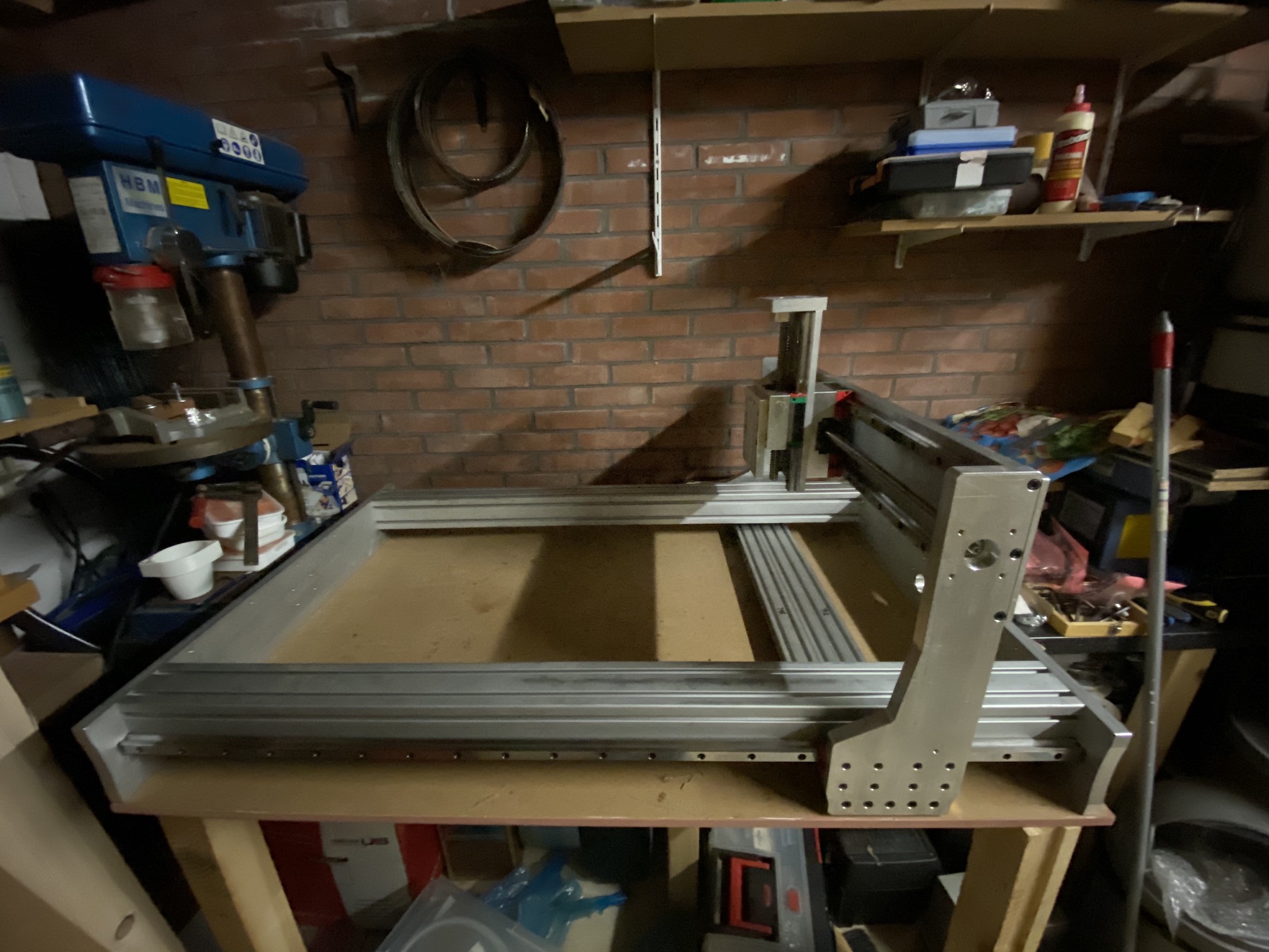

    Looks like 2020 and dual screws are in my future! Will shoot Fred a message to ask about pricing on a couple of ball screws with bearings, which I'll mount inside the base up against the 8080 profile. And try to find someone local who can help me machine the frame end pieces to fit the two new ballscrews and add mounts for a pulley system with the motors inside the base, which should save a fair amount of room. I'm also having a bit of a sketch to see if I can mount the Y axis motor so its on the T extrusion I'll add to the back of the gantry to stiffen up the top. Although that will probably be a more long term plan since it would probably require replacing the screw - I don't think the end extends past the side enough to mount a belt pulley...
    I think one of the biggest potential areas where there's a risk of loss of precision is the X axis (longest rails, 1200mm) which are mounted to unmachined extrusion. The base face plates have two accurately machined notches that the rail ends rest in, however, so I figure I'll use those as reference points for vertical and horizontal alignment at the two ends. The Y and Z plates are flat and have machined surfaces and edges the rails can mount to, so that's much less of a concern/challenge for now.
    Also, anyone have a tip on what timing belts and pulleys are appropriate for this kind of build? Or a good source of basic info on the upsides and downsides of various systems (eg T5, T10, AT5, AT10, HTD??). Even just some photos of a 2:1 geared drive system on a DIY machine would be helpful...

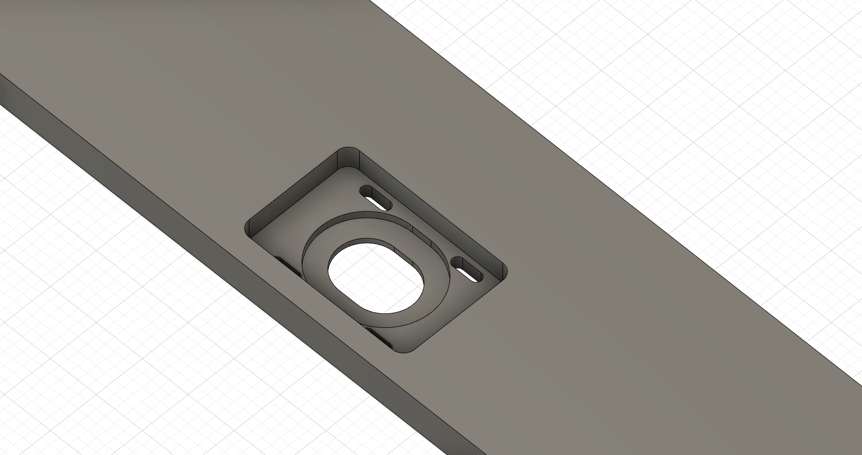

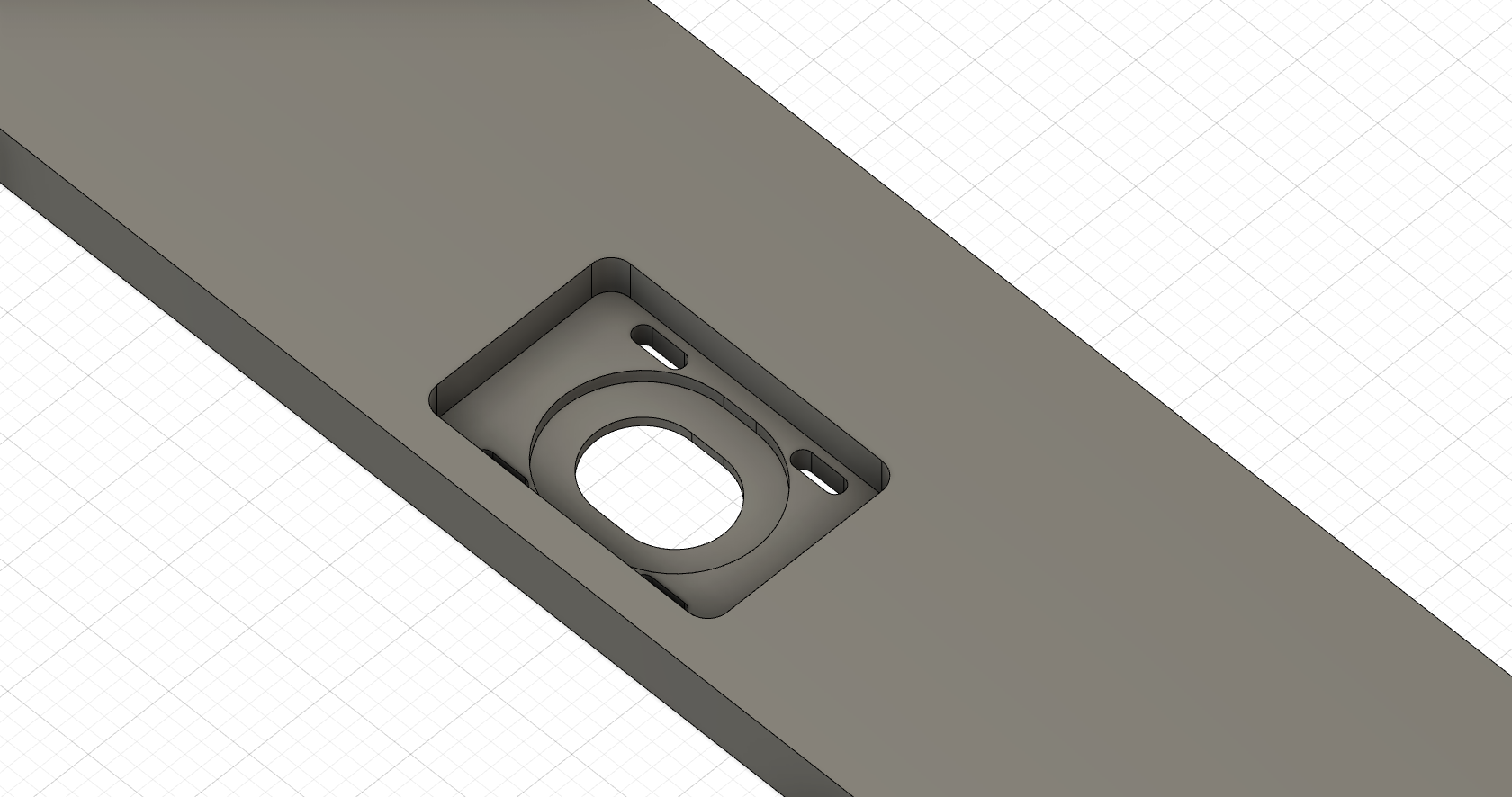

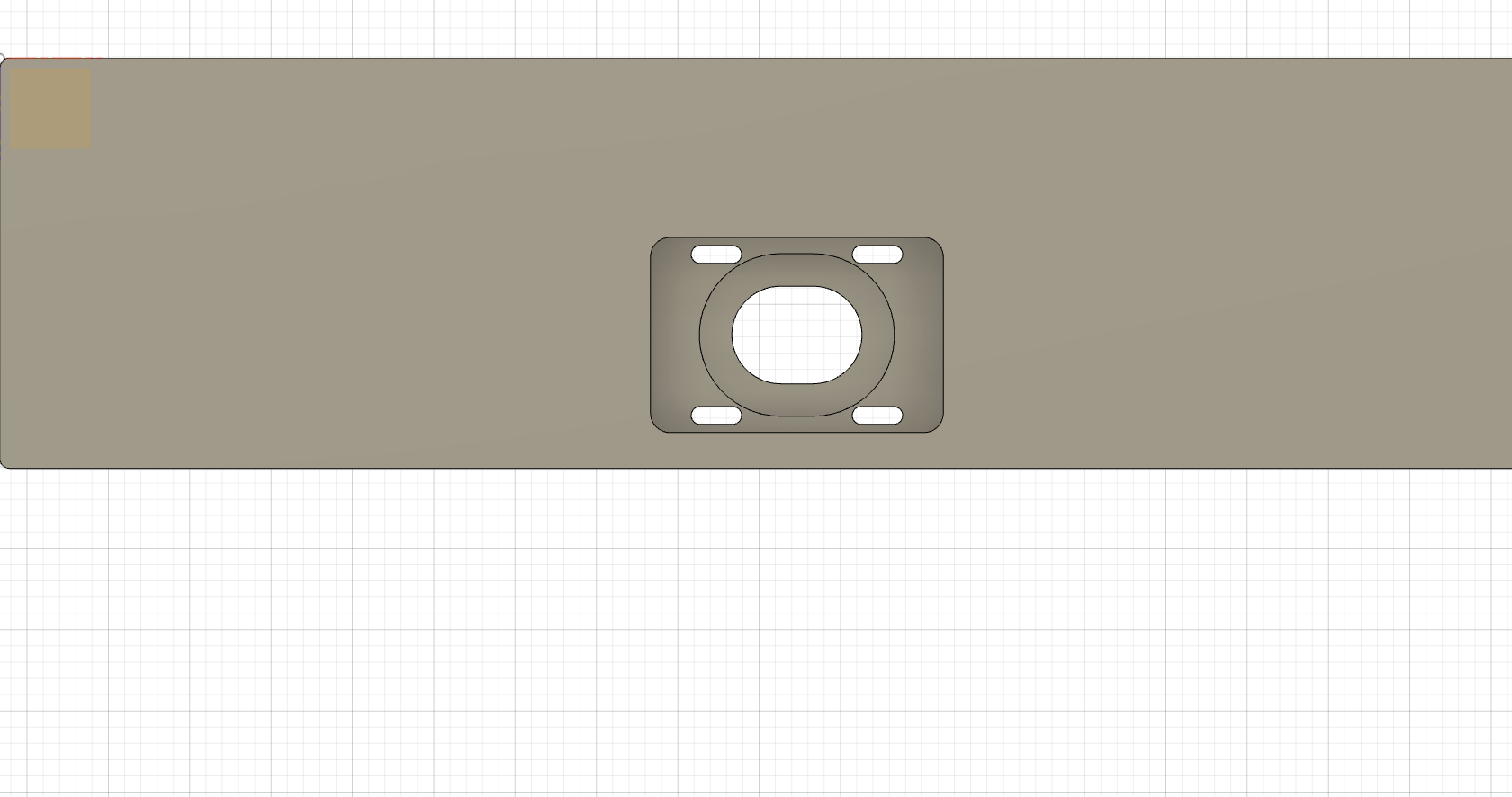

    Thanks all! I've dry-assembled the Z axis, didn't get around to the other two just yet. Looking and feeling good so far. I've been dabbling with Fusion360 (not quite 'got' it yet, but working on it) trying to come up with a design for mounting a pair of 200w servos for the x axis (on the assumption that two 400w servos for a gantry this size would be rather overkill).
    What I'm considering is mounting two 2020 ball screws inside the frame alongside the extrusion, face mounted to the end frame pieces using FK/FF mounts, having the lock nut on the fixed end recessed into the frame. Then mount a 40 tooth HTD5 pulley on the ballscrew. The idea is to find someone who can machine the end frame for a recessed 60mm motor mount with elongated bolt holes to allow for tensioning the 20 tooth pulley on the motor.

    The way I've sketched it now leaves 7mm thickness for the motor bolts, with a 3.5mm recess for the round flange surrounding the motor's shaft. I'm guessing I should oversize the slots and recesses somewhat since it doesn't need to press fit in place and I'm not sure how tight the tolerances on the average 60mm frame motor are (0.5mm per side, or total? Suggestions welcome). Will this leave enough meat for the motor? Would 5mm be enough as well? How long would you leave the slots for belt tensioning? I've gone with 6mm slots for M5 bolts that are 16mm long. Too much? I'm a little concerned about the clearance at the edge of the hole to the recess for the plate around the shaft. Also need to work out exact positioning for this so the belt preferably does not run across the bolt caps, though an offset mount would mean less leeway in terms of taking up belt slack. Comments on this plan welcome. I'm also wondering whether to start a separate build thread or just keep all the questions here - I'm finding the dialogue very helpful in making decisions!

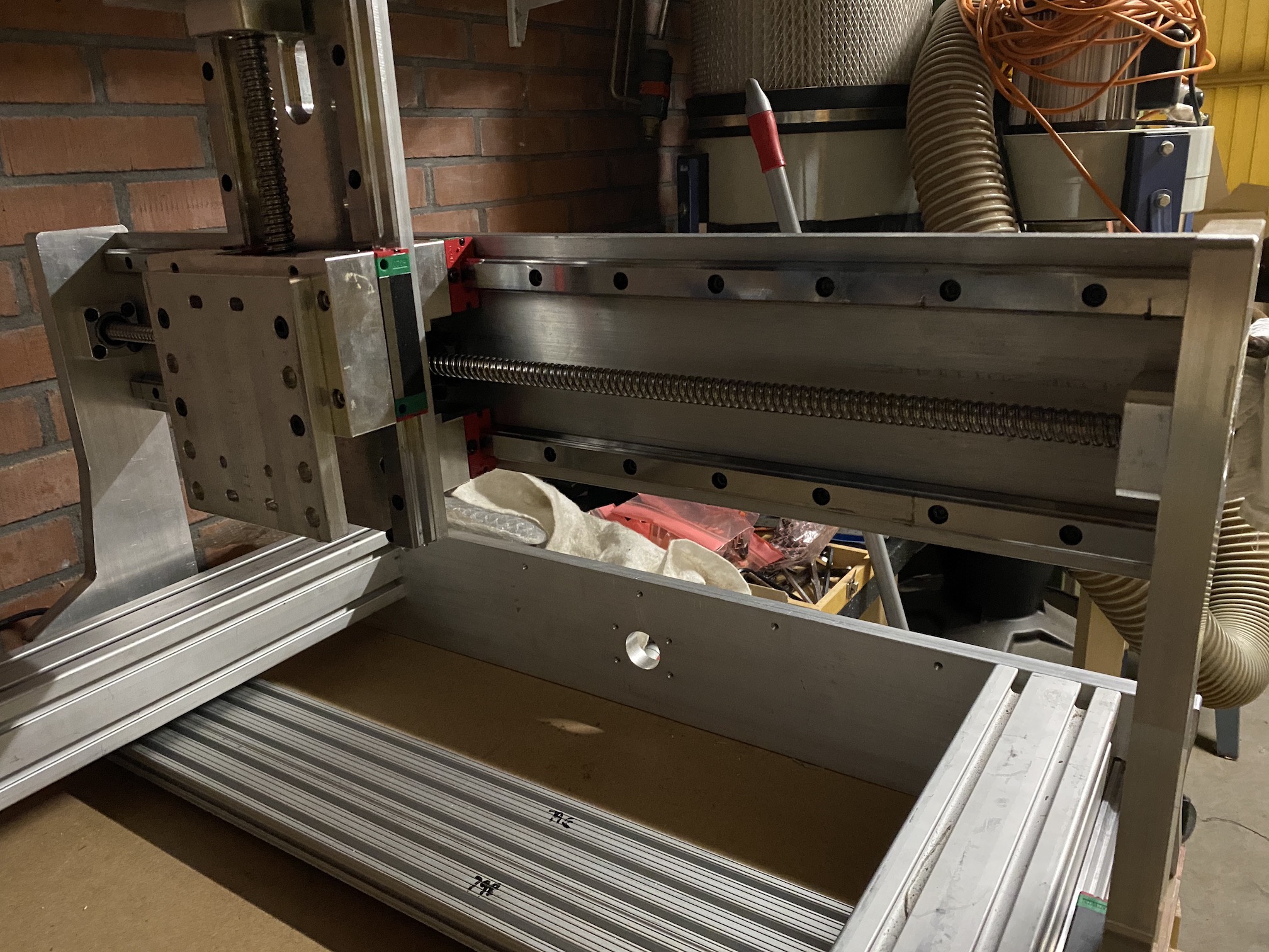

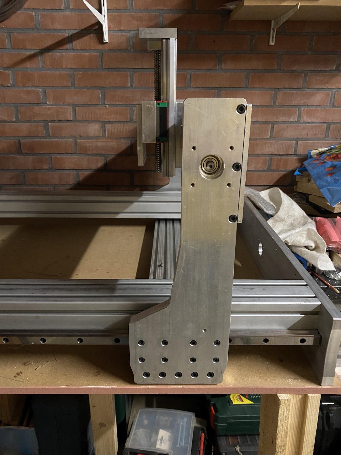

    So I've dry-assembled the gantry (all the mechanical bits except for the currently missing X axis ballscrew(s)). I was hoping I might be able to convert at least the Y axis to 2:1 belt drive as well (placing the motor on a bracket on the to-be-built gantry brace) but the ballscrews I have feature some pretty non-standard machining. Both ends are simply turned down with a retaining C-clip in a groove on the floating end, which is a nice snug fit in the holder; the fixed end is apparently only 'locked' in place by the flexible coupling, no retaining nut of any kind. Since the coupling can't fit through the machined holes as is (the bolt stick out just a little, need to file a small corner into the frame so it can pass), the Y axis is particular simply slips back and forth. The fixed ends do have a tapped hole in the end. Not very reassuring in terms of being able to adjust for backlash.

    Thoughts? I guess this works well enough considering there are quite a few of these machines floating around out there, but it isn't super reassuring. I'll use 'standard' FK/FF machining and supports for the X-axis. But I may request a quote for a new Y axis ballscrew at least.
