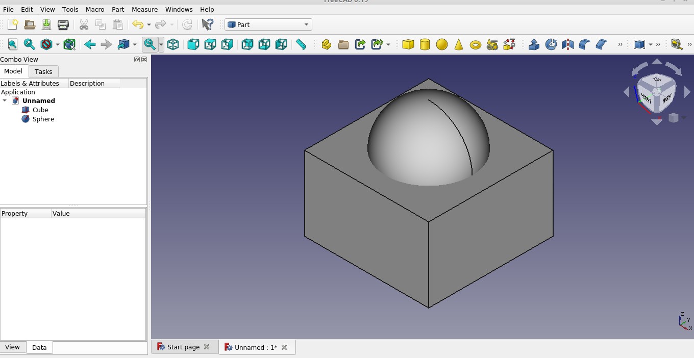

    Freecad -Part workbench,create sphere from primitives.Create cube the same way,move the sphere so that its centre lies on the upper surface of the cube.Merge the parts and export as an stl.Import the stl into Vcarve and generate the toolpaths.You have the tools necessary to carry out the operation,all you have to do is use them.

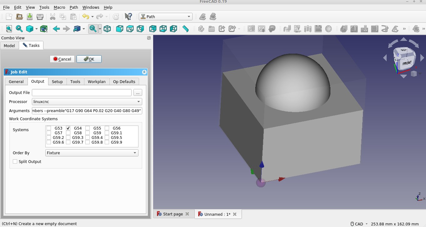

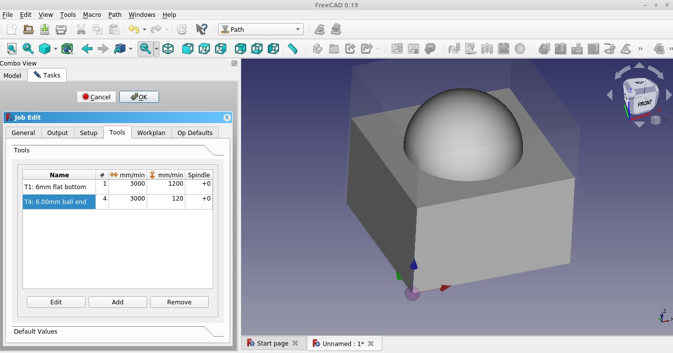

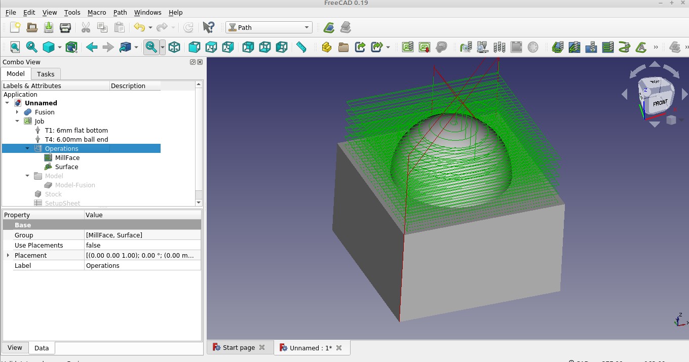

    In short,you need to select the body then click on the icon that creates a path job object.It helps if in preferences you select job preferences and set them accordingly.You will have to create the tools you intend to use and create a controller for each of them.Select the machining strategy you intend to use and select the surfaces,set the parameters to suit and then the toolpath should appear.

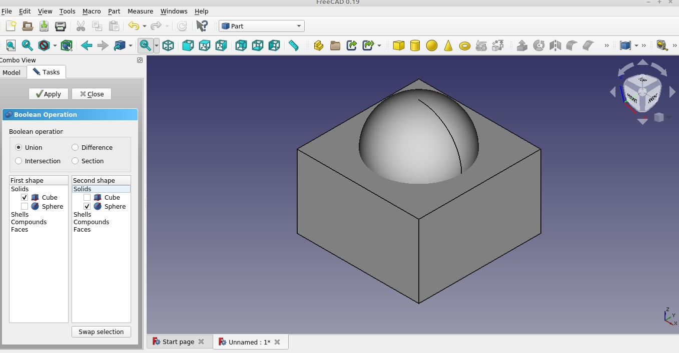

  7. #6
    I suspect the problem with Vcarve was that two objects were introduced and had a Boolean union taken place it might have worked.I did a rough and ready test to prove it can be done.First a sphere embedded in a cube.Then the Boolean dialogue.Switch to Path workbench and set the relevant preferences.Create tool controllers.Select parameters to suit your machine-these are just examples.Pick the operations you intend to carry out and work through the parameters-it may take more than one go to get them accepted and yu may want to play with boundaries.You should see a display showing the result and it renders much faster in wireframe mode.Reducing the accuracy of the simulation is a good idea because it can take a very long time.Click image for larger version.
