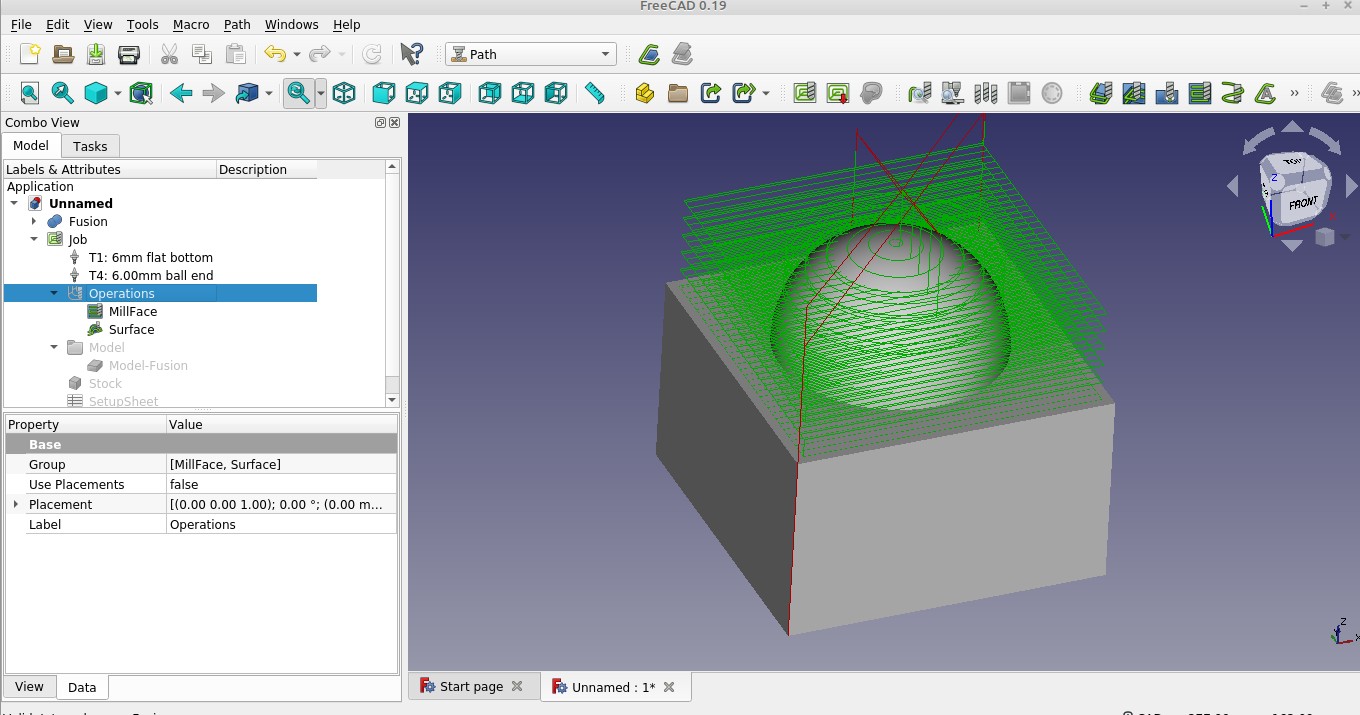

    Hello to All.
    Here is one for all you Code Masters. I would like to machine a half sphere form on my CNC Router ether by Parameter programming or by G Code, which has to run on Mach 3. After some deep thinking I wheeled out VCarve Pro to see if I could use this. Playing about with the spiral gadget and fluting I ended up with a cone shape which was radiuses over the top. Try something else. I downloaded FreeCad as you can do your model and get the program to write the code for you. Well to say that FreeCad has a steep learning curve is a bit of a under statement, so this way will require a lot more effort on my part.
    I came across a program which will dish out a hollow sphere, which I have had working on Mach 3.

    But I wold like to form the dome rather than a dish. And the maths in this program is way beyond me. In the above program I like the idea of been able to change the diameter of the dish.
    So anyone have any ideas.
    Freecad -Part workbench,create sphere from primitives.Create cube the same way,move the sphere so that its centre lies on the upper surface of the cube.Merge the parts and export as an stl.Import the stl into Vcarve and generate the toolpaths.You have the tools necessary to carry out the operation,all you have to do is use them.

    Have done the model with the primitives, but VCarve dos not like the stl file FreeCad made. So back to the drawing board. Now trying to get FreeCad to do the toolpaths and write the code, could do with a walk through with this opp.
    Lots of help on the dedicated forum https://forum.freecadweb.org/viewfor...c1c8839193ee32 . This topic in particular will be of interest https://forum.freecadweb.org/viewtopic.php?f=15&t=25595 .
    In short,you need to select the body then click on the icon that creates a path job object.It helps if in preferences you select job preferences and set them accordingly.You will have to create the tools you intend to use and create a controller for each of them.Select the machining strategy you intend to use and select the surfaces,set the parameters to suit and then the toolpath should appear.

    I suspect the problem with Vcarve was that two objects were introduced and had a Boolean union taken place it might have worked.I did a rough and ready test to prove it can be done.First a sphere embedded in a cube.Then the Boolean dialogue.Switch to Path workbench and set the relevant preferences.Create tool controllers.Select parameters to suit your machine-these are just examples.Pick the operations you intend to carry out and work through the parameters-it may take more than one go to get them accepted and yu may want to play with boundaries.You should see a display showing the result and it renders much faster in wireframe mode.Reducing the accuracy of the simulation is a good idea because it can take a very long time.Click image for larger version.
