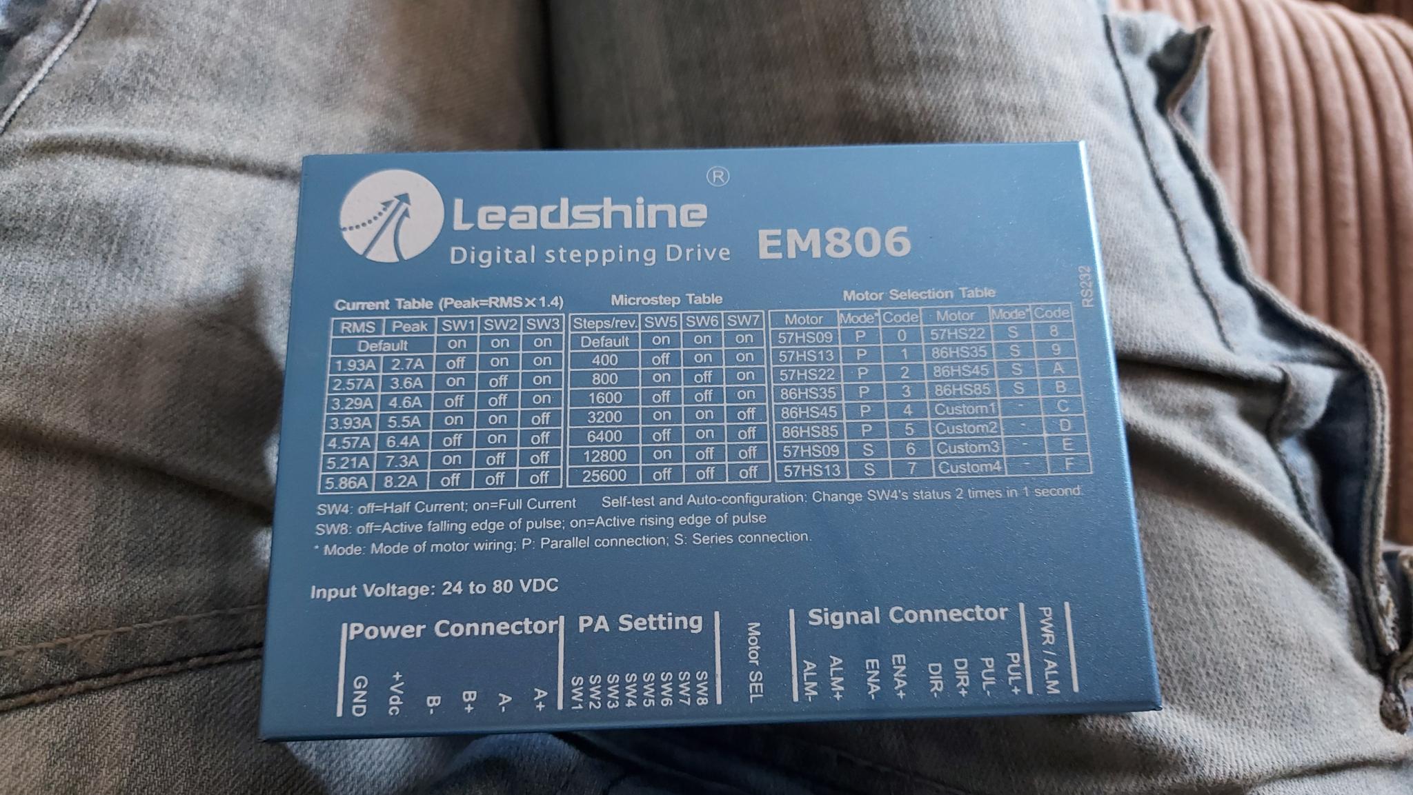

    just powered up my router after a few months and i am getting an overvoltage alarm on one of the three drives. I have checked the wiring and all seems secure and un broken. The voltage measures as 73v dc. i have spoken to Gary at zapp automation and he said it could be broken or damp. I have taken the cover off and none of the components seem blown. Does anyone repair these drivers, or can anyone suggest what to test on them? i have taken it inside to warm it up just incase its a damp problem. Thanks all
ID:	28512 Not sure where the 72 volts came from. But here is a pic of the front of the driver where it is clearly 80v. I note that ot says in your document that it is recommended voltage so maybe that's it.

    I happened to be looking at the manual for the EM806 a couple of days ago. I think it said the the max voltage rating was indeed 80V (hence the name, from 80V and 6A) but although the internal mosfets were nominally rated higher than this, the recommendation was to keep the supply rail to 10% lower to allow for back emf, spikes on the supply, etc. Hence recommended 72V.
