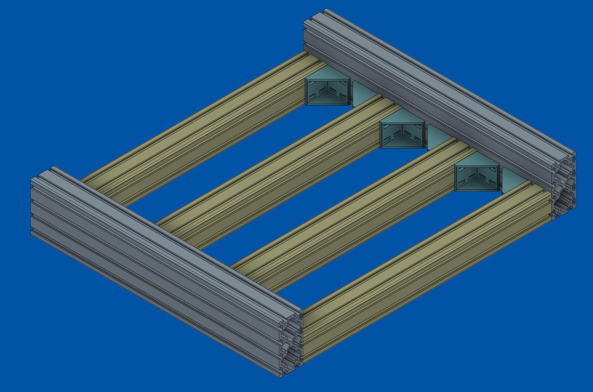

    Frame

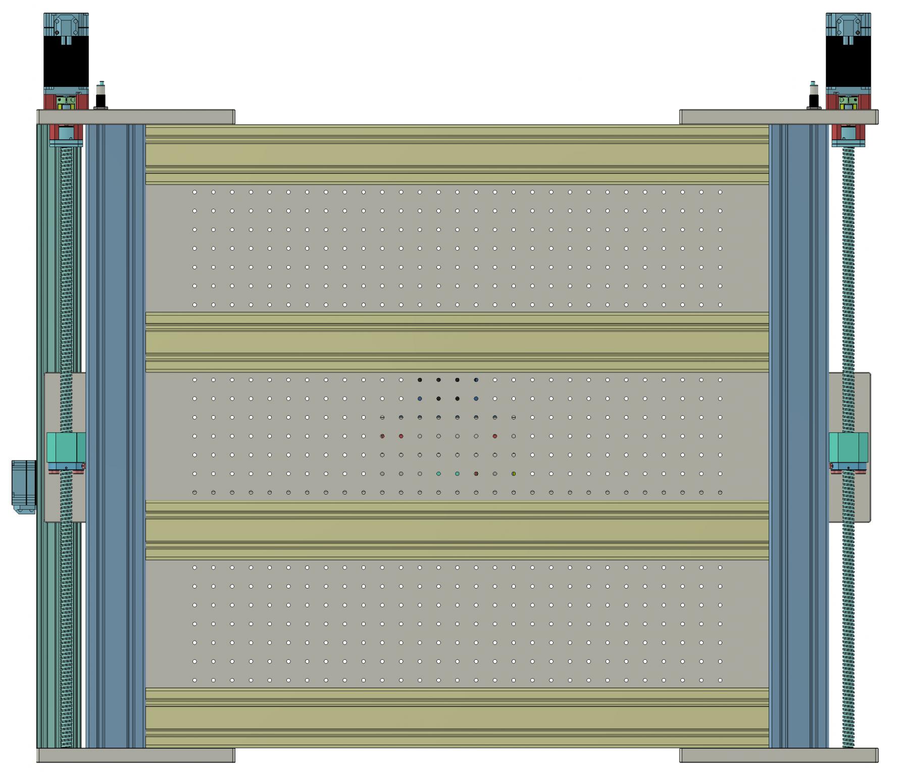

    For the frame, I plan to use 80x80 and 80x160 profile. Please see the attached image for the frame.
    Questions:
    1. Are 4 cross-members on the X-axis too many - would 3 suffice?
    2. Are corner brackets and the connection with t-nuts sturdy enough to give a rigid frame? Or should I tap the ends and drill M8 holes and fasten them from the outside of the Y beams?
    3. Should I use the heavyweight or lightweight profile? (from KJN)

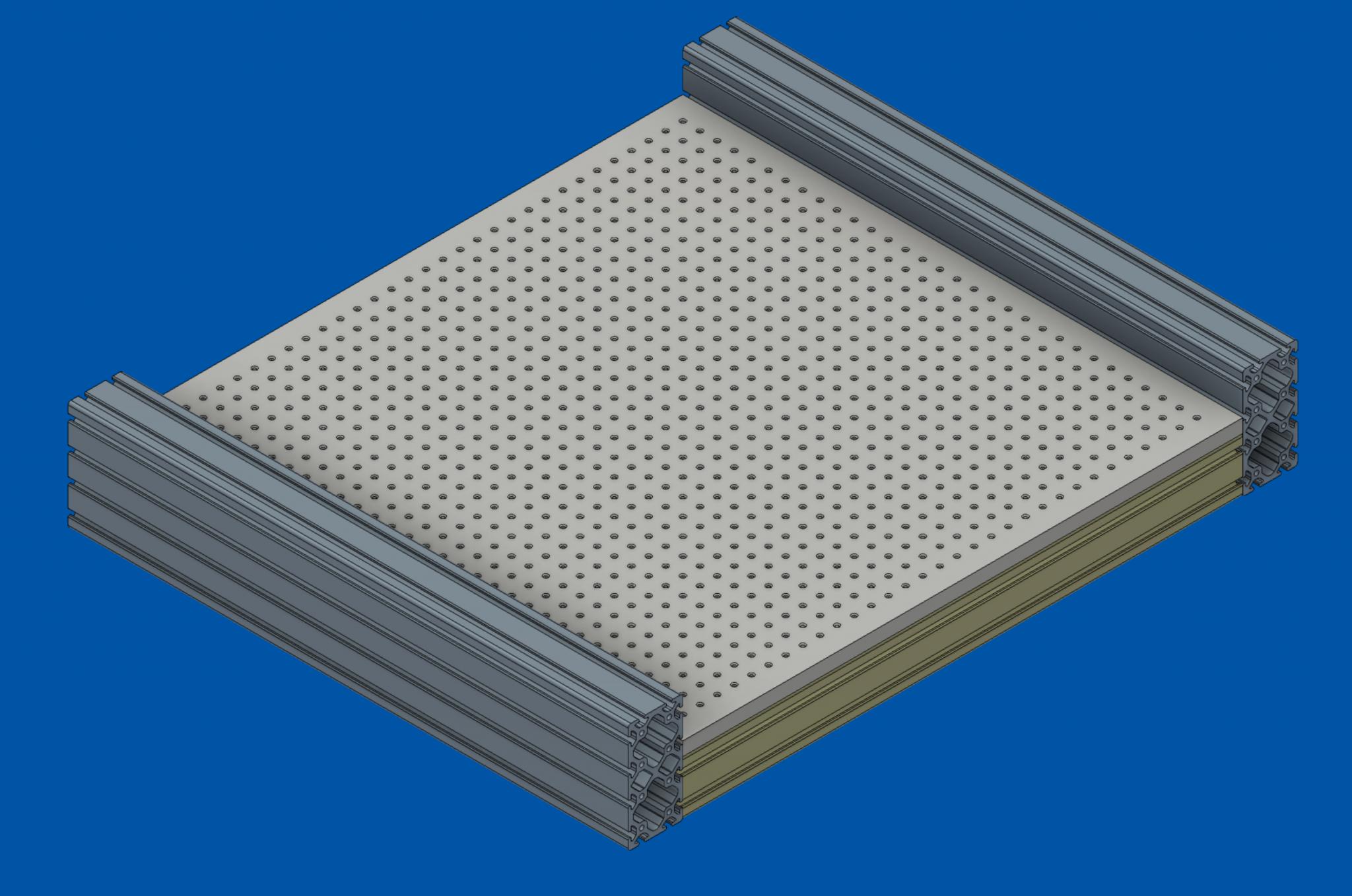

    Fixture Plate
    For the fixture plate, I plan to use 20mm aluminium drilled and tapped for M8. The plate will fix to the profile, and I will fit a 10mm - 20mm spoiler material to the top
    Questions:
    1. What grade aluminium would be best?

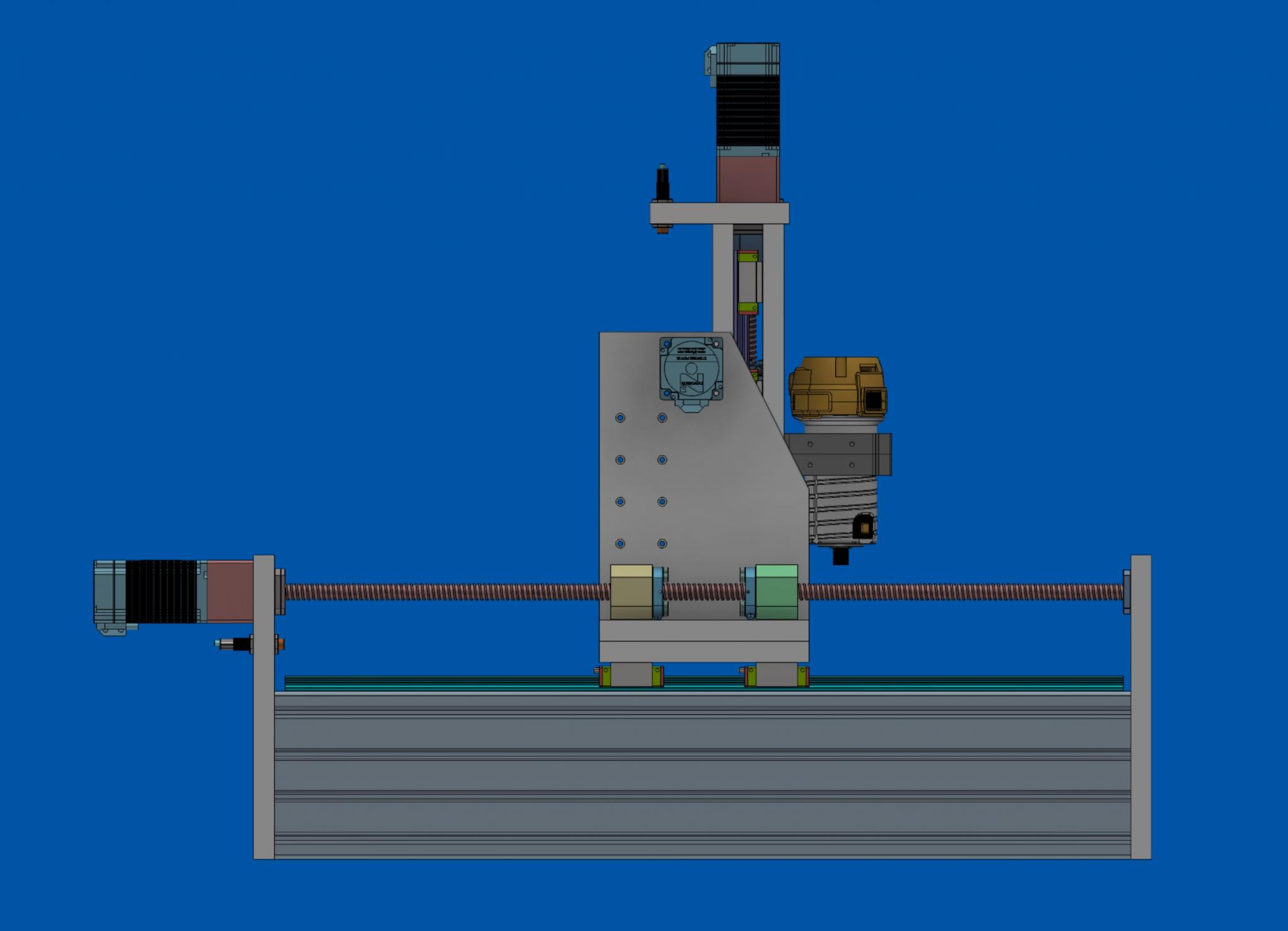

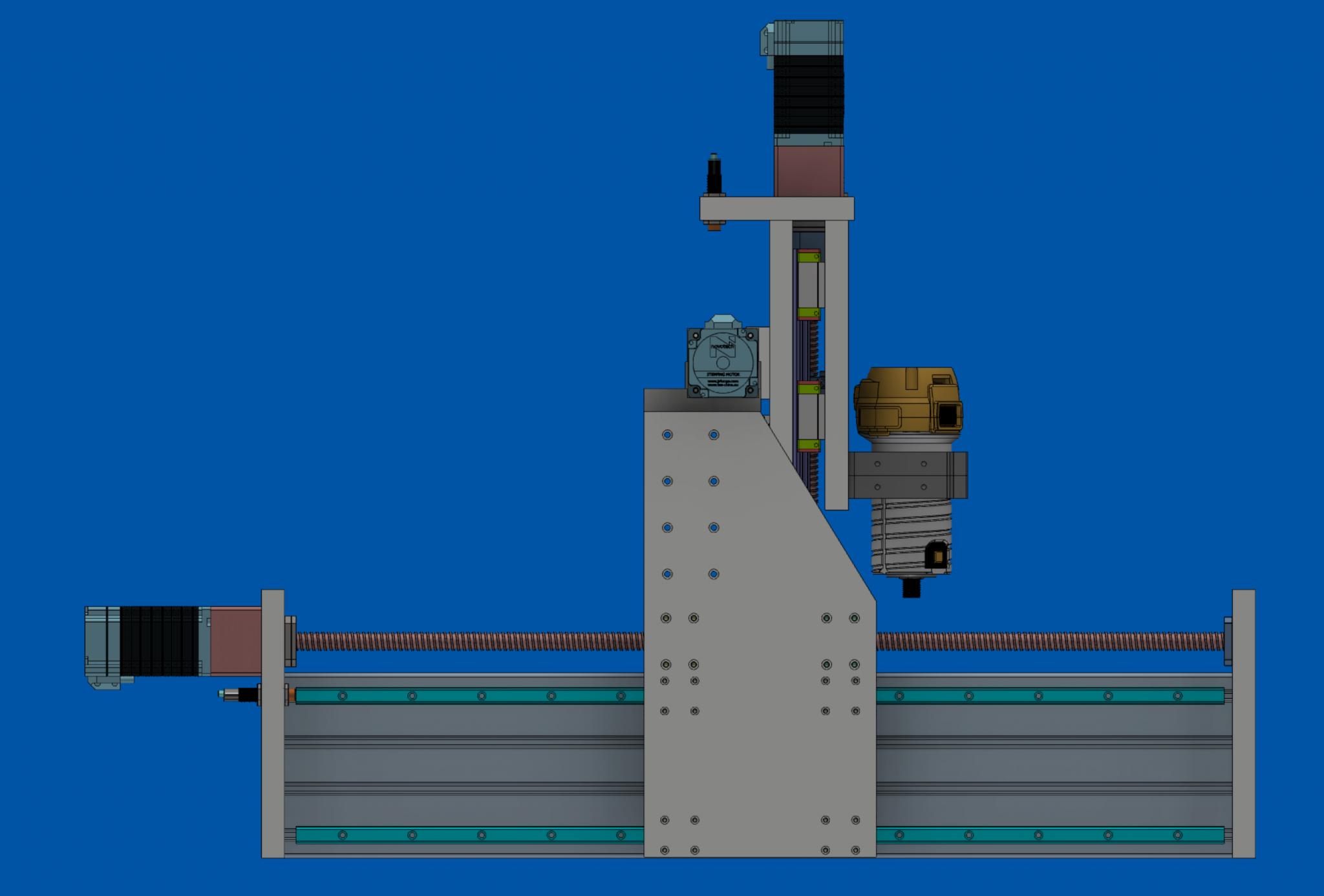

    Gantry design

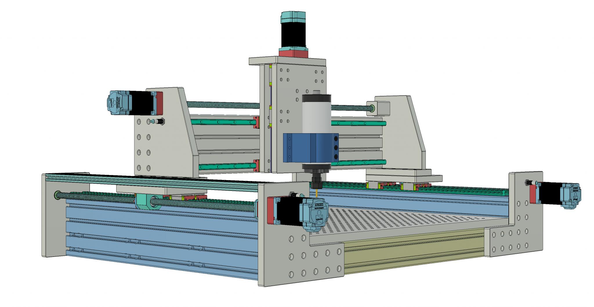

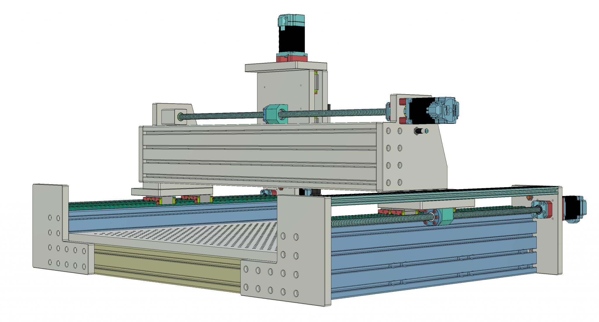

    I've looked at different gantry designs and have looked at two different styles: Option 1 with the rails on top of the profile and Option 2 with the rails on the side of the profile. It is hard for me to gauge the difference between the two designs and which will be best or be "better" in the long run, and I will appreciate people's views on this. I attach images of the two designs that I have done. On both designs, the Y and X plates are all 200mm wide, and the Z plate is 180mm wide.
    Option 1: Rails on top of the profile
    Option 2: Rails on the side of the profile

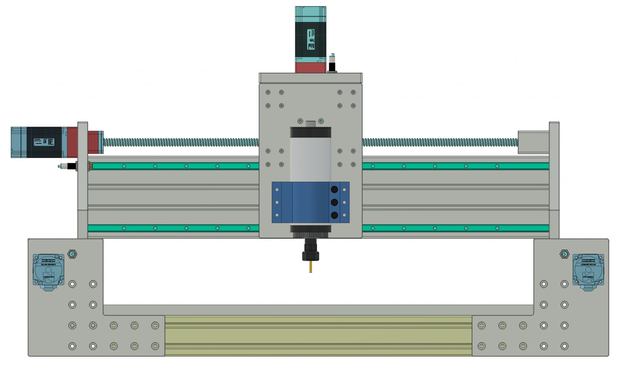

    The router is set forward quite a bit and extend 40mm forward of the front face of the gantry plates. I've considered setting the X beam back by 40mm to offset the overhang but I will then have more issues with the gantry plate then interfering with the back motor plate. I know an alternative is to place the rails on the top/bottom of the X-beam which will reduce the overhang but I initially steered away from this it then involves more plates and a more complicated design (I may still have to do this).

    Budget seems achievable. I don't envy you having this in your office; even with a watercooled spindle rather than a router don't expect to get much other work done without wearing ear protection. An enclosure will help... but...
    The inherited components are never a good sign to be honest with you. They tend tie one hand around your back before you start. You've said you're cutting plastics primarily which tend to want higher feed rates, so 5mm pitch screws might not be ideal as they dictate your speeds somewhat. You may find you'll have to introduce some gearing to get the speeds you want. Having said that plenty of people on here build with 5mm pitch direct drive and it works for them.
    I'd go with the beefyer profile every time. More rigidity, less vibrations.
    As you've mentioned, the 'best' would be ground tooling plate.

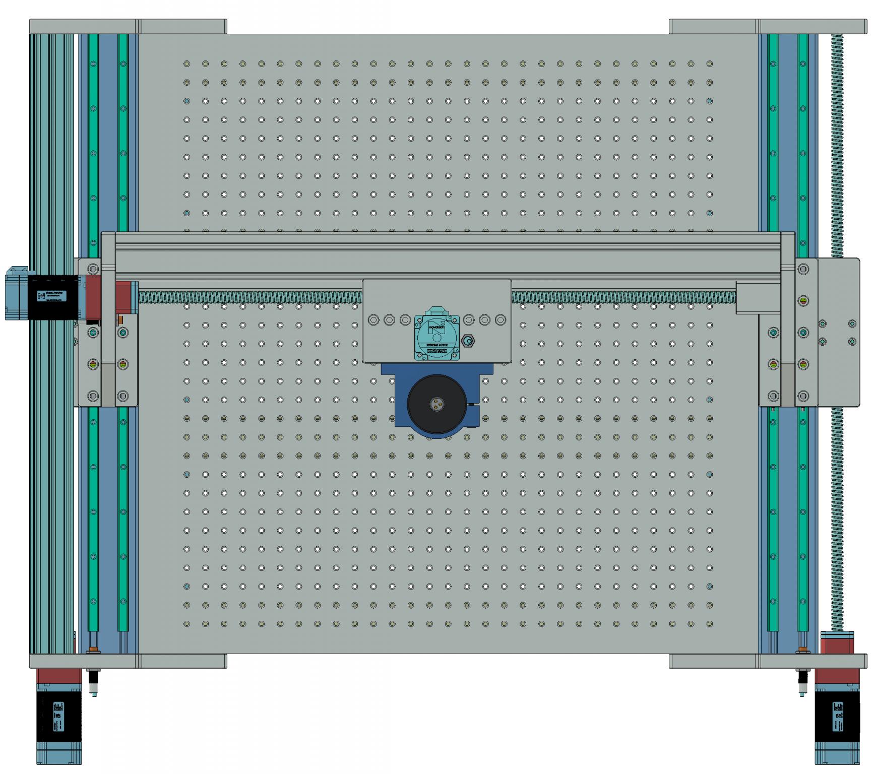

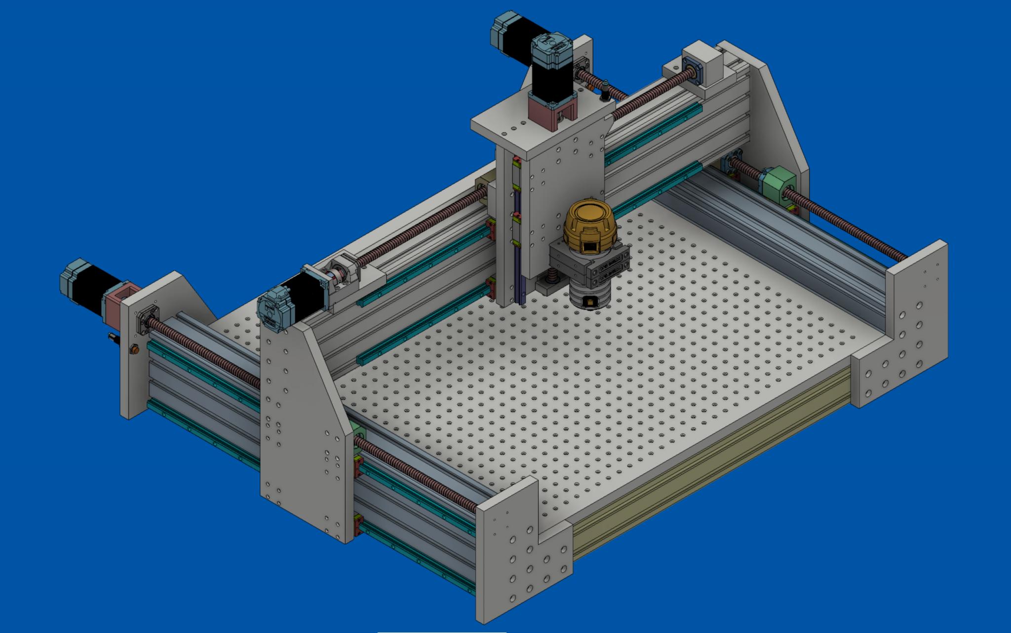

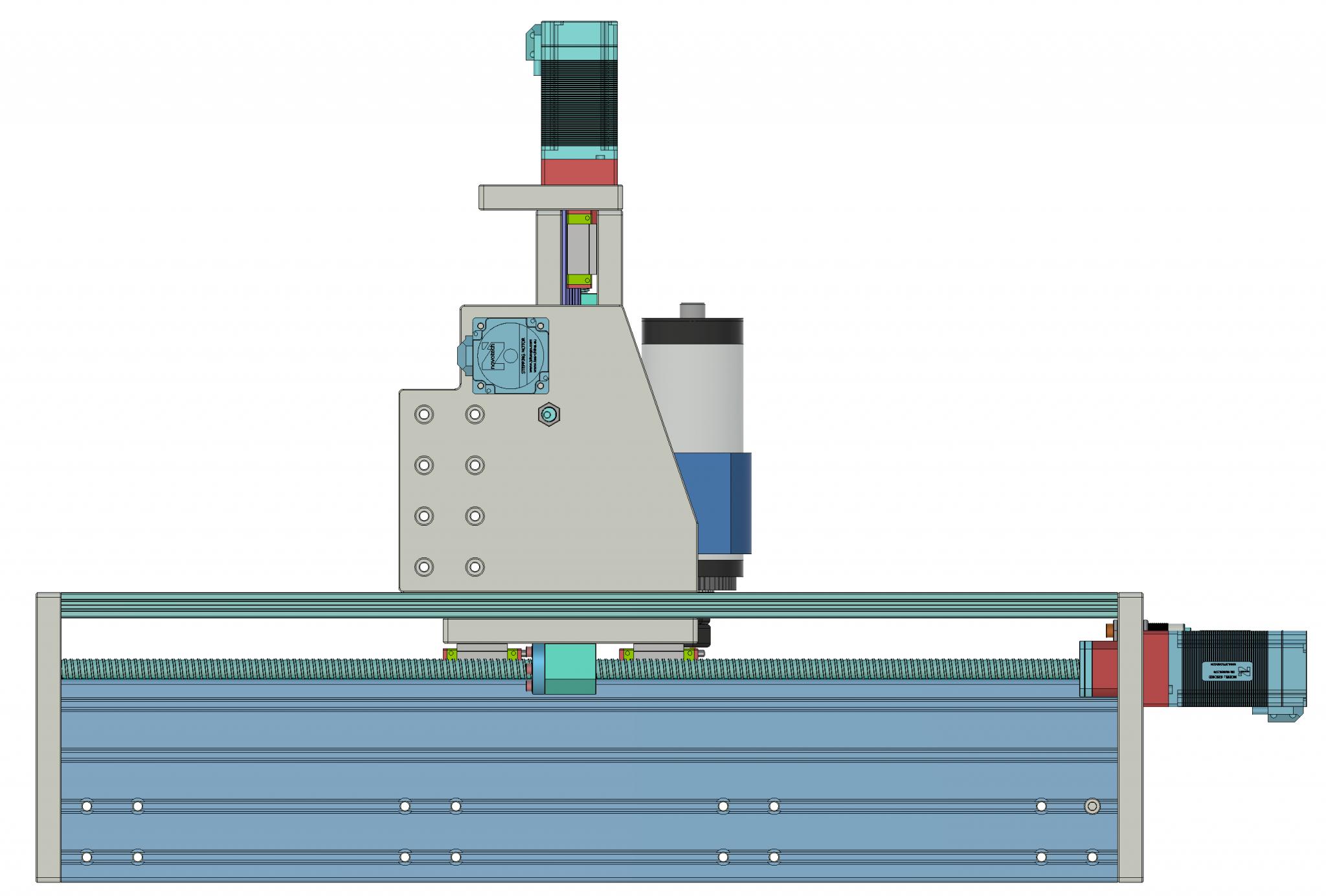

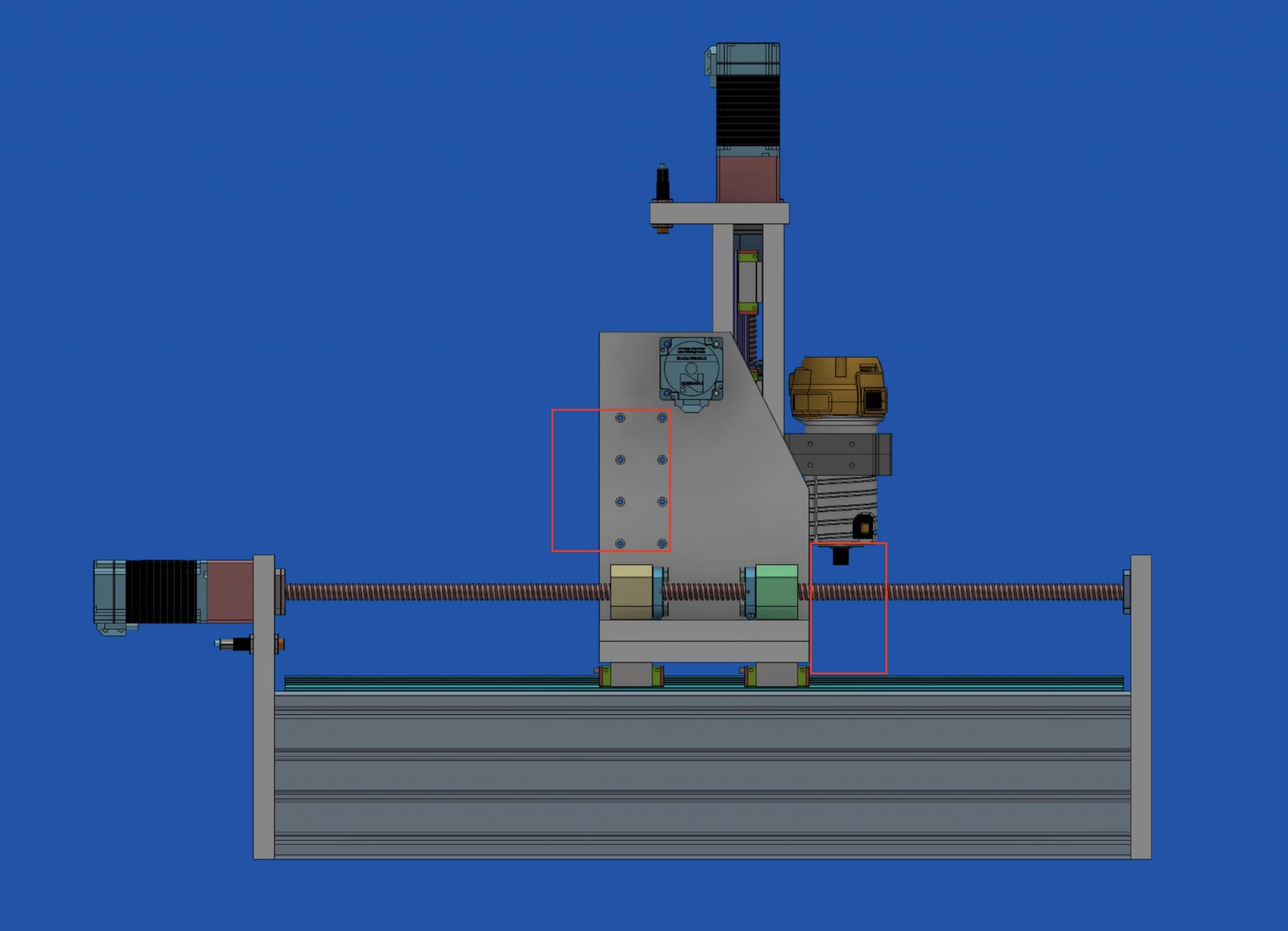

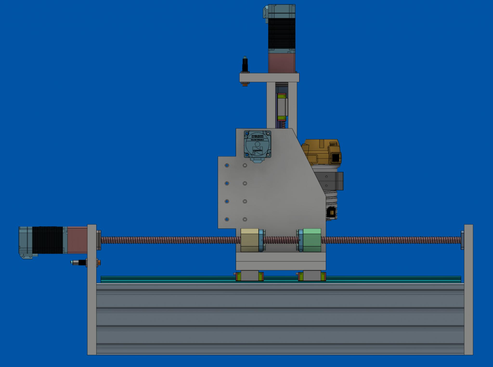

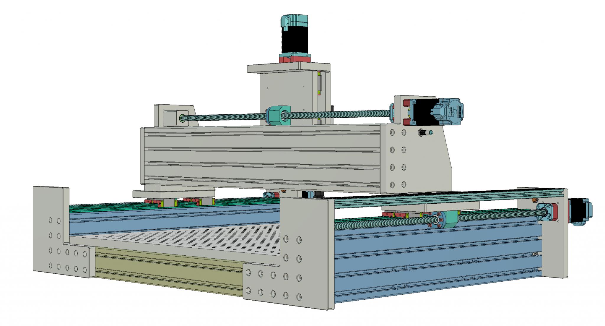

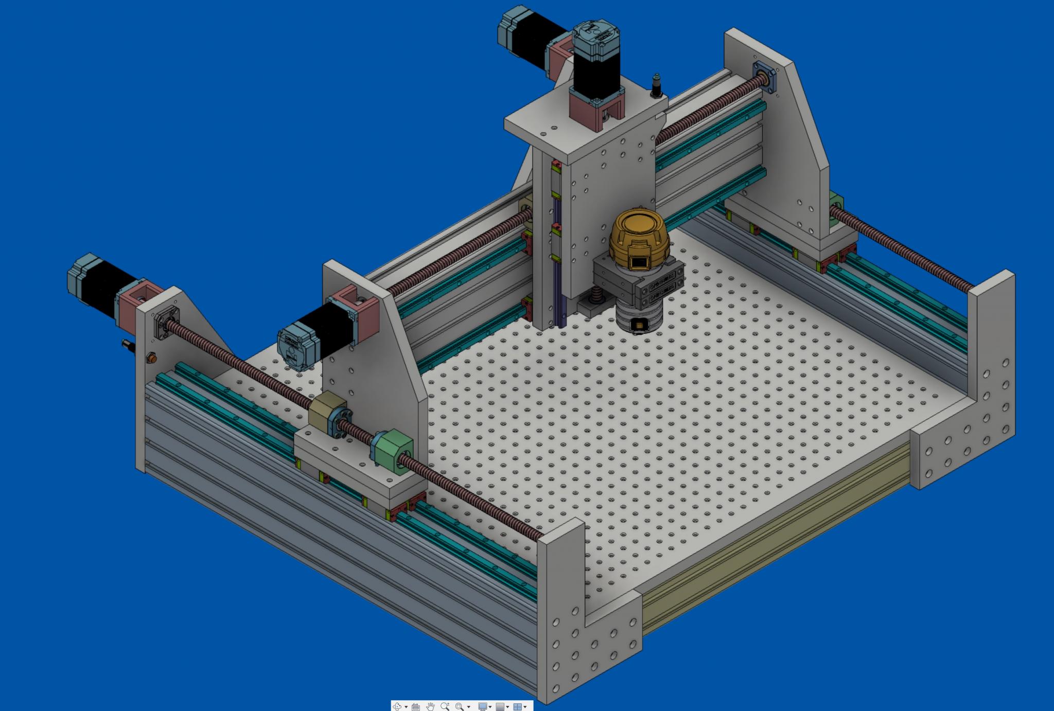

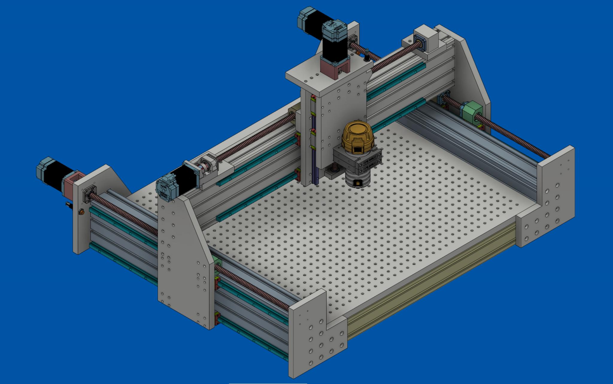

    After further considerations, planning and design, I have revised my previous design and made several chnages.
    I am now moving to the build stage and will likely start to build some assembly in the next week or two, so this is my last chance to take on board some feedback and fix any errors or oversights!
    This is the latest design...
Name:	Screenshot 2020-10-23 at 18.54.06.jpg
Name:	Screenshot 2020-10-23 at 18.54.20.jpg
Name:	Screenshot 2020-10-23 at 18.54.45.jpg
Name:	Screenshot 2020-10-23 at 18.55.18.jpg
Name:	Screenshot 2020-10-23 at 18.55.44.jpg
Name:	Screenshot 2020-10-23 at 18.55.55.jpg
    Feedback and comments welcomed...

    Hi ian,
    I hope you havent started yet, because I would strongly reccommend to go with design option 2.
    - The reason is, that the arrangement of the x-rails of option 1 is allmost pointless. The idea to have more than one rail is all about having a broad base (by putting them apart as much as possible) to compensate larger moments (to make the design stiffer).
    In design option 2 you have a far better stiffness using the same components, hence you will get closer to your design goal of a 0.01mm precision (wich is tough to achieve)
    - Option 2 will also have less debris falling on these rails.
    More ideas:
    - Another improvement to option 2 in that same direction would be by placing the x-spindle also on the outside, having less debris on it and the nuts beeing in the middle of the 4 wagons (seen y-wise optimum for transferring forces) . The spindle and its nuts can even be put on the outside of the cheek, making it more accessible to adjust (you are going for a 2 nut spring loaded design, I take it), to grease and to clean.
    - Increase the cheek plates thickness to 4/3 of what they are now. Same goes for the plates of all the z-parts.
    - Consider side-plates for the moving z-plate to increase the second moment of inertia in x-direction (y-direction is never a problem there)
    - Also prepare the design to hold a "real" milling spindle later. Starting cheap with a handhold router is absolutely ok, but you will later want to get a spindle built for that CNC-purpose anyway, e.g. in the 2.5KW region.
    - If you then will go for a watercooled version, you will also have a quieter machine when milling plastics.
    Furthermore:
    - Rubber bumpers that stick out allmost as much as the end sensors on the x and y axes may save the thing in case of an end sensor failure. To find space for the bumpers on the z axis is more tricky, but there are doughnut shaped solutions, that mount right around the spindle end bearings or around the nuts.
    - Concerning the mentioned axial versus the tangential use of these type of approach-sensors: To my experience, the axial use you have chosen is far more precise (repettitive correctness). That would also improve such an end sensor as an absolute home sensor, if you intend to use them that way.
    - To avoid destruction of the sensors in case of collision, I use plastic (printed) adaptors around them, which will break under stress, so that the sensors will just be pushed through their larger mounting holes.
