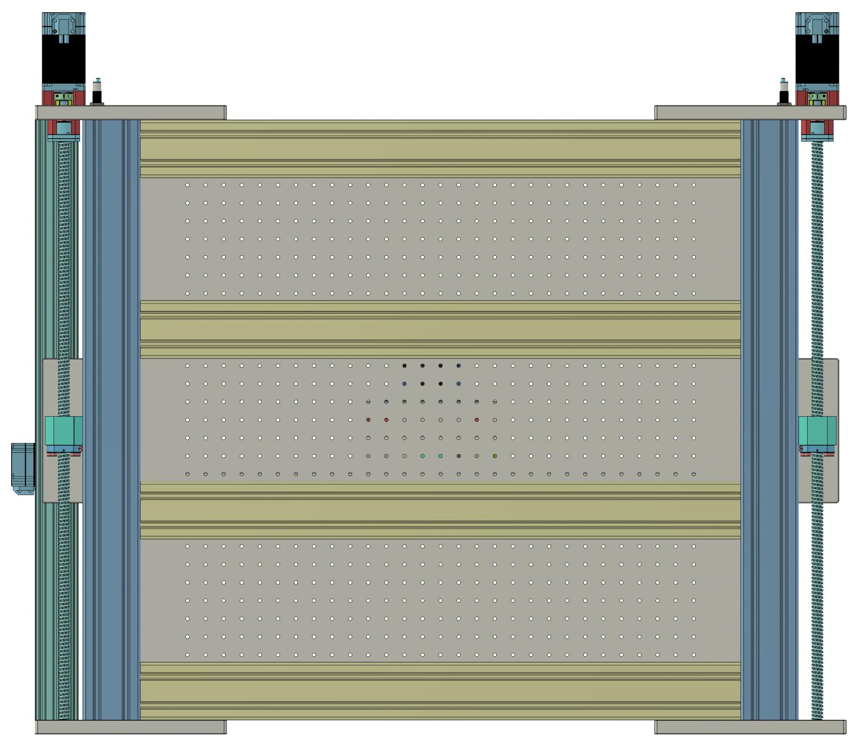

    For the frame, I plan to use 80x80 and 80x160 profile. Please see the attached image for the frame.
    Questions:
    1. Are 4 cross-members on the X-axis too many - would 3 suffice?
    2. Are corner brackets and the connection with t-nuts sturdy enough to give a rigid frame? Or should I tap the ends and drill M8 holes and fasten them from the outside of the Y beams?

    For the fixture plate, I plan to use 20mm aluminium drilled and tapped for M8. The plate will fix to the profile, and I will fit a 10mm - 20mm spoiler material to the top
    Questions:
    1. What grade aluminium would be best?

    Budget seems achievable. I don't envy you having this in your office; even with a watercooled spindle rather than a router don't expect to get much other work done without wearing ear protection. An enclosure will help... but...
    The inherited components are never a good sign to be honest with you. They tend tie one hand around your back before you start. You've said you're cutting plastics primarily which tend to want higher feed rates, so 5mm pitch screws might not be ideal as they dictate your speeds somewhat. You may find you'll have to introduce some gearing to get the speeds you want. Having said that plenty of people on here build with 5mm pitch direct drive and it works for them.
    I'd go with the beefyer profile every time. More rigidity, less vibrations.
    As you've mentioned, the 'best' would be ground tooling plate.

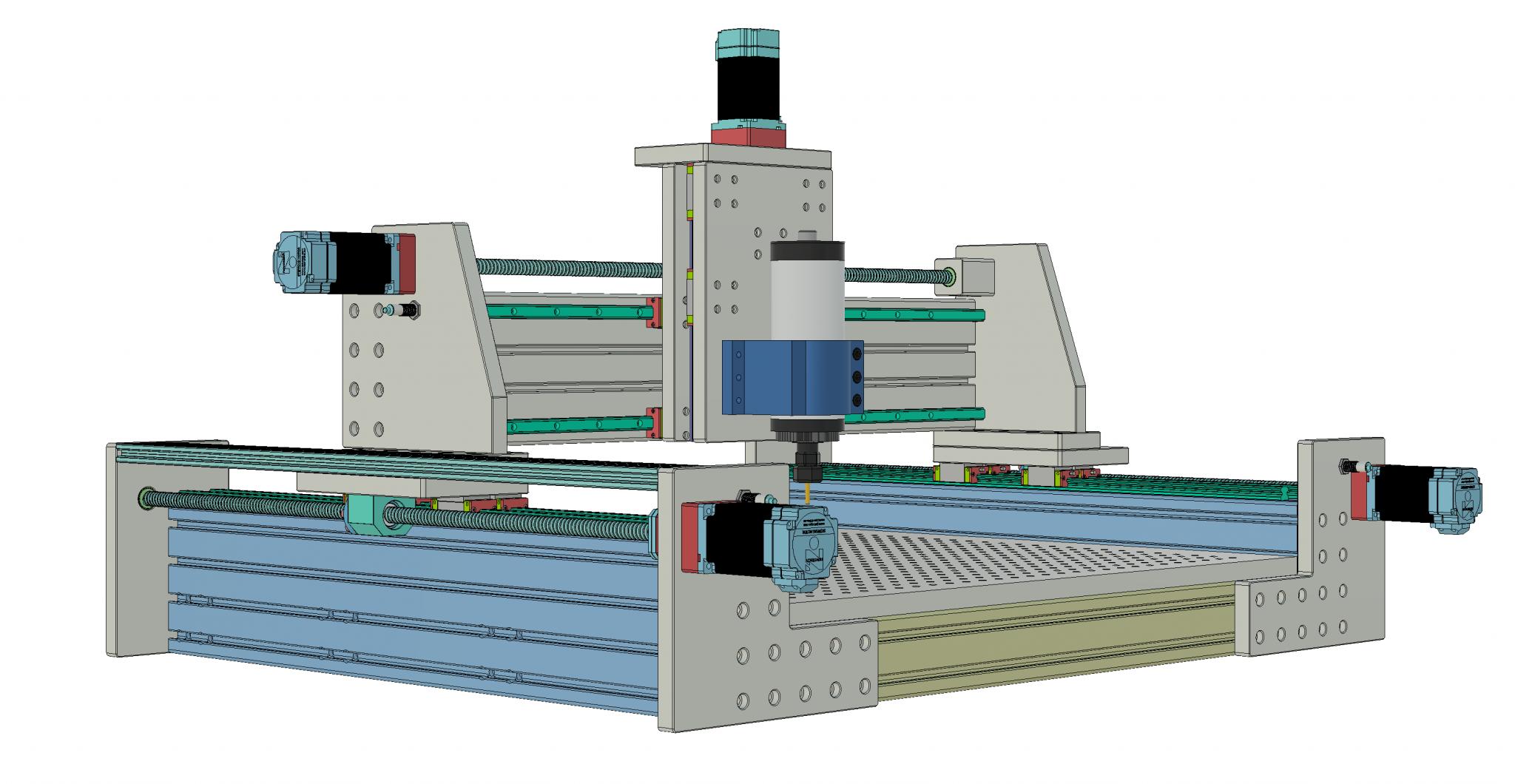

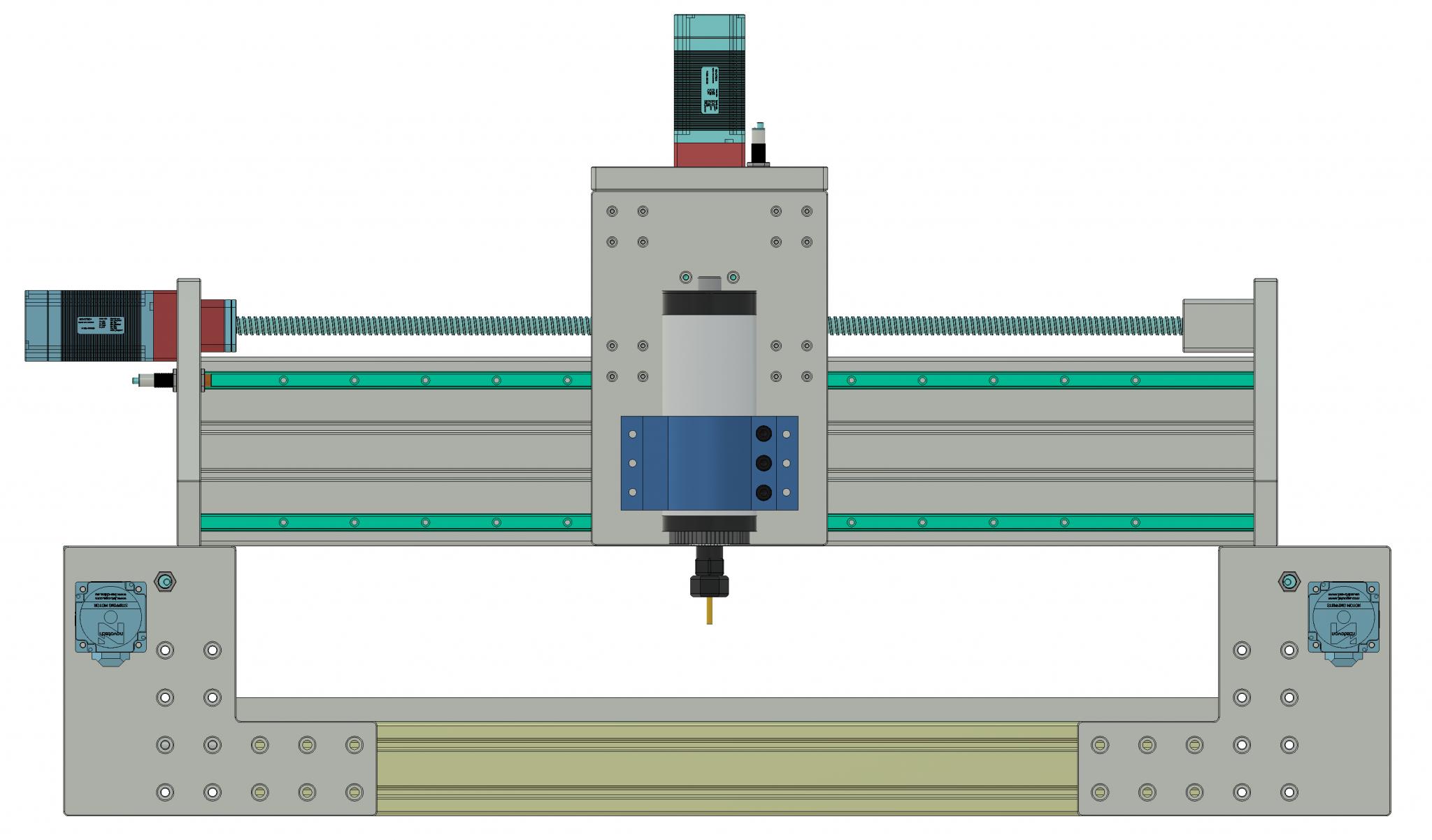

    After further considerations, planning and design, I have revised my previous design and made several chnages.
    I am now moving to the build stage and will likely start to build some assembly in the next week or two, so this is my last chance to take on board some feedback and fix any errors or oversights!
    This is the latest design...

    Feedback and comments welcomed...

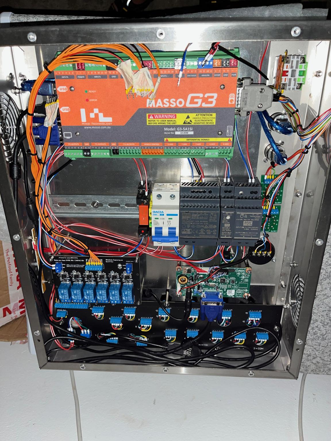

    Lives in London, United Kingdom. Last Activity: 23-12-2025 Has been a member for 5-6 years. Has a total post count of 25.
    Giving this another try...
    Wiring 0.1.pdf

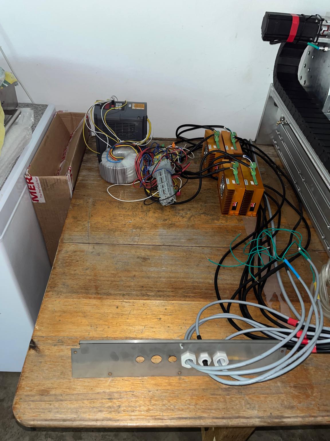

    I have very little experience in electrical wiring but I have drafted the first wiring diagram and will appreciate any feedback to make sure I don't make any serious electrical mistakes!
    Some key questions I have:
    Is it good practice to use the terminal blocks to distribute the power
    Should I connect the VFD as a separate feed from the mains or can I run it from a single main for the whole system
    Should I connect the VFD via the relays (not sure the relay can support the power draw)
    any help will be appreciated!

    First thing that strikes me is you haven't fused things. That toroidal may also appreciate a D-Curve MCB.
    The limit switches will probably want powering. I'd suggest some power indicators to notify you when things are live.
    Just have a single earth bus rather than two.
    I used DIN rail terminal blocks with bus bars. Seemed to work absolutely fine. Nice and tidy.
    I connected my VFD through a single feed into the cabinet, but I used some noise suppression on the mains lines to reduce the noise output from the VFD. Just £3/unit from China. Commonly its suggested to take the VFD power feed from somewhere else in the room, but I can't tell you which is best. Some VFDs say in the manual not to turn them on and off via a relay, so I don't have mine on one.
    If it helps, I've posted my circuit diagram on my build log, post 89, around page 9.

    Design feedback wise, looks pretty reasonable given the components you've already got. Looks like you've placed the limit switches in an interesting position though - it they don't trigger they're going to get crushed :) I'd put them at a right angle to the direction of travel. You'll also want to be sure that they will trigger on the aluminium (they should - but with a significantly reduced sensing distance), or you'll want a ferrous metal target.
    Hi Ian,
    The schematic as a few issues I would address.
    First off you don't have a safe E-stop system because you are only sending the E-stop signal to the controller so are relying on software to stop the machine. The NVR switch isn't doing anything so may as well just be a ON/OFF switch. The only way to take advantage of the NVR switch would be to run it through the E-stop contacts so when E-stop is hit the NVR does it job and drops power and won't reset untill E-stop is cleared. However this means running mains power through the E-stop and probably around the machine which isn't ideal.
    So a better way is to drop the NVR switch for a normal ON/OFF contactor then create a latching Safety circuit using a relay and momentery button with 24V running through the E-stop circuit which is much safer.
    This creates you an hard wired safety circuit which you can then control many things using the relay contacts or several relays in a circuit so when the E-stop occurs you can leave other things turned on which you don't want turned off when E-stop happens, like Motion controller and VFD etc.
    You can also wire them to turn things on as well, like light towers or sirens warning you the E-stop happened or the Kettle so you can enjoy the Oh-Shite Hob knobs with a nice cuppa Yorkshire tea to console your self...
    One of these contacts you would use to send the signal to the controller informing it the e-stop happened so it can stop the G-code. The other contacts you would use to Kill power to the toroidal transformer or a Contactor that feeds the toroidal PSU if it's high current.
    Also one contact would send a signal to the VFD that an E-stop occured. Don't wire the VFD power through any relays, it should stay on when an E-stop occures but should be told to Stop and kill it's outputs.
    Regards the spindle and water pump, the VFD as a relay built into it, use this for the water pump so the pump only runs when the spindle is turning.
    The other thing is to only have ONE Ground point, STAR grounding, where every ground or shield wire runs too, if not you run the risk of creating Gnd loops.
    The only exception is the VFD, with the VFD you take the spindle wire shield to the Gnd point on the VFD, the VFD Gnd is then taken from the STAR point.
    Also only Gnd the shields at one end, usually in the control box.
    You need fuses on the PSU's and VFD, I would also think about putting fuses on the drives, also the water pump and dust extraction.
    The Terminal blocks are fine and a very easy way to create bus bars for pulling power from.

    Hi ian,
    I hope you havent started yet, because I would strongly reccommend to go with design option 2.
    - The reason is, that the arrangement of the x-rails of option 1 is allmost pointless. The idea to have more than one rail is all about having a broad base (by putting them apart as much as possible) to compensate larger moments (to make the design stiffer).
    In design option 2 you have a far better stiffness using the same components, hence you will get closer to your design goal of a 0.01mm precision (wich is tough to achieve)
    - Option 2 will also have less debris falling on these rails.
    More ideas:
    - Another improvement to option 2 in that same direction would be by placing the x-spindle also on the outside, having less debris on it and the nuts beeing in the middle of the 4 wagons (seen y-wise optimum for transferring forces) . The spindle and its nuts can even be put on the outside of the cheek, making it more accessible to adjust (you are going for a 2 nut spring loaded design, I take it), to grease and to clean.
    - Increase the cheek plates thickness to 4/3 of what they are now. Same goes for the plates of all the z-parts.
    - Consider side-plates for the moving z-plate to increase the second moment of inertia in x-direction (y-direction is never a problem there)
    - Also prepare the design to hold a "real" milling spindle later. Starting cheap with a handhold router is absolutely ok, but you will later want to get a spindle built for that CNC-purpose anyway, e.g. in the 2.5KW region.
    - If you then will go for a watercooled version, you will also have a quieter machine when milling plastics.
    Furthermore:
    - Rubber bumpers that stick out allmost as much as the end sensors on the x and y axes may save the thing in case of an end sensor failure. To find space for the bumpers on the z axis is more tricky, but there are doughnut shaped solutions, that mount right around the spindle end bearings or around the nuts.
    - Concerning the mentioned axial versus the tangential use of these type of approach-sensors: To my experience, the axial use you have chosen is far more precise (repettitive correctness). That would also improve such an end sensor as an absolute home sensor, if you intend to use them that way.
    - To avoid destruction of the sensors in case of collision, I use plastic (printed) adaptors around them, which will break under stress, so that the sensors will just be pushed through their larger mounting holes.

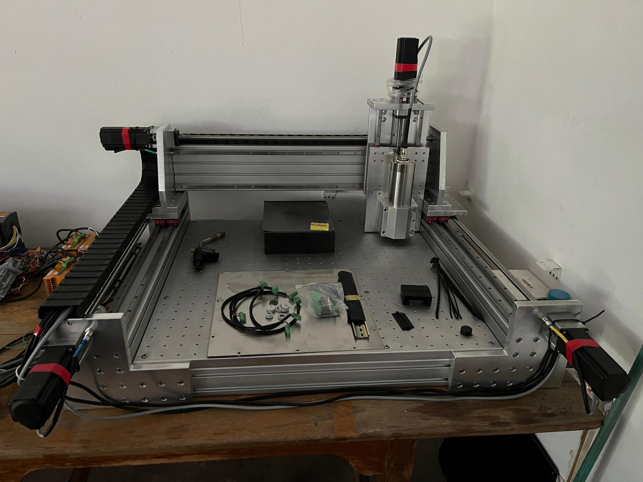

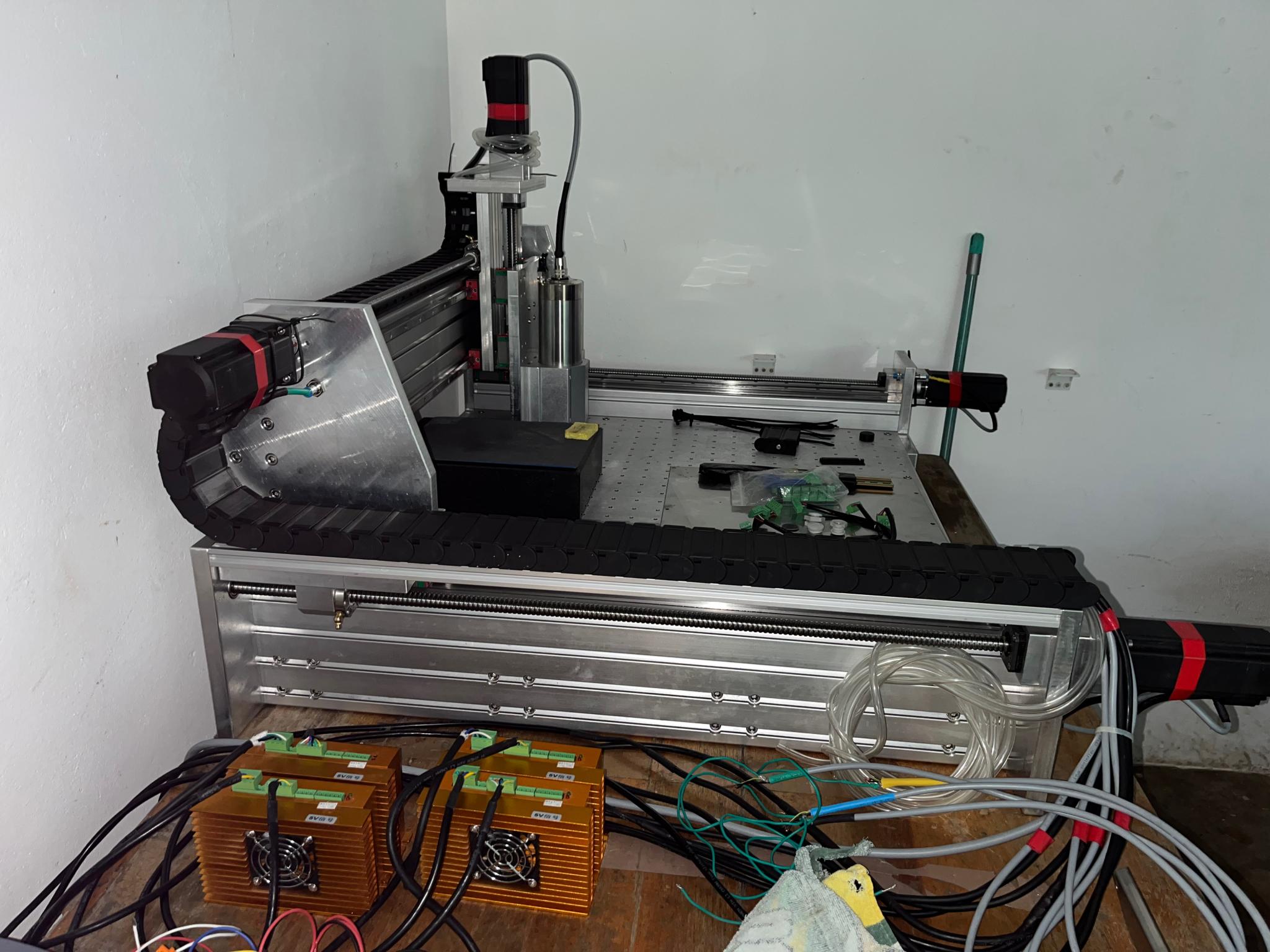

    It's been a long time since I worked on or posted an update on my build. I had to put the parts into storage and my build was delayed as I had to move twice and didn't have the space for the machine. I worked on it in short burst and am now starting to make progress again and attach a few pictures. I used a Openbuilds workbee and initially cut plates from Delrin. I then partly assembled the machine using the Delrin plates and then machine aluminium plates but unfortunately I cannot locate pictures of this interim step. The surface finish though is very bad and I will likely finish these by hand to improve it.
    Herewith a couple of pictures to show the current state. Next steps are to complete the wiring in the next week or so.
    During assembly I realised that I've not allowed for proper adjustability and one of the first tasks will be to cut two new plates to improve the fore/aft and lateral adjustments.
