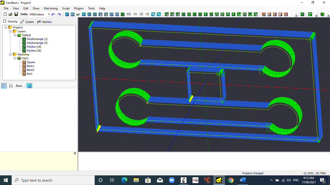

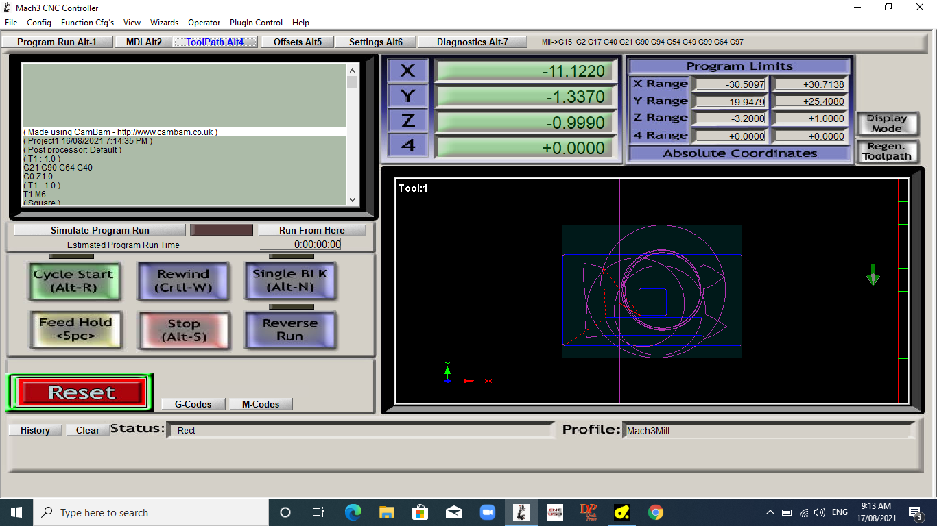

    Hello, I am new to CAMBAM and having an issue whereby Toolpath movement get executed on stock when loading GCode on Mack3 Click image for larger version.
ID:	30338Click image for larger version.

    Sounds like you may be suffering from what are known as "Crop Circles " A few of us have been caught by them and a search will probably turn up some topics (worth a read)
    In Mach, go to config / general config /
    In Arc IJ mode you have the options of abs, or inc . Whichever is now selected, choose the other, then try loading your code again
    Hello dear John,
    I do not know how to thank you, it is working by now. have a great afternoon ahead.
    Wael
