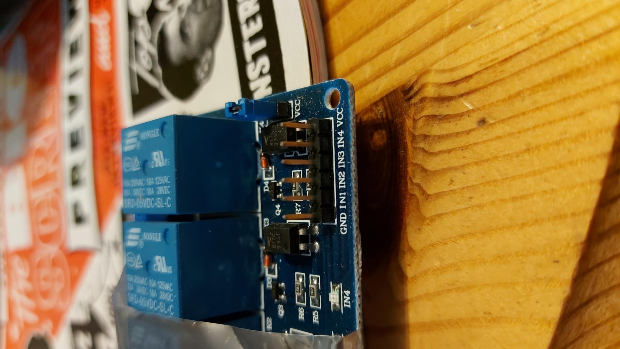

    Hi all. I need a 6 pin connector for this board. Could any one give e me a link to where I can buy one in the uk. Plenty from China but I could do with one soon. Thanks allClick image for larger version.

    For these Arduino type boards, I often use individual connector pins and super glue them together.

    Thanks dean. Have you got a link to any by any chance
    Look at Dupont connector shells and crimps.
    If you want a generic loom making up and don't want to shell out for the crimping tool I'm happy to post one out if you give me details of what you need. PM if you want.
    Edit: am I going senile or have you chopped that board in two?

    I'm pretty sure Molex also do some that will mate with that header.
  7. #6
    How thick are the pins?
    Maybe these will fit. Either:
    Lipo balance cable 5s (JST-XH).
    Or a few 2 pin JST type.
  8. #7
    XH are 2.5mm pitch - the Duponts are 2.54mm
    As Jazz says, grab a bunch of Arduino patch cables and glue them if you want something off the shelf. Or PM.
    Edit: JST-RE might fit - they are similar to the Dupont.
  9. #8
    This is 2.54:
    https://www.amazon.co.uk/POPESQ%C2%A.../dp/B06XZV75YW
    Or this type:
    https://www.amazon.co.uk/POPESQ%C2%A...puters&sr=1-63
  10. #9

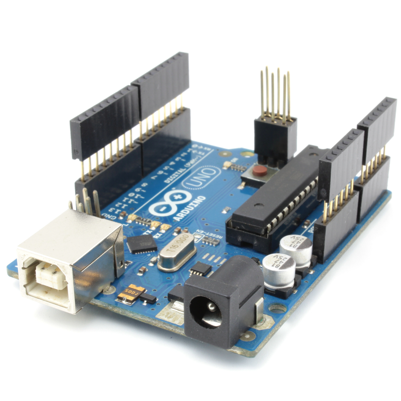

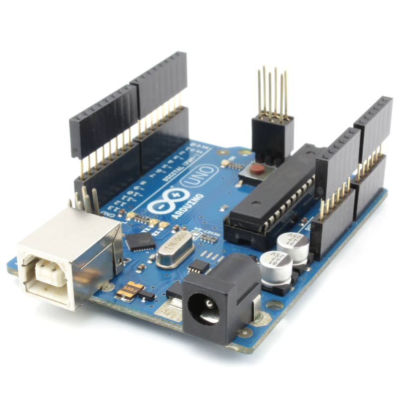

    If you can find an Arduino header, often supplied unsoldered with some Arduino boards, you can bodge a connector together in a hurry. Tin the pins, solder on the wires and put heatshrink sleeving on each one.
  11. #10
    Those linked by Kitwn are compatible.
    If OP wants a quick solution, rather than buying an uncompatible connector, another altogether better solution if you don't necessarily need to mate/unmate the relay board is to (easily) slide the black shroud of the connector on the relay board up on the pins (they are friction fit - not bonded) to remove the plastic from the 6 pins, then its an easy job to hold each pin one at a time an reflow the solder on the pad on the board. Decent temperature - you'll remove the pin in a second or two and you can clean the pad, then wire direct to board. It's not great, but these Dupont (or, more correctly mini-PV) connectors aren't brilliant since there's no mechanical retention of the mated connector beyond the sprung friction mechanism within the socket terminal.
    If OP would prefer one of the alternative connectors - my advice would be to remove the Dupont (as above) and fit the corresponding, compatible plug. Not a bad idea if you want a more robust mechanism. That first one that DazP linked is a Molex KK-254 series - nice range of connectors with a strong mechanical retention mechanism - much superior to the Duponts. But don't mix-and-match - take my 50 life-years of experience of bad decisions on that one.
    Edit: I've been to the shed - I hold consumable levels of KK-254s and Duponts - in fairness I can slide a Dupont socket down a KK-254 - and looking at the datasheets they each have a 0.64mm square pin, so actually not as bad as I make out above. The Molex pins are longer but are retained by the spring clips. But if you're ordering from Amazon just buy a Dupont jumper set to begin with.
