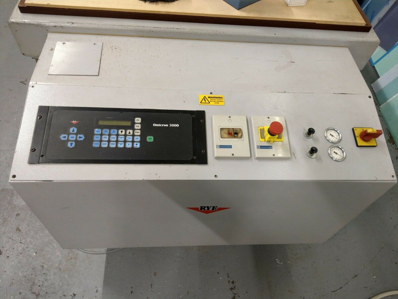

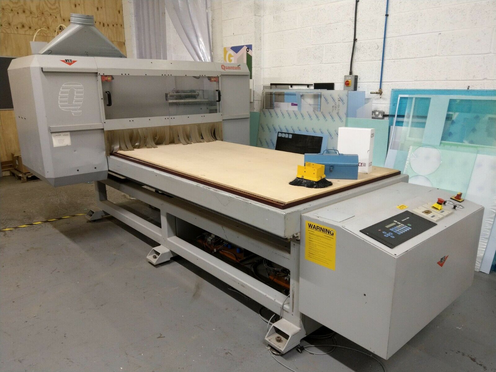

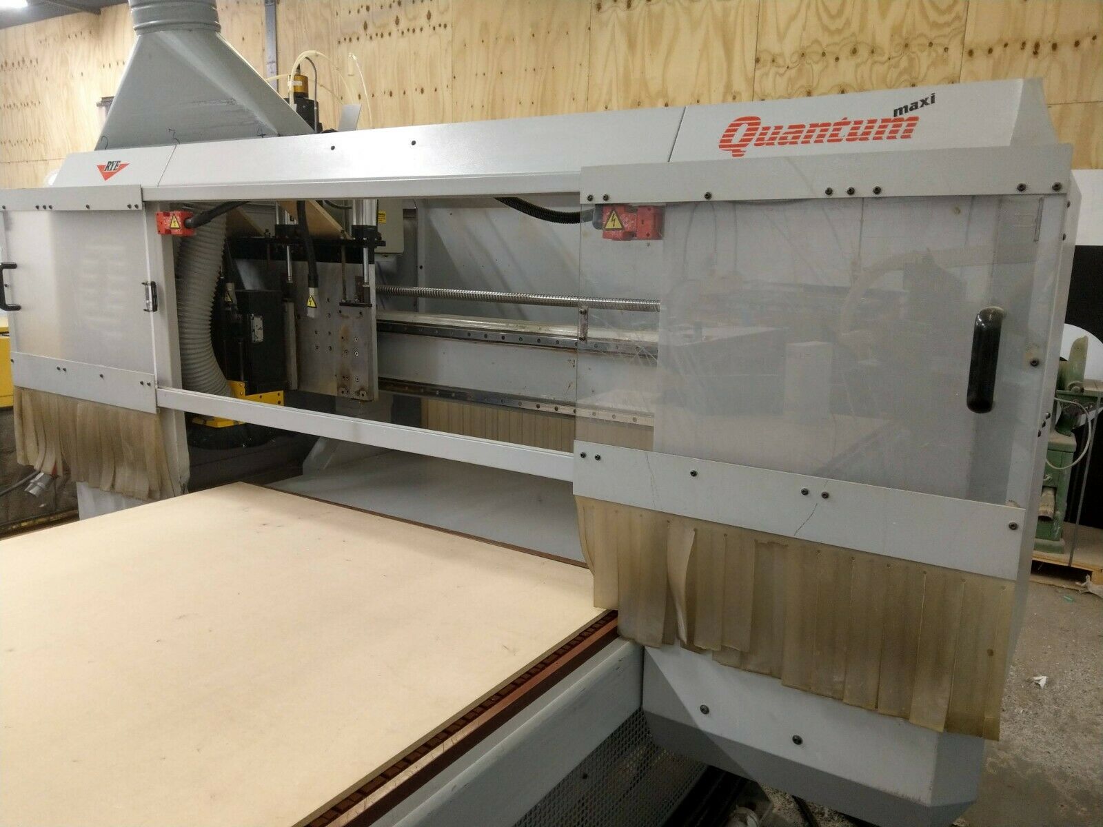

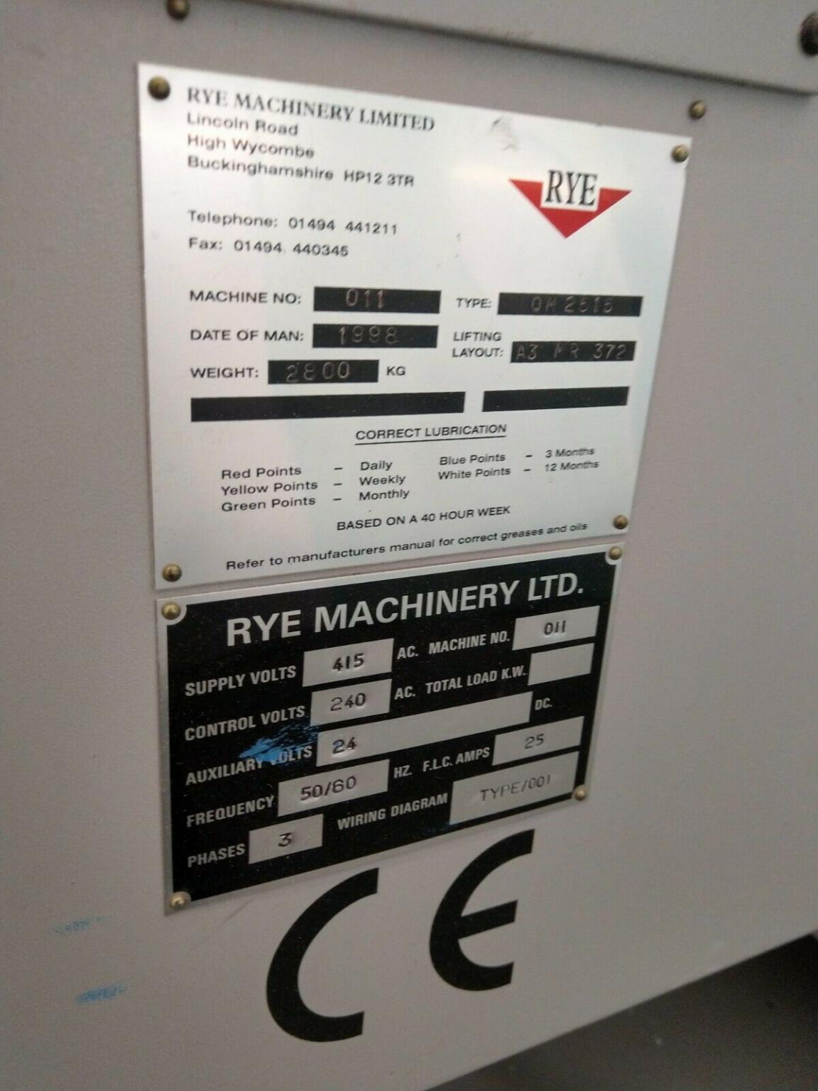

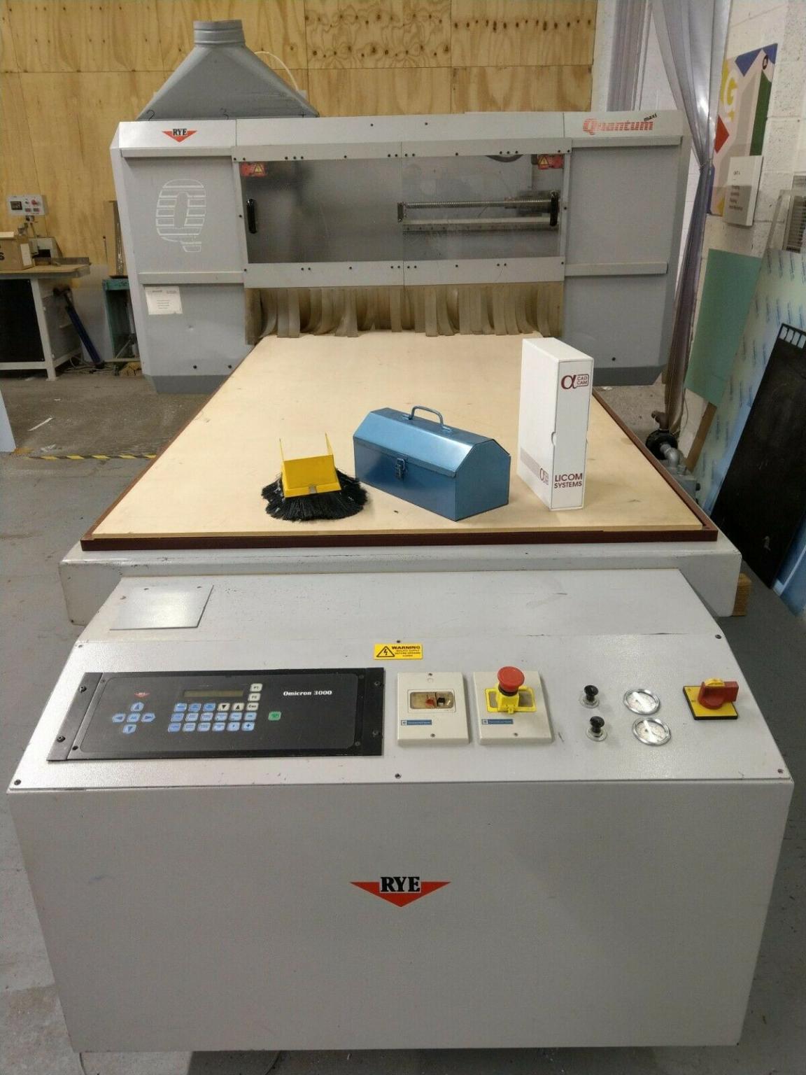

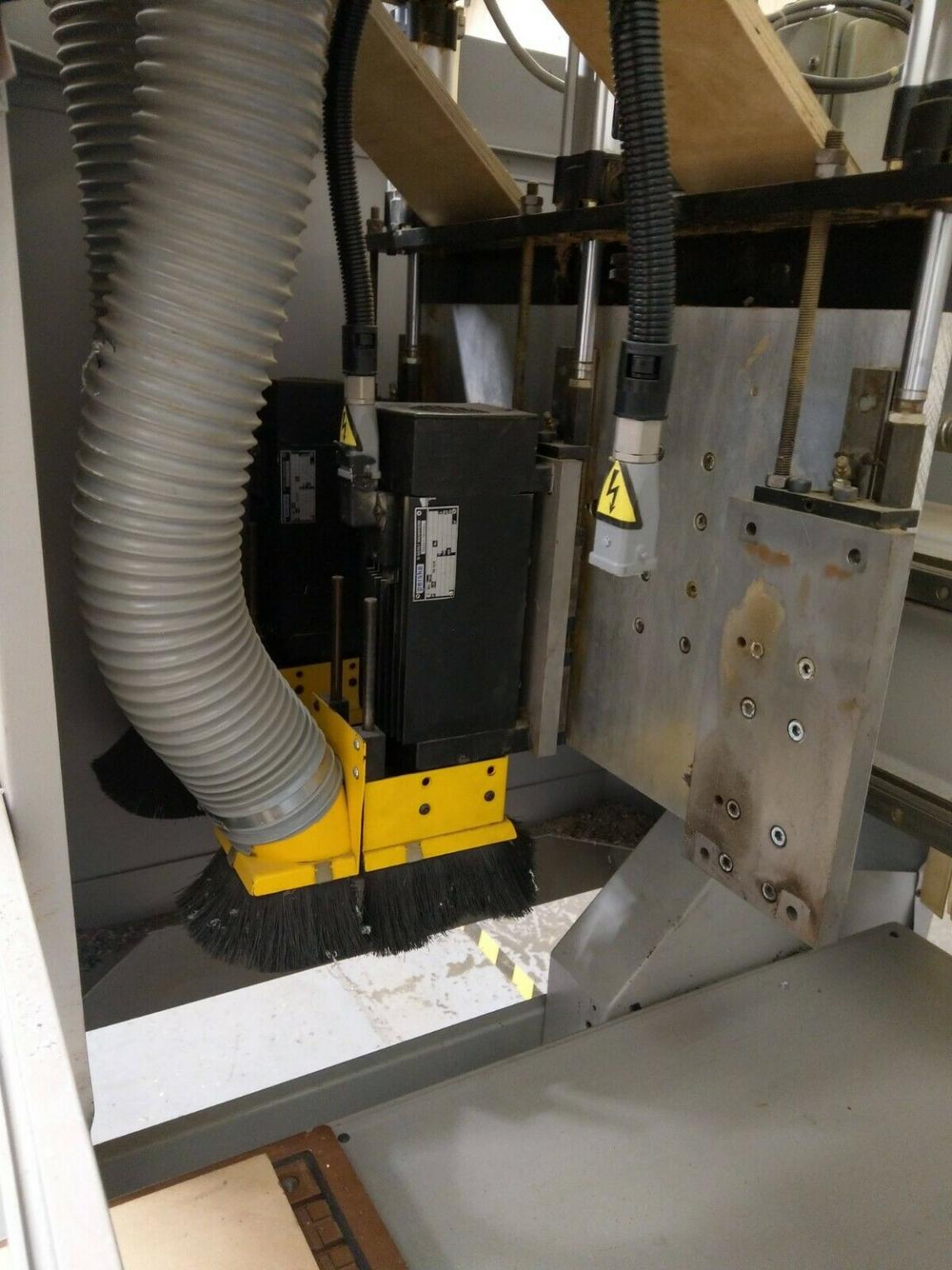

    What I have now finally done is purchase an old RYE Quantum QM2515 cnc router.
    It has a twin-spindle system and vacuum bed.Although no pump!!
    2440mm x 1220mm bed size. Powers up and moves to datum. No software or any idea what it originally used, however i'm open to suggestions on what now may work!!
    I have been considering making my own frame,gantry etc for ages but when I saw this I thought well for the money even if all the motors and electronics need replacing it would cost more to build the frame and guides etc.
    I won't be doing anything with it for the next few weeks until a couple of other things are out of the way.
    I look forward to your comments and hopefully loads of help!!!
    images below....

    Rye made quality machines.May we assume you have a three phase power supply?I raise the topic because the [I]weakest [I] motor I have seen on a vacuum system was 4Kw.You will be able to hold down some jobs with clamps or screws I expect.If it moves to datum you should just need to load programs and run them.You would be a long way ahead if you have manuals for the machine and if they didn't come with the machine you may struggle to find them as Rye went out of business almost twenty years ago.I used to know who bought the remnants of the business,but for now it has escaped my memory.

    We do have 3 phase elec. This takes 3 phase for the motors and 240v for the electronics.

    Its good that you know your way round CAD software as this will give you a huge boost when iit comes to producing parts.In terms of control software,are you sure that what the machine has currently is deficient?If the machine can move around to home itself,it may just need a program loaded to get you up and running.How you load the program to the controller withing the machine might be a bit challenging.At the time Rye ceased manufacturing it was common to use floppies to move data and I wonder if the blanking panel on the top face of the controller covers a hole where a floppy drive once lived.An RS232 or a network connection for a CAT5 cable would be easier to live with and if all else fails you will have to resort to sitting there with a notepad and calculator typing in Gcode.I don't see a port of any kind,but there may well be something.I sincerely hope it doesn't come down to typing Gcode as there are much easier alternatives for generating toolpaths and transferring them
