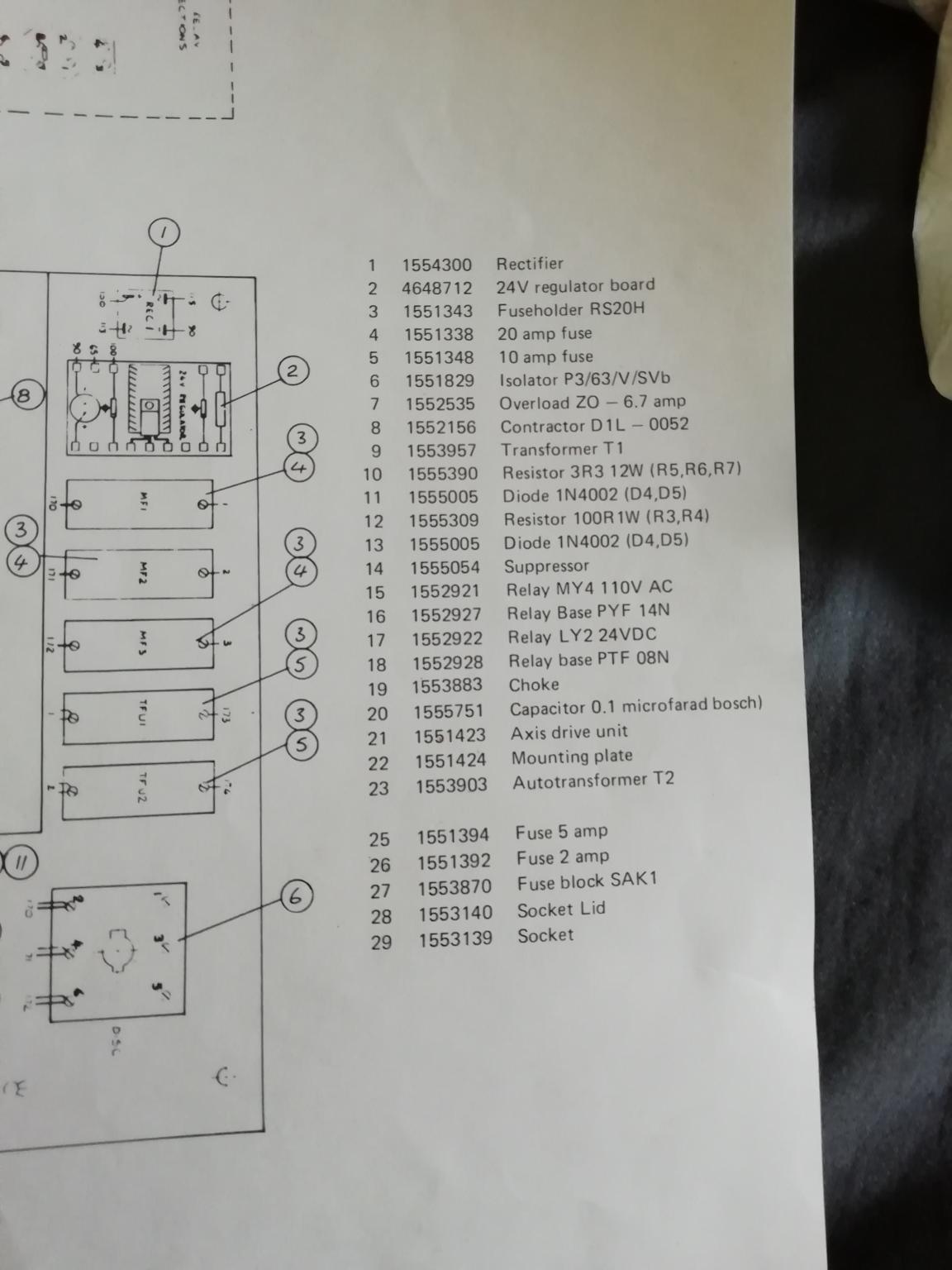

    My first problem is getting the drives to "jog" but i am having problems already here! I have power in and out of the primary transformer but it isn't making it to the next main transformer (T2 in the circuit schematic) I seem to have no power coming into the control switches on the side of the monitor and i am scratching my head to find the problem. Any of you had a problem like this? I have checked continuity on the main fuses and the next smaller fuses and they all seem fine but the lamps don't seem to light the main switches at all. Likewise there appears to be no power making it to the drivers for the axis at all. the test points are showing pretty much no voltage at all.

    Well, that appears to have worked! So, this is what i have to work from, not ideal but better than nothing. I am looking for a proper service manual but haven't found anything yet. A circuit diagram would help i think!
    I am, it would appear, getting the correct voltages from the incomer to the first transformer and out from there. The next logical step is to trace the wires from there and see if i can "find" another circuit breaker of fuse that is blown. Failing that (not anywhere near that point yet) i will strip the whole cabinet and start again.

    Hi Clive,
    On the feed cabinet wiring diagram (9-5, in the manual), it is right at the bottom. I have no power at all to the three chokes either. I may be reading the diagram wrong, so physically, it is the biggest transformer on the floor of the feed cabinet. Does that make sense?
    The only power i have is from the main transformer from the incomer...but the screen works. My initial thought was that the emergency stop or main switch may be fused somewhere that i can't see where!

    Hi Guys,
    Quick update, Seems there is contactor that doesn't appear to be working. (contactor D1L 0052)
    I have been tracing wires all afternoon and trying to find where each one goes, trying to build up a picture of what goes where and how it is connected as an "decent" wiring diagram doesn't seem easy to find. I have found one but it doesn't give an awful lot of helpful info (at least to me).
    So, the next question is, how do i test the contactor and figure out where it is going wrong? The main "power enable" button on the controller isn't lighting up either but trying to find if that is a possible root of the problem or if it is a symptom of the failing contactor is confusing me.
