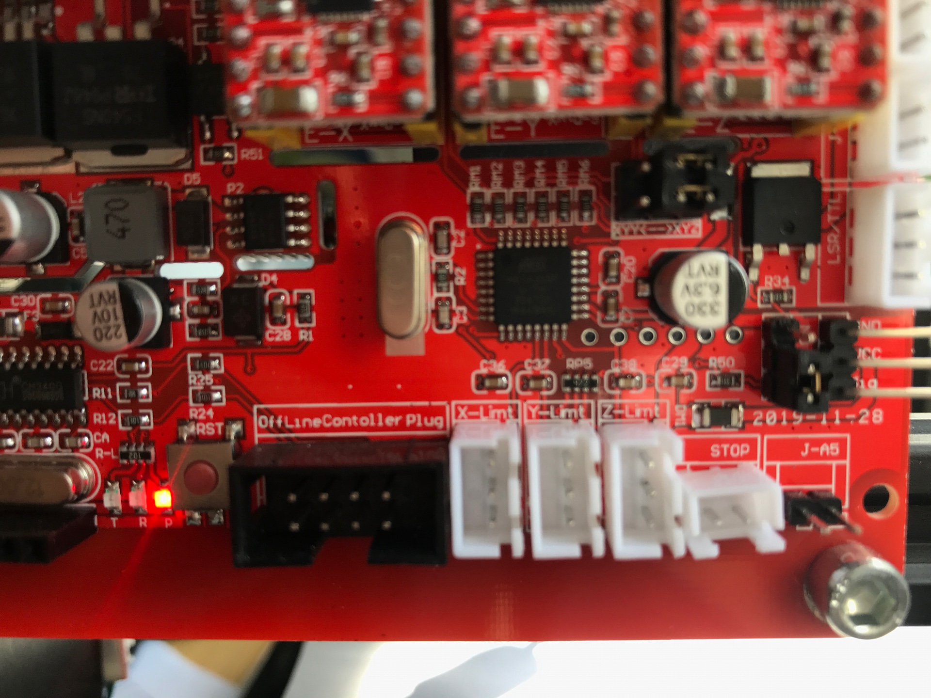

    * Question 1: I've connected the switches with the green wire to the + and the black to the - on the controller board - does that seem right?
    The switch document says that;
    "Red line connecting VCC (ramps of +)
    Connect the black wire GND (ramps of -)
    Green line connection Signal (ramps of s)
    " - which I can't say that I understand.
    When I do depress the switch, I think the wires are starting to heat up until it is released and it disconnects the machine from my laptop.It also dims the 'P' LED, which illuminates when I have either power or USB connected, so it seems to be drawing current (forgive me for such a basic statement, electricity isn't my strong point!).

    Here's a couple of photos of the controller board, not sure what else would be helpful to provide.
    * Question 2: What behaviour should I expect when the switches are triggered? Is there a setting within GRBL so that instead of acting like an emergency stop, the spindle will retract back to a previous position? My assumption is yes, as that would seem likely to me for how a homing setup would work. So far I've just been moving the spindle manually from my G-code sender (UGS) - maybe it behaves differently during a proper cut?

    STOP!, recheck your wiring.
    Green to +, black to -?, no, you provide the correct instruction - red to +, black to -, and green to 'S' (guess, "Switch" or "Sense"). What you have described with Green to + is that when you actuate the switch you're shorting the PSU to the RAMPS drivers. Chances are that's crowbarring the supply to the microcontroller and that's why the machine is losing comms with your PC.
    The limit switches on the control card should have 3 pins - get us a photo of that, or just review what you've done with the above in mind. I wouldn't power the machine until you've done that.

    I've attached photos showing the relevant part of the controller board.
    "Green to +, black to -" - yes, this is how I had it previously (and red to S). So it perhaps seems like a simple case of having put the plug on upside down onto the controller board?

    Yeah, those connectors provided with the switches aren't polarised - Orientate them with red=+, black=-, green=S. Ironically the connectors on the controller are polarised (different connector) so blame the accountants for penny pinching.
    You shouldn't have damaged anything... much (perhaps lifed a microswitch or two), provided the PCB has survived.

    If, however, I've missed the point - if the connectors ONLY plug in one way around onto the controller card then we need a plan B. Let me know.
  7. #6
    They are the same as lipo battery balance connectors.
    If you're gentle you can push on the tabs of the metal connectors with a stanley knife and slide them out of the connector block.
    Then swap them over, slide back in.

    If, of course, the cable is different with the OP's switches and the appropriate mating connector has been used, but the pin order is incorrect - then I'd agree - depress the retention clip on each socket and remove, reorder and re-insert.

    Thank you - the connectors to the board can be plugged in either way, so it was a simple enough job to turn them around. It now seems to be working as I think I expected - when I'm connected (using UGS) and I manually drive it into any switch, I now have an error returned;
    An unexpected error was detected: ALARM: Hard limit
    [Reset to continue]
    Really appreciate your help with this one!
