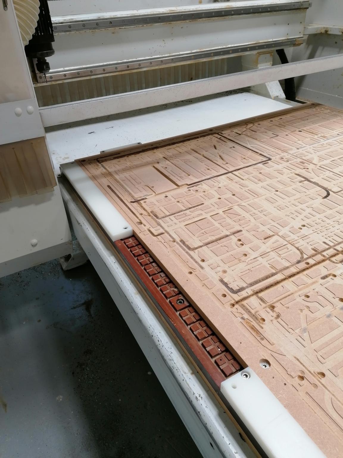

    Second I want to state that my usable working area on the bed is offset by x55 y25 which you will see in the first picture (ignore the scratch bed I'm about to change it )
