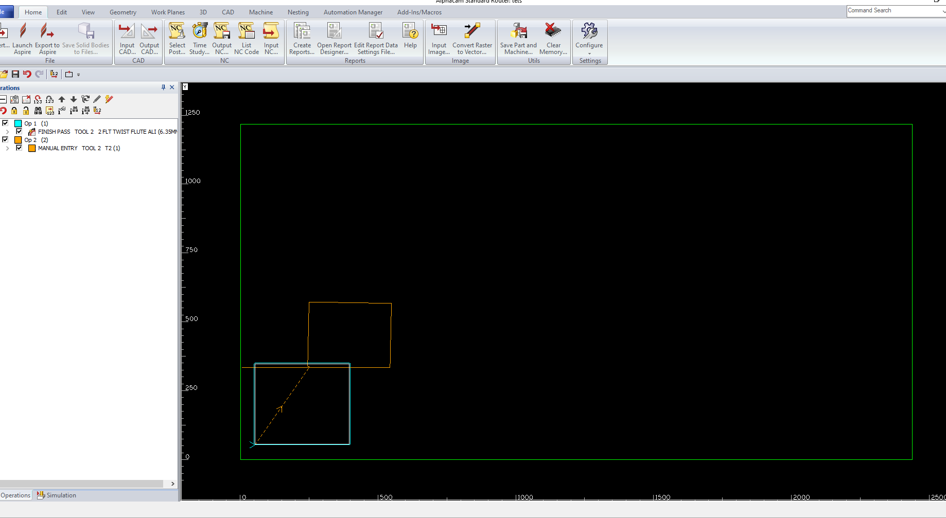

    Ive imported your code into my test file and you can see what your code was trying to do at least.

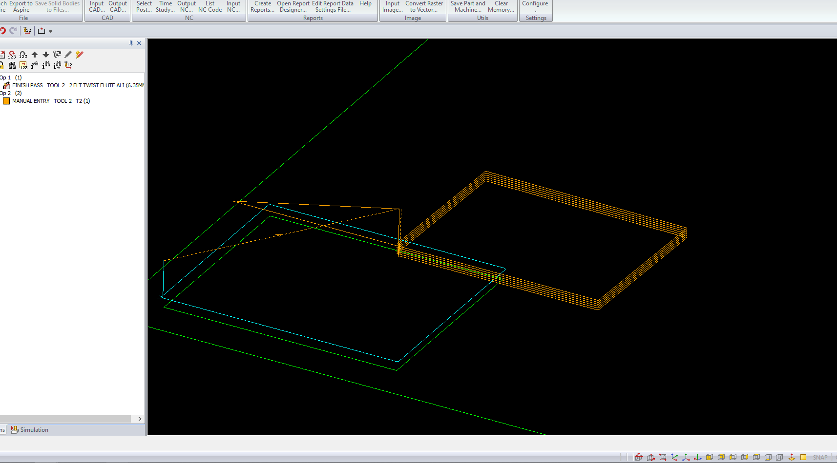

    Side view of your orange tool line.
