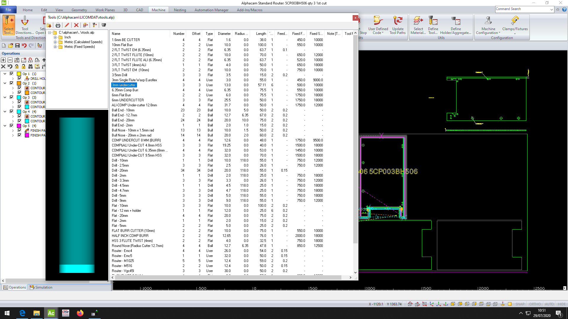

    QUICK UPDATE
    Machine works with the kindly supplied postprocessor file.
    It throws up errors with the standard one supplied in alphacam.
    What I've learned (I am a CNC VIRGIN)
    DATUM= Machine Park Position is approx. x-150,y-300
    HOME= Table 0,0 Has to be set each time machine turned on (or is this just me)
    I need to fully get to grips with the head selection, z setting and tool length etc before attempting a cut.
    I'll post again when I have made more progress....or a cut!!!
    Many thanks

  12. #38
    Quote Originally Posted by BEACHBLANKET View Post
    Had to tape it up.
    No way can you Z set the machine with the doors closed.
    Finski I managed to modify the post processor file your table 0,0 from park/datum is 100mm different to mine.
    I'm going to try a cut later today
    Sent from my Mi A1 using Tapatalk
    I'm just happy it sorted out the problems you was having. I think the difference between your machine and mine is I have 4 heads compared to your 2? (going by the pictures I've seen at least)
  13. #39
    I've got 3 heads but only 2&3 have spindles on.
    Just a quick question does yours have a tool changer?
    I only ask because in the startup routine you refer to set tool length.
    Or is that length of cutter??
  14. #40
    No tool changer. I have to manually change my tools by hand and then Datum the height to 0 on the scratch board. Tool sizes, cut length etc are recorded in Alphacam.
