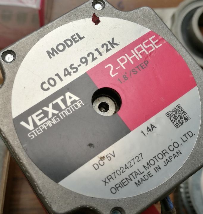

My query is about the Vexta stepper for the worm gear Rino unit which will give me 30:1 reduction. I bought it as a complete unit and the stepper, which appears to be a nema 23 size says 5v, 1.4amp. I’m used to steppers requiring much more power. I’m just wondering what sort of driver and power supply I should use with this stepper?

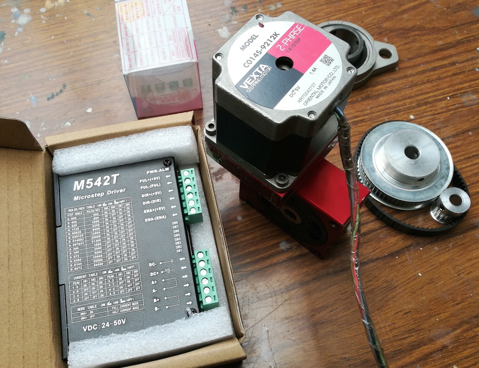

I’ve got an old M542T driver which says 24-50v and 1.5-4.5amp would that do as the driver for the stepper? If it is useable, what sort of power supply should I be looking at, 24v 2amps or something?
