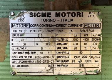

    I am trying to find out some information about driving a 7.5Kw dc motor in a bridgeport interact 1 Mk2.
    This is the plate on the same motor type (taken from an ebay listing)...

    The main thing here is that i have never come across this type of motor before and it has rather confused me (i thought it was just a lumpy 3 phase until i read the plate!), as well as finding info on it seems to be pretty hard too. The original driver is not working and I am trying to find out if there is an alternative way to drive this type of motor but without understanding what i am looking at, it seems impossible!
    Does anyone know of A) Data sheet for this type of motor (i can't find one online but maybe I am searching wrong!?)
    or B) a resource where i can find more information on how this is driven
    or C) (if we have any motor specialists around here) if it can run in different ways, like using an AC drive instead of a dc drive
    Any help at all here would be greatly appreciated, even if it is just "pointing me in the right direction"

    Wow, that's quite a motor - 4.7kW at 6000rpm. Problem is, you need to drive a current in both the armature (rotor) and the field (stator) and be able to vary current in one or both to achieve speed control. Simply connecting them in series won't be a solution, even if you had a controller to regulate the current.
    If you can't mend the original drive, you may be best to fit a modern induction motor and matching VFD. Are you likely to be doing that sort of power at full speed? It would be fairly shifting material.

    In theory, driving one is a easy.
    You put some current through the field winding, then by controlling the voltage applied to the main winding (well actually armature), you control the speed.
    The 150VDC is the easy bit, and could probably be done using something like a suitable KBIC SCR drive that could control the current.
    The issue is the variable 400VDC at up to 20A needed to provide motion.
    SCR drives are pretty common, but normally limited to a couple HP, as their main use now is basic speed controllers running from single phase.
    You could possibly get away with one small SCR drive set to give the required field current (the current control is more important than the voltage), then use another 240VACinput/180VDCoutput SCR drive for the armature, but that would limit the possible speed, to under half the rated speed.
    There is also aspect that reducing the field current/strength increases speed for any given armature voltage, so it's a bit of a juggling act.
    I think in normal use, whoever specifies/installs the motor will decide what speed they'd like, and will fix the field current to give their desired operating speed.
    If "only half the power" would be fine for you, then there's maybe an easy option. Use a 230V:115V stepdown transformer/rectifier/smoothing cap for the field winding, and a PWM regulator run off rectified 230V AC for the armature - last time i looked for one these they were available as an off the shelf module from a few suppliers. This will only give you 325V tops on the armature but hey that's still 4000...4500 rpm and at least 75% power.

    Years ago I had a controller for one of these wound field motors that had no active controls in it. The stator had a fixed DC current generated by a bridge rectifier connected to the full mains voltage. I don't recall if there was a resistor or if the winding had an inherently high resistance - obviously you can't use its inductance when dealing with DC. The rotor current was controlled by a rotary knob. This turned either a variac or a rheostat, then the output was connected to the rotor via another bridge rectifier. The speed regulation of these machines is reasonably good in open loop, so it was adequate for the application which was moving a bogey on a large PTFE pipe convoluting machine.
    It was a very simple controller that worked fine until finally the insulation on the ancient motor windings broke down and the torque vanished.

    If "only half the power" would be fine for you, then there's maybe an easy option. Use a 230V:115V stepdown transformer/rectifier/smoothing cap for the field winding, and a PWM regulator run off rectified 230V AC for the armature - last time i looked for one these are available as an off the shelf modules from a few suppliers. This will only give you 325V tops on the armature but hey that's still 4000...4500 rpm and at least 75% power.
    Nice idea. You'd need to check if the field winding has enough resistance to limit the current to the required level but it looks as if it might be about right.
