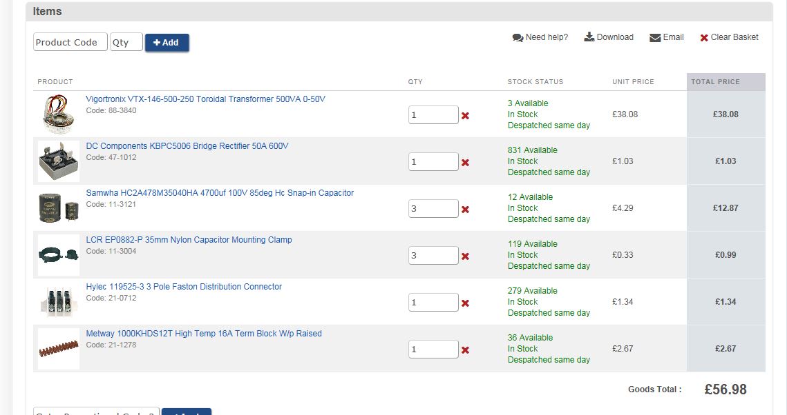

    Joe on here as done a nice vid
    https://www.youtube.com/watch?<br />...zD30sZjtp_VyqYClick image for larger version.
Name:	power supply.JPG

    Follow Clive's link to Joe's setup.
