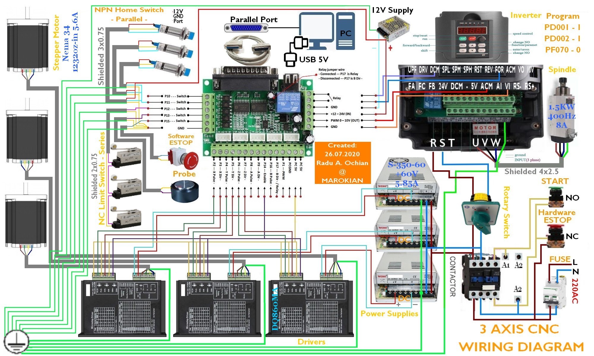

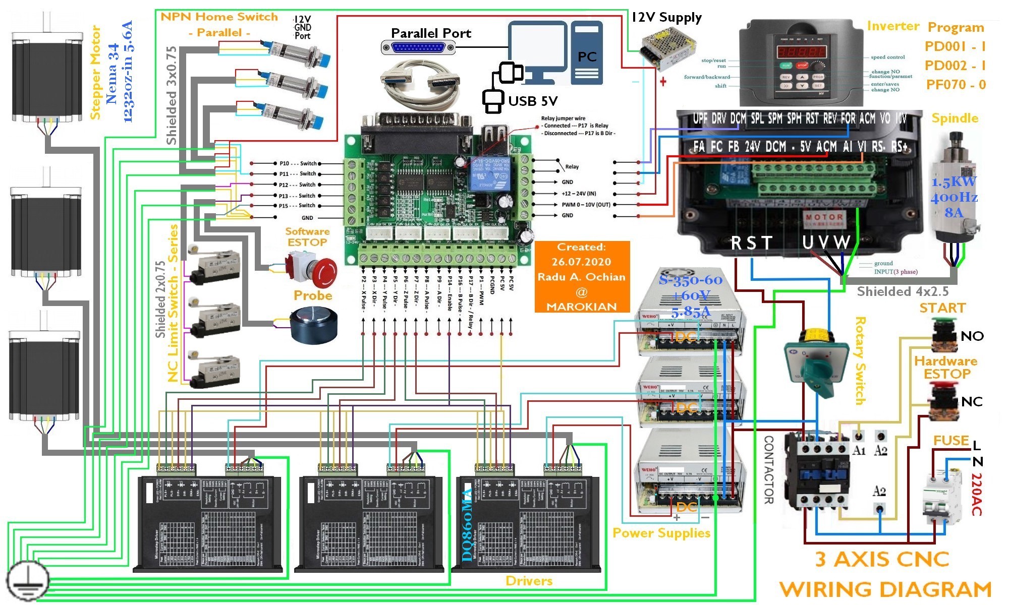

    I've put together a wiring diagram which contains most, if not all, components necessary for building a basic 3 axis cnc.
    Feel free to let me know if I have done any mistakes in it, and hope it is of use to someone in here.
