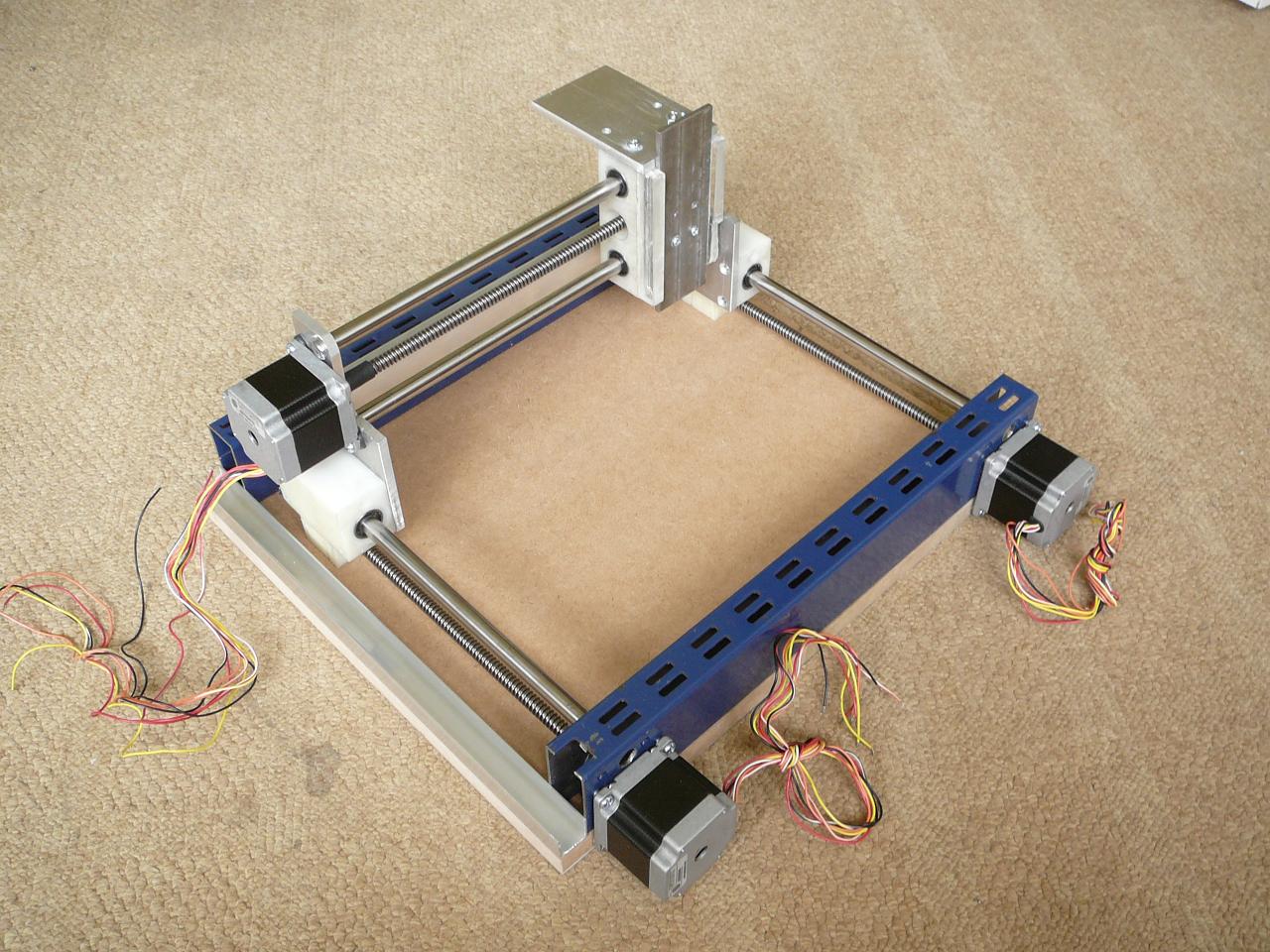

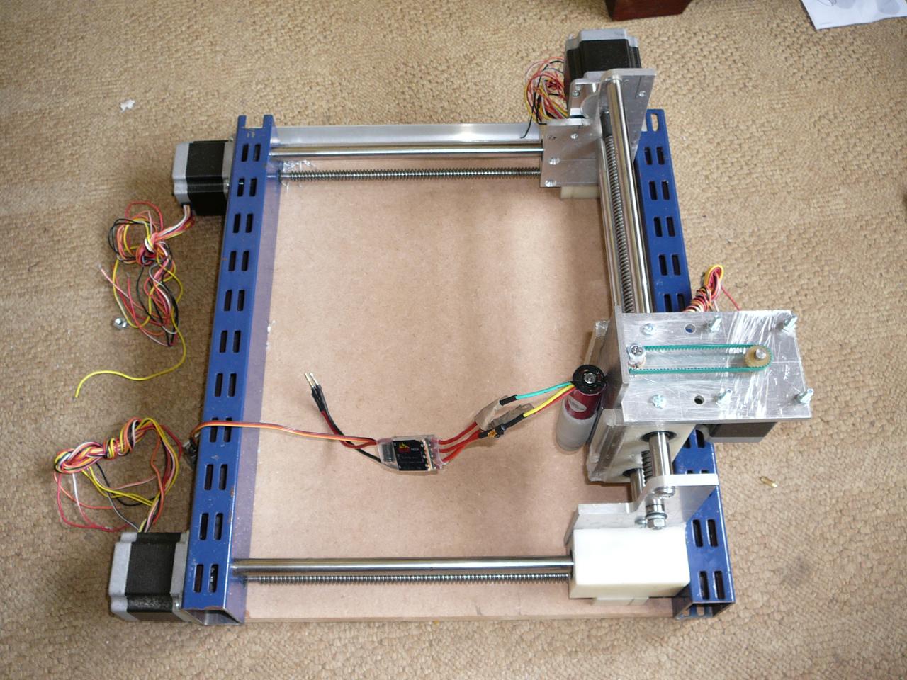

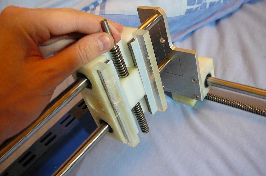

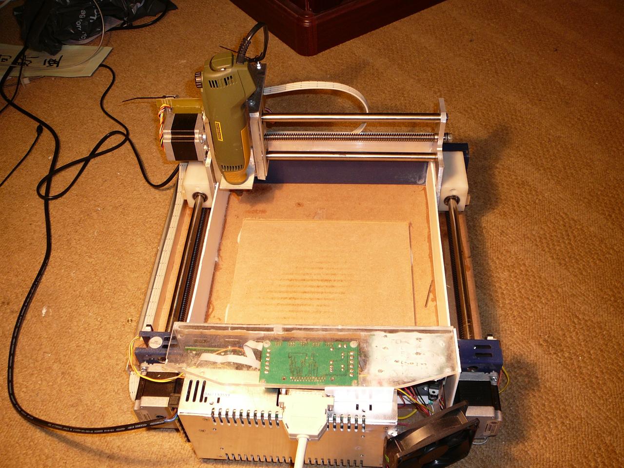

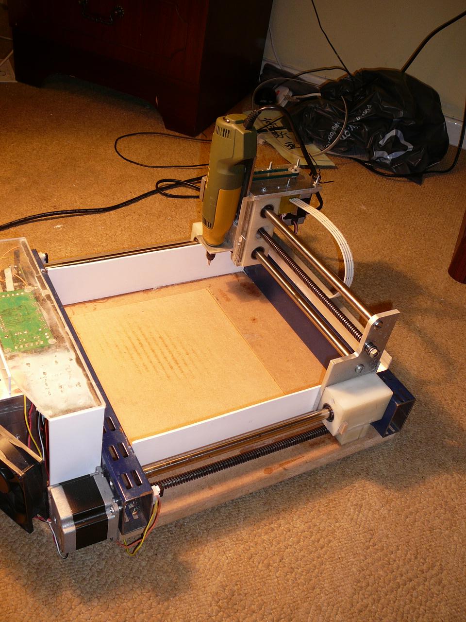

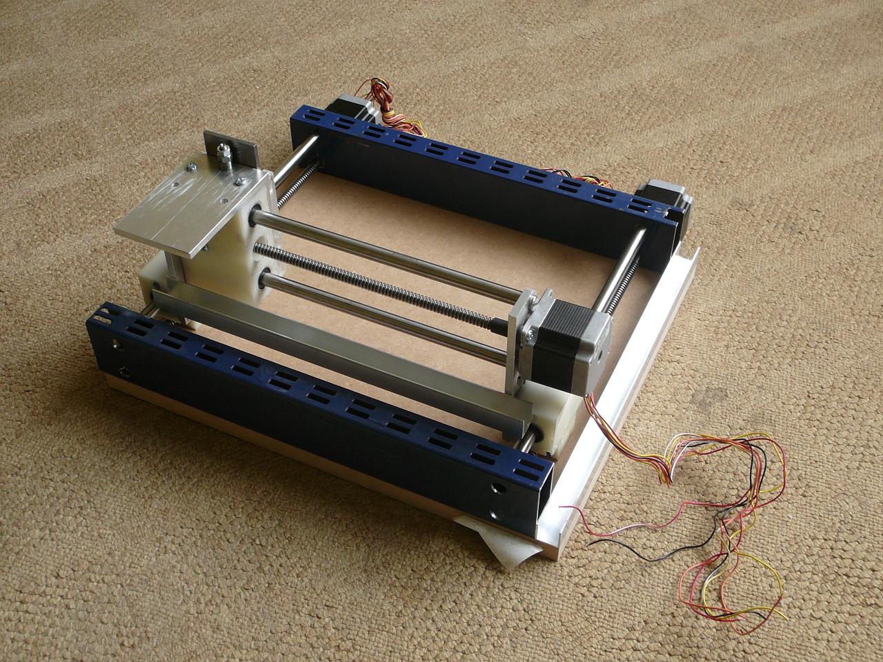

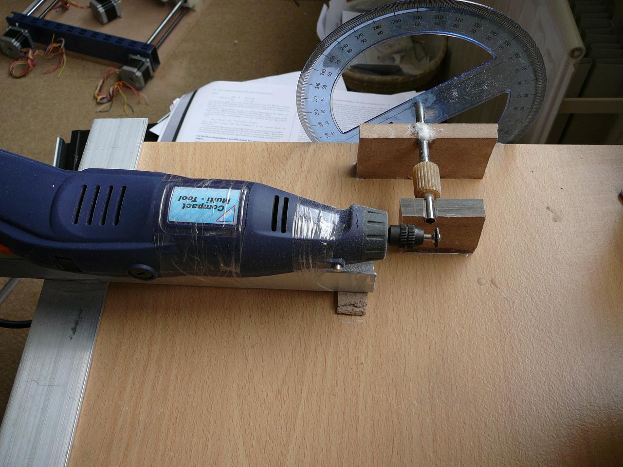

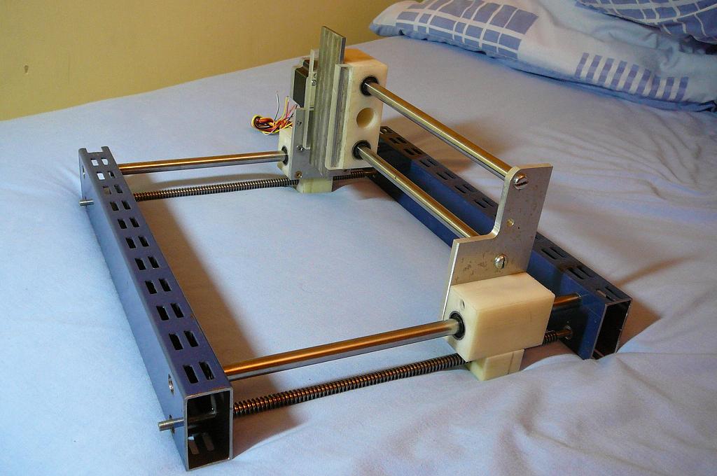

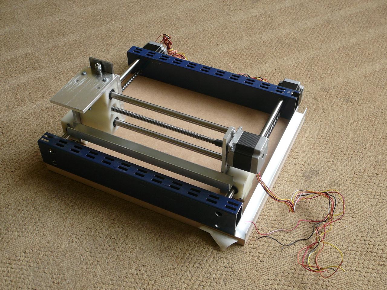

    The machine was designed for wood, plastic, soft metalls,
    working envelope 200*230*65mm

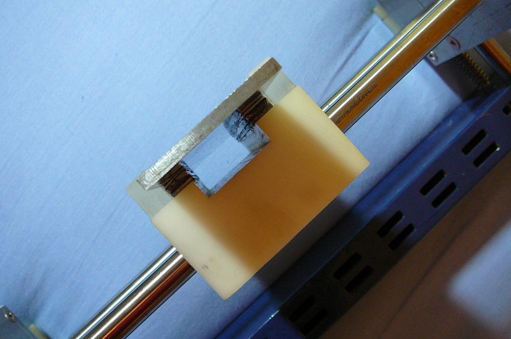

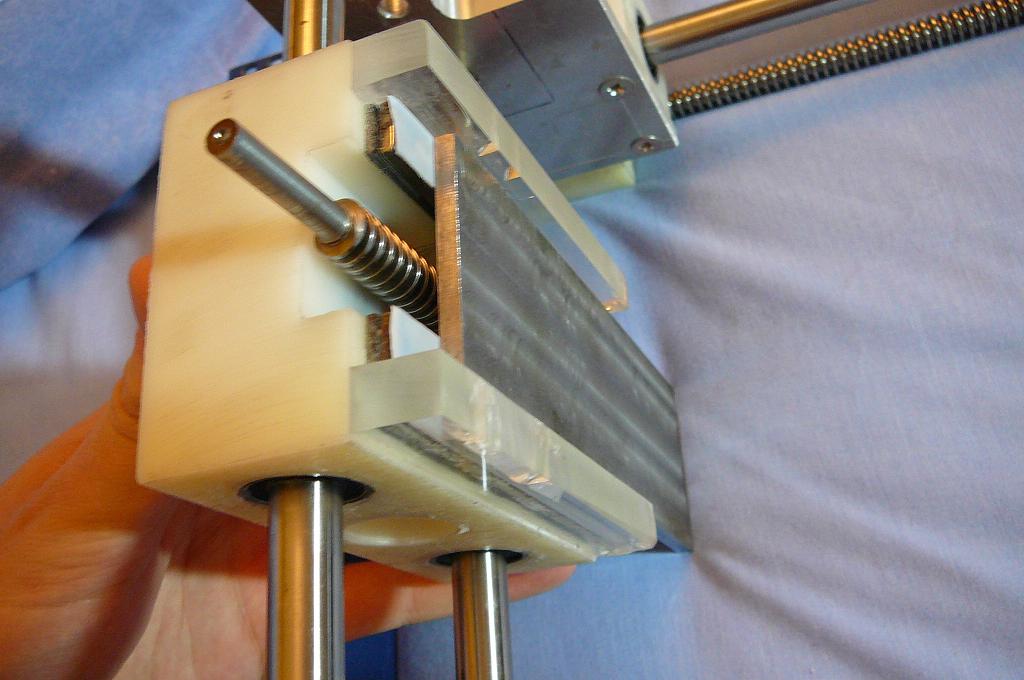

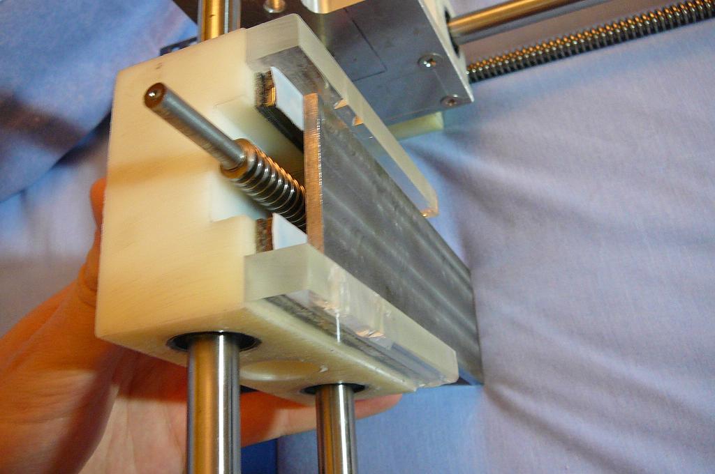

    fancy solution (miiiinnnneee :) ))) of Z-axis - neodymium magnets + Teflon as the slides and polished metal plate. the force required to tear it off - 20kg, to slide it - 2 kg, works pretty fine, no backlash at all ;) .
    a bit of history in pictures, + work done so far.

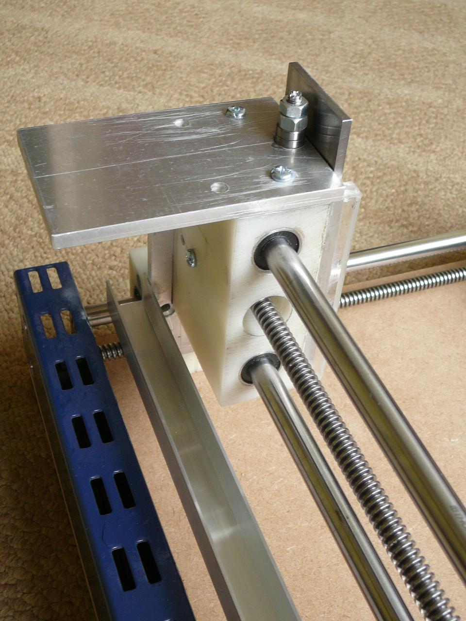

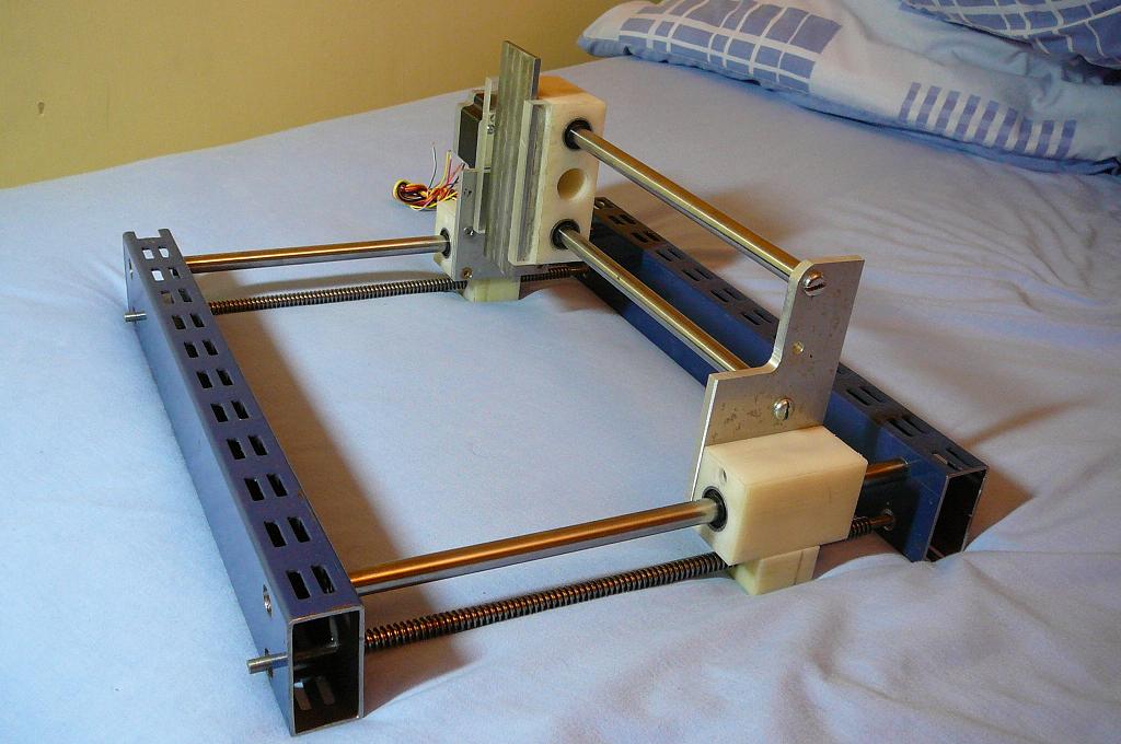

    X, Y axis - built using hardened 300mm D=12mm Thompson rods,
    linear ball bearings, plastic bushings,
    tools used for the build - lathe, milling machine, drilling machine, digital calliper, common sense.

  2. Z-axis - neodymium magnets + Teflon as the slides and polished metal plate.
    Great idea (although be careful not to generate any steel or magnetic swarf)
    I wonder if it'd be possible to build a roller/ball slide using a similar technique???
    yes, it would be not a problem, but we would loose the main advantage - Simplicity:)
    Any way lets say that we use at least 10kg*cm motors and screws of about 4mm pitch - that means a reduction from 2*Pi*1cm to 0.4cm = 15 - which means for a perfect screw you'd have a 150kg moment of force, those 2kg required for friction will simply disappear.
    I'd place roller and magnet only where you need taking off and placing back the carriages.

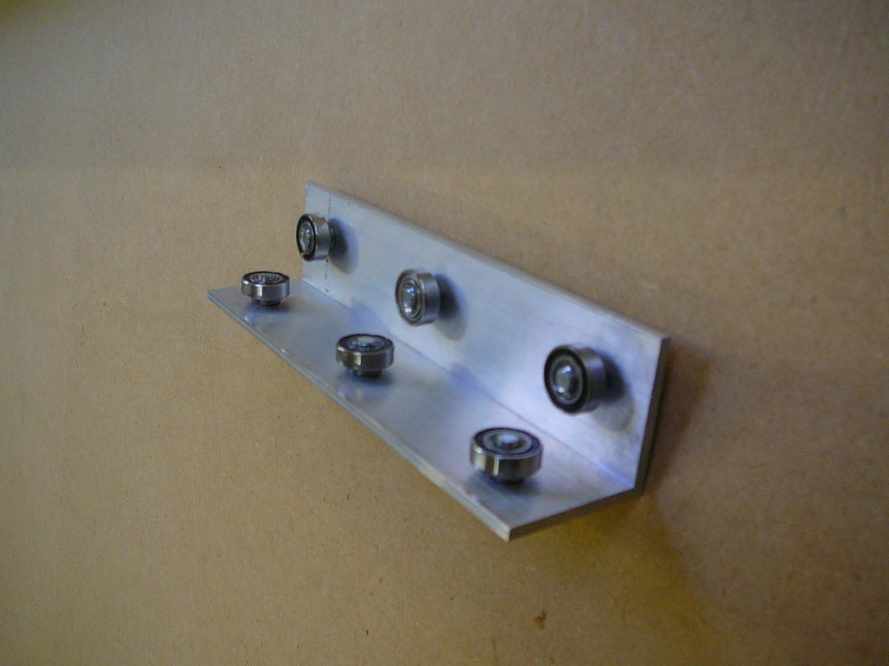

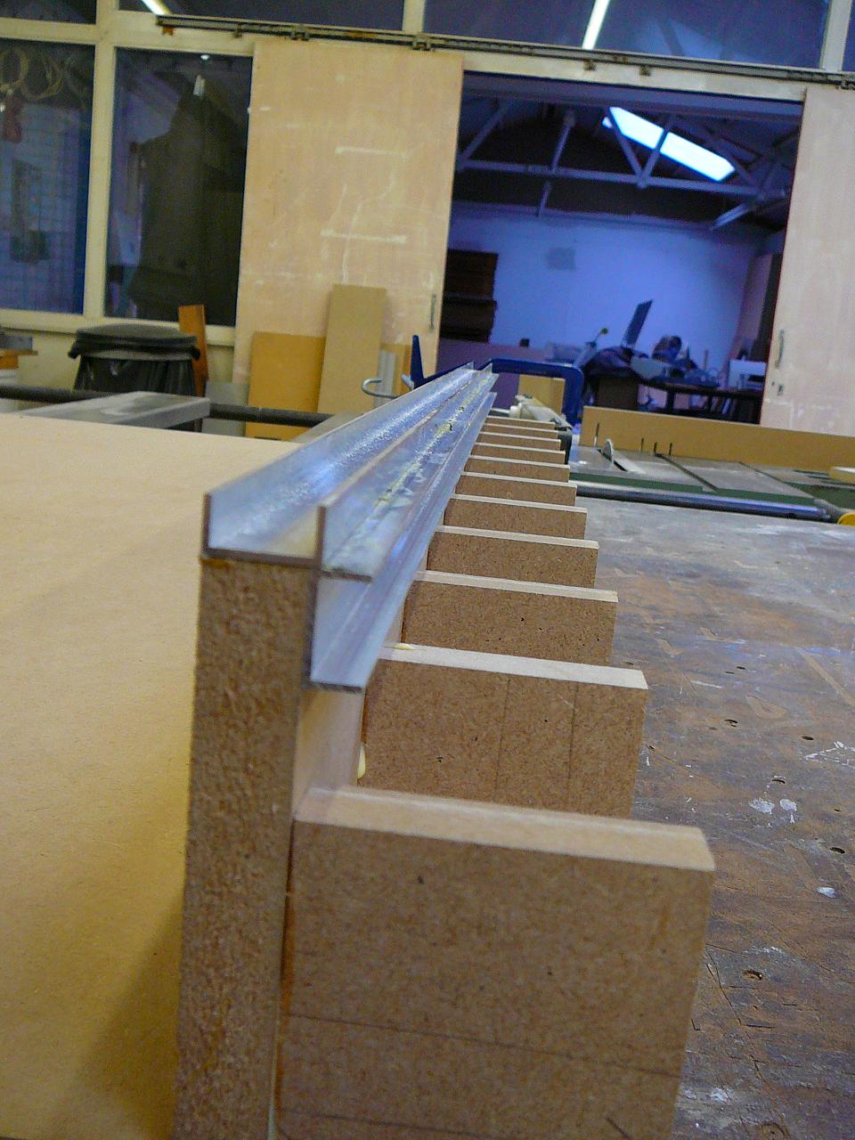

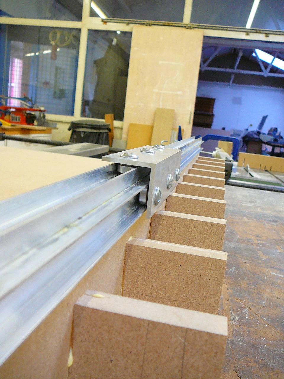

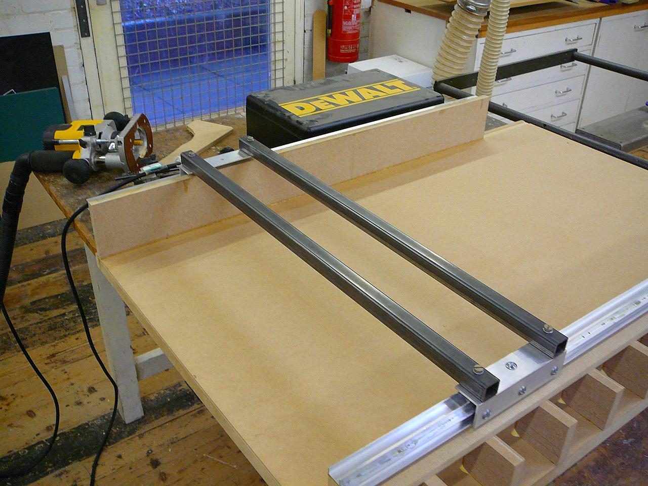

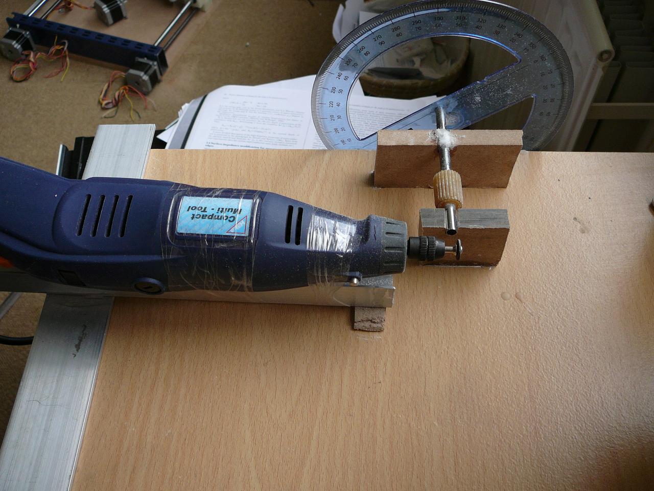

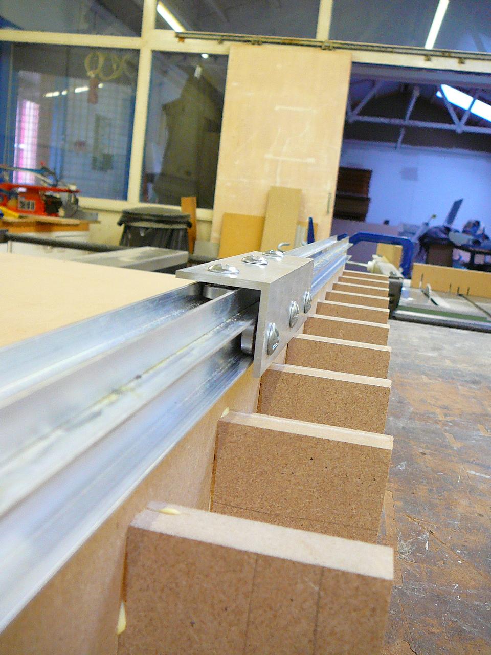

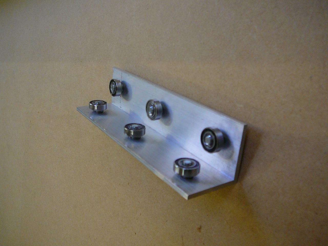

    Oh - by the way my Mark 1 machine was MDF based router. I've made them like that:

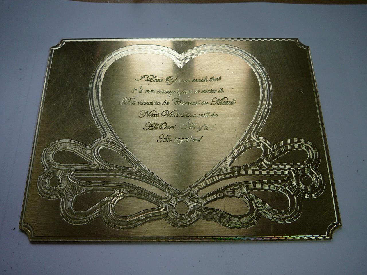

    Looks like you have quite a bit of chatter going on from the looks of the engraving, too much unsupported railage. Totally mad and wonderful idea tho, love it.
    Jeff.
    well - that was 140 grams valentine greeting. Sad that this is now my Ex GF.
    but as Italians say never run for a train or a woman, next one always come.
