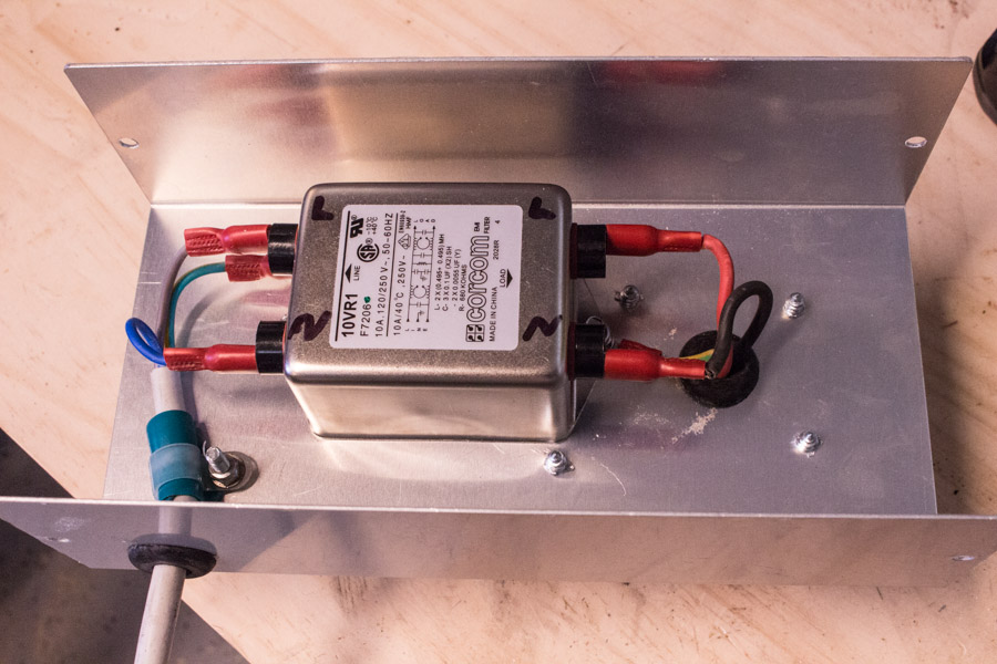

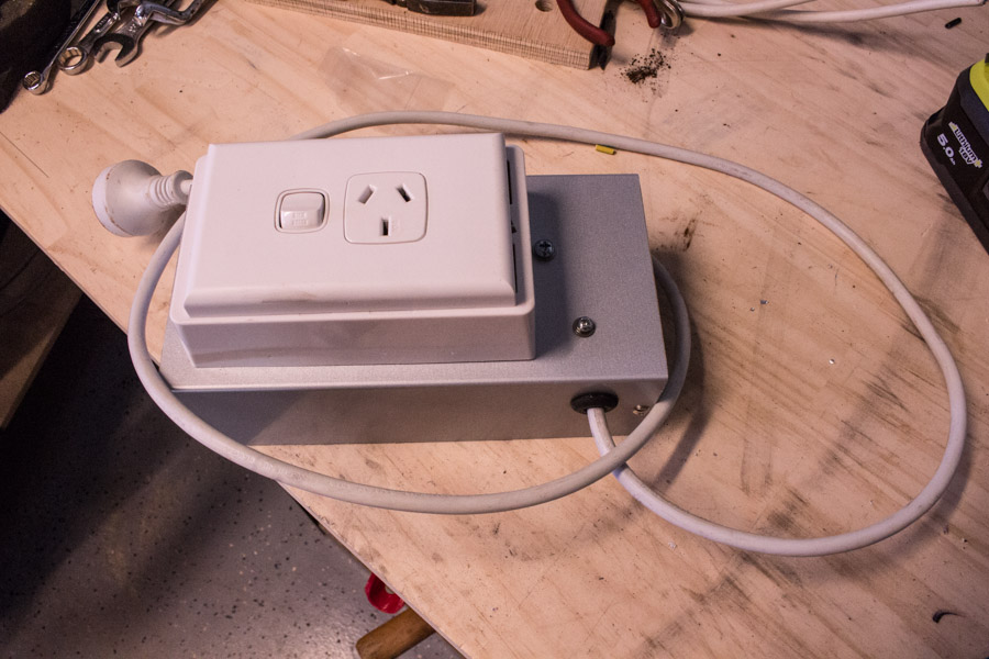

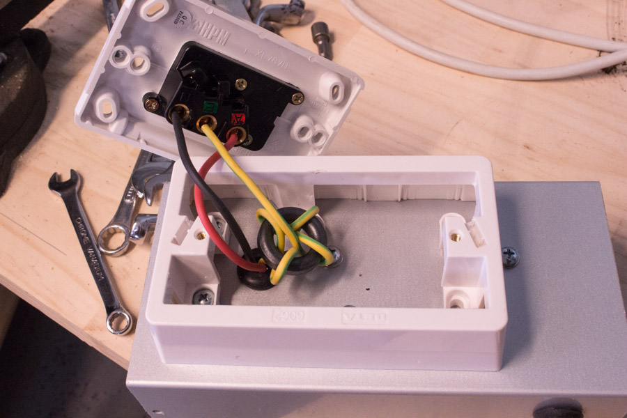

    I've fitted the mains filter and installed it in the machine. I can now power the whole beast including the controlling PC running LinuxCNC, controller with BOB, stepper controllers and motor supplies, water pump and VFD from a single mains socket. I haven't yet got the scope out to see how much noise is still visible on the controller wiring but at least it works!
    The filter is a standard, two stage filter from RS which I linked to earlier. I've also added a ferrite ring to the earth wire since this is a probable route for high frequency noise to escape.

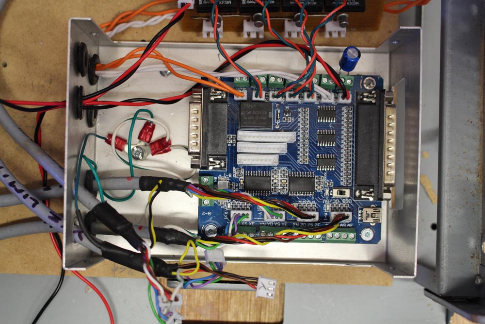

    5V for the BoB and 12V for fans is provided by the original PC power supply.
    Attachment 28709
    Kit, you're one person on here that I really wouldn't want to teach how to suck an egg. But that picture of your BoB - firstly addresses on solution that crossed my mind - you're trying to smooth the supply to the BoB with that cap hanging off the PSU (I would suggest a low esr cap in parallel with the floating electrolytic - but there'll be enough of that on the board anyway)... so that's all good. But, the one thing that does worry me is I can't see any isolation on the BoB (in the form of opto-isolators). It could be a different package that I'm used to - but the geographic positioning of devices on the board doesn't appear to support that. You say you're using relays on the inputs - I can't see the detail of this in the figure, but assume you're using a NC or NO contact?, hopefully you have it that in the non-triggered state the input is hard-tied to ground? (i.e. not floating?). Have you the connectivity to use a C/O contact between 0V and 5V, so the inputs are hard-tied in both states? Also, I've experienced so much crap with proxy diagnosis of noise on BoB inputs that I wouldn't now entertain any without opto-isolated inputs. Not for the galvanic isolation, but simply it's good to have a device that needs proper current flowing to switch, rather than the usual HCT high-impendance inputs. From the UK I'd be throwing 6 quid at China for a cheap replacement BoB to trial.
    Again - I'm confident you know what you're doing, and you sound like you're addressing this top-down with removing noise from source, just worth conisidering going bottom-up and looking at the noise susceptibility on the signalling to the PC.

    Thanks for the words of encouragement and I'm open to any advice anyone wants to offer! More decoupling of the BOB power supply is worth looking at but the VFD noise is all over everything so there's something more fundamental at work here.
    The problems I've always had with this machine show up as a limit switch trip on the Z axis. It all started when I changed from microswitches to proximity sensors. Oscilloscope measurements showed lots of spikey noise on the limit inputs of the cheapo Chinese BOB but I ruled out the individual proxy sensor early on. There's a whole thread about this from last year. http://www.mycncuk.com/threads/13519...-problem/page2 post #20 explains what I discovered about the input circuits to the BOB.
    The solution then was to use electro-mechanical isolators. Sounds much better to young ears than 'relay' but that's what I used. Miniature relays hold the inputs solidly to ground except when the proxy sensors trigger. Excelent noise supression and low-pass filtering in one simple package. The relays and driver transistors are mounted on a board which sits just above the BOB with only a few mm of wiring between them.
    There is only any noise present when the VFD starts and the noise is all over everything. The earthed box of the controller and all it's contents including the BOB power supply rails and the earthed cases of the motor PSUs as well as the BOB inputs/outputs show it. I even tried shorting the scope probe to it's own earth screen clip and you can still see the noise when the earthed probe touches anything metal! It's a PC scope and I use it on my laptop running on batteries so the scope is entirely isolated from ther mains.
    last year I rebuilt the controller with the BOB in it's own ally box with screened cables for all signals in and out and individual screened cables for each proxy sensor and each stepper motor. I really thought I'd done evrything right and it was working OK until the recent rebuild. The noise is very short pulses of about 1uS each. Closer inspections shows each pulse to be something ringing at about 6MHz for that short period. It's not just the VFD output waveform to the spindle windings and I'd love to find out what it is but I'd much rather be making stuff with the machine than fault-finding it again.
    I really thought the mains filter would fix it, especially after plugging the VFD into a different mains socket fixed everything but it seems the filter doesn't work as reliably as a few metres of 3-core wiring. The only other possibility is that particular input of the parallel port into the PC is dodgy but that seems a long shot, though I'm convinced it is not spurious triggering of the solidly earthed limit switch input so something else is triggering that specific port input to the PC. It's always the same one.

    Kit, your last response does concern me - if you remove the "electromechanical galvanic isolation module" from the Z-limit input to the bob, and simply connect this input to the local 0V, is it still noisy? If so you're down to BoB/Cable/PC.
