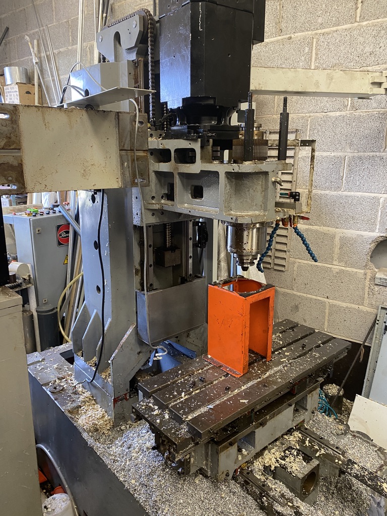

    have i bit off more than i can chew...maybe time will tell
    i wanted a bigger mill , i currently have a denford triac atc running off mach3 which i will end up selling .
    so i bought from a friend a far too big vmc for my home garage .
    it has a 7.5kw spindle 3ph
    control techniques vfd
    centroid m400 controls
    bt40 atc
    centroid servo motors
    linear guides
    rtk3 control board
    32mm lead screws
    etc.
    unfortunately the base and z tower castings are massive
    knowing it was physically too big the plan was too break it down ,
    cannibalise the parts i could reuse and build myself a machine from scratch with 240v 1ph supply .
    so i will need to build a frame to mount the y axis and z axis on
    i plan to use the original table with the original x axis
    so i will need some help in the design ,im in no rush i suspect it will be a year or so before its finished but guidance on the best direction to go in will be a great help .
    i will definitely keep the ball screws linear guides x table . hopefully the servos and their controller if i can modify the rectifier with a big capacitor for 1ph.
    i would like to keep the m400 and rtk3 but i imagine the plc will need modifying by someone who knows their onions .
    but if not maybe centroid acorn and a pc
    i have a feeling the very heavy 7.5kw 3 ph spindle will be too much so that may have to go and something smaller may be required .
    any help
    do's
    don't do's
    would be appreciated
    thanks

    Personally, I think you'd be mad to cannibalize that machine because you'll never build one as good. The parts won't transfer very well as they are sized for a machine that size and will be far too large for a smaller machine. If you really don't have space and can't make space then I would clean it up and sell it on then put the money into a smaller machine with more suitable and modern parts.
    The spindle could be used with a Single- phase to Three-phase VFD, these can be bought from China for a few £100. The rest of it will be 240V single phase or 110v which is easily enough transformed.

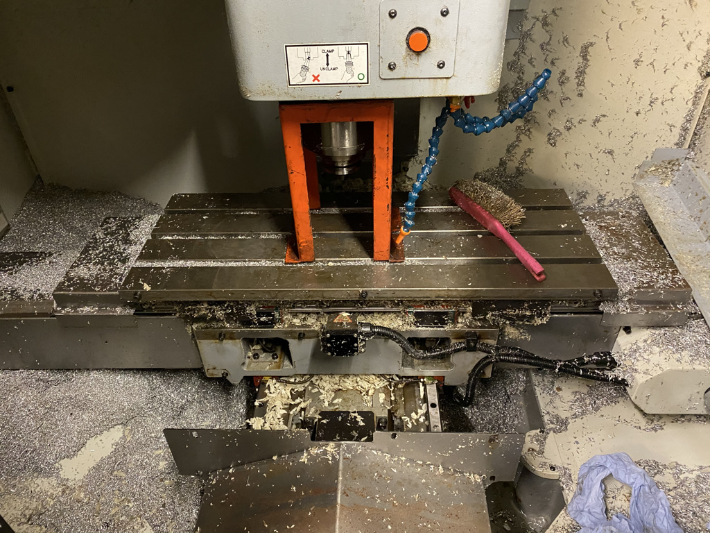

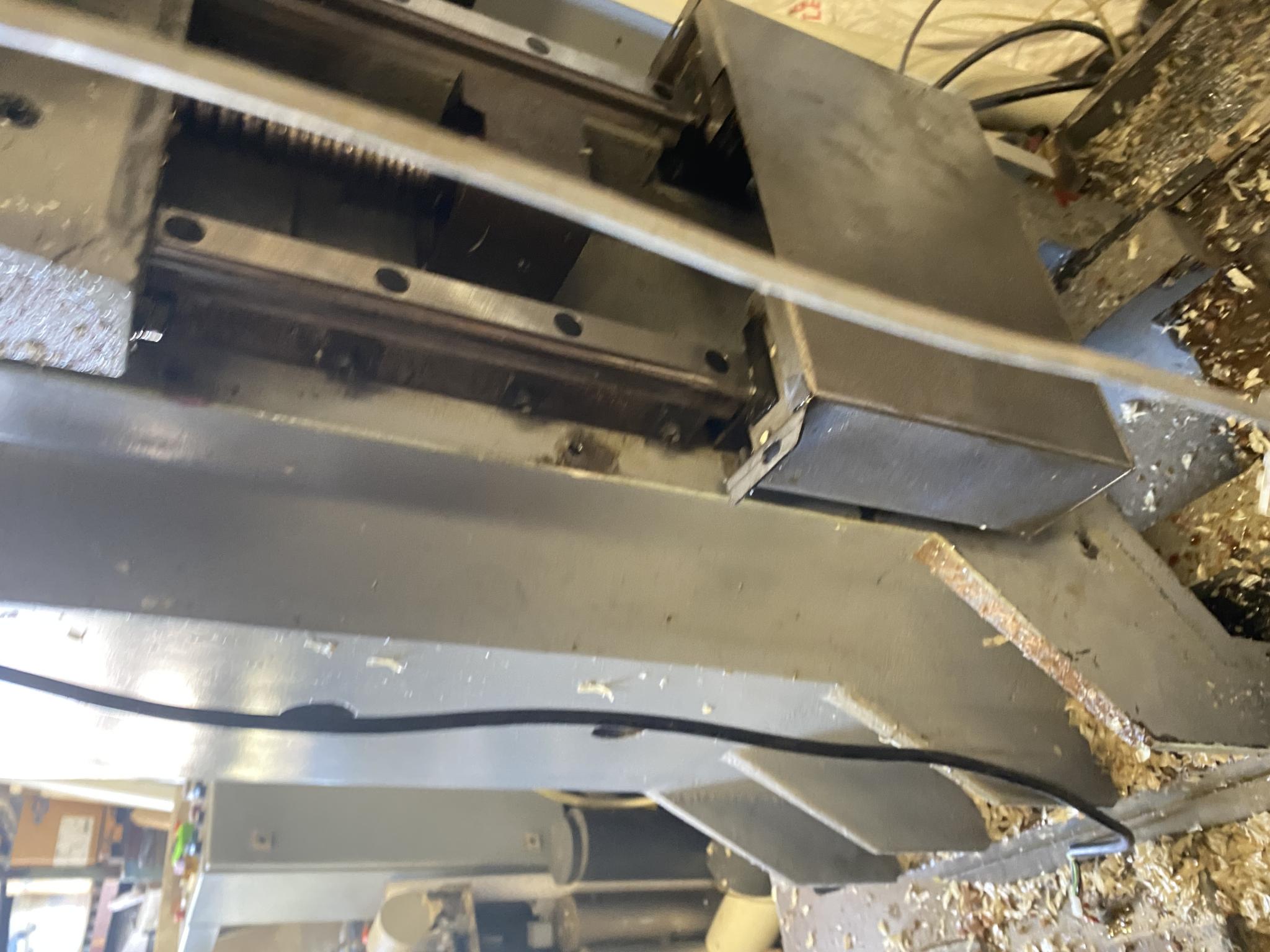

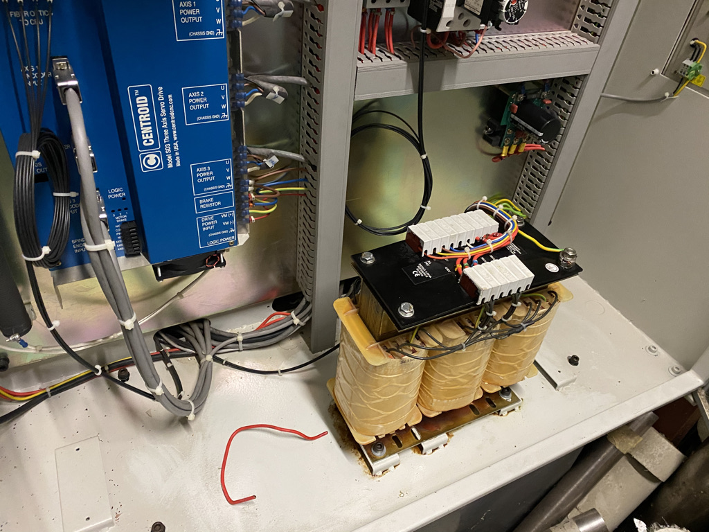

    thanks for the reply its 75% stripped the 4th picture shows the current state . So already past the point of no return . i either have the basis of a custom machine . or a load of parts for sale.
    There was initially a problem with the m400 control .
    im comfortable if i only keep the hiwin rails and bearings x carriage bt40 spindle and table and screws to be honest .
    So if i proceed i need to build a frame to build off as a starting point so i wondered what the best plan of attack was for that as a starter
    do's and dont's
    thanks
    Quote Originally Posted by iamspuddy View Post
    do's and dont's
    Well, I still say the Do's are Don't do it.!! It wouldn't be a large effort to put back together in comparison to building a new chassis, most of what's missing is just sheet metal which you would remove anyway if was renovating the machine.
    Honestly, I don't think you realize the work that will be involved to get anything close to the strength and accuracy that machine will offer you.
