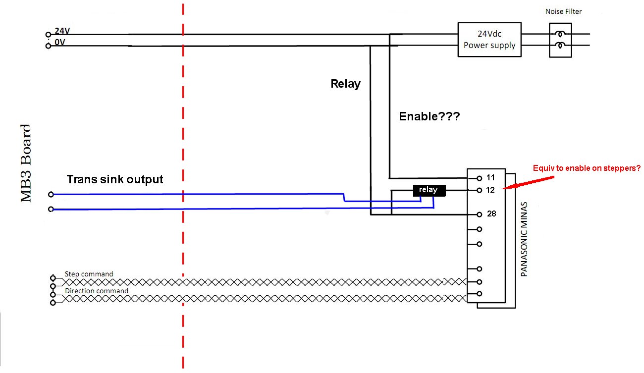

    OK - saw another diagram in the MB3 documentation that I *think* helped me. This is what I have:
    Do I need more? Or should the the 24v going to the controller be sunk to a ground like the cabinet chasis frame (with a relay)? Like the old 2 stroke motorbikes?

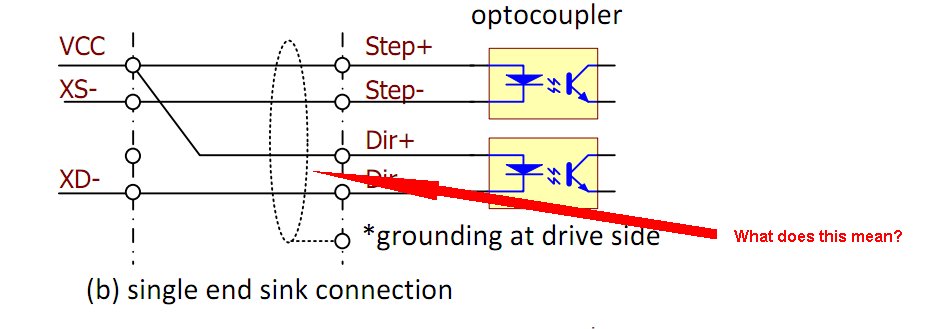

    I am also struggling with:
    Any help is really appreciated

    Your diagram is a little confusing - thoughI think I know what you're trying to do.
    It's F1 Qualifying on TV just now - and hour for me to snooze, I'll sketch something for you after that.
    The indicated dotted ellipse - that's indicating a screen on the cable to reduce EMI (often a braided sheaf under the first layer of insulation).
    The question on pin 12 - "Equiv to EN on servos" - kinda - but it's more the command to the servo controller to start/enable the servo. It looks to be pulled low to be active. Page 11 indicates the internal equivalent circuit - another example where you can use the open collector output from the MB03 directly (no need for a relay).

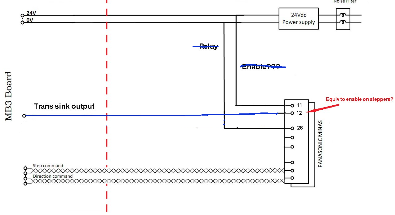

    This is how I'd be connecting the MB3 to the servo controller...
Name:	Screenshot 2020-08-29 at 15.40.01.png
    So, you have a common 24V supply to the Servo controller and the MB3 card. That's all good. The internal circuitry of the Servo controller, as page 11 ...

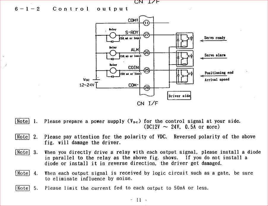

    Okay, if you'll forgive the explanation. The information in the manual is accurate, but again, doesn't particularly try to educate the reader. I think you're looking at 2 + 2 and getting 5 - please don't be offended by that.
    Note 2 in the diagram ("Please pay attention for the polarity of VDC. Reversed polarity of the above fig. will damage the driver") is to ensure that you connect 11 and 28 to +V and ground, respectively. You *could* put a diode in series with one of these, but to get the diode right you pretty much have to have wired it correctly anyway. So to me the diode is a little superflouous.
    Note 3 in the diagram ("When you directly drive a relay with each output signal, please install a diode in parallel to the relay as the above fig. shows. If you do not install a diode or install it in reverse direction, the driver get damaged") refers to a completely different beast. Inductive loads (the relay coil is one) have a behaviour which, energised creates a magnetic field (in fact, that's how the relay switches - it's an electromagnet that attracts the contactor that provides the electrical switch). When the driving power is removed from the coil, the electromagnetic field collapses, inducing a voltage into the coil of the relay. This flows in reverse and is proportional to the speed at which the driving current is removed - fast = big voltage. This can present a voltage at the OUTPUT of the servo controller that far exceeds the 24V you've connected, and destroy the circuitry. The purpose of the diodes in the diagram you included essentially clamps that current flow between the coil and the diode - safeguarding the servo controller.
    So, in that diagram, the diodes are not really to protect wrong polarity, but to protect the servo controller from what's referred to as back EMF.

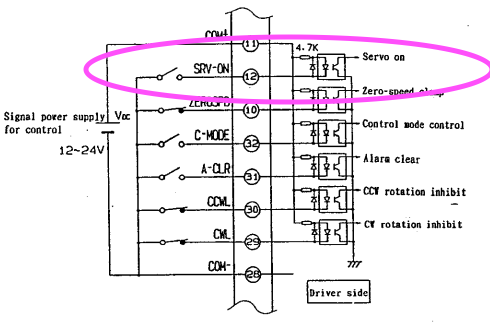

    So looking at the Servo On diagram you posted... then looking at this:
    Attachment 28763
    Then I just do the same for the other pins and make the hi or low accordingly?
    Every time I am wrong - the World makes a little less sense.

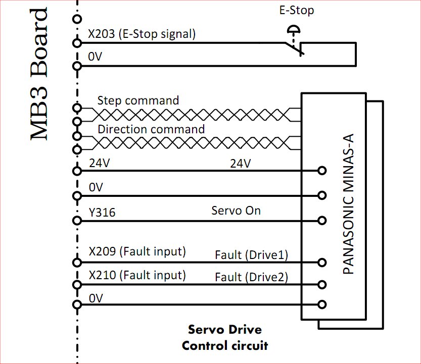

    I found this for a MB3 to a panasonic A series.
    Seems literally just the "servo on" for that one - as you posted in the modified picture.
