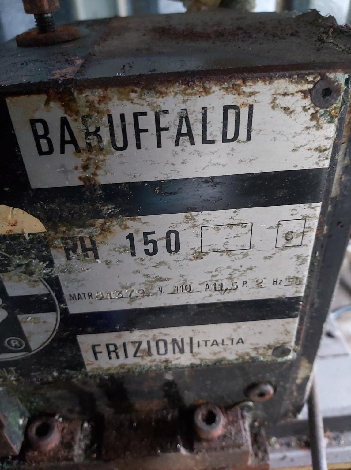

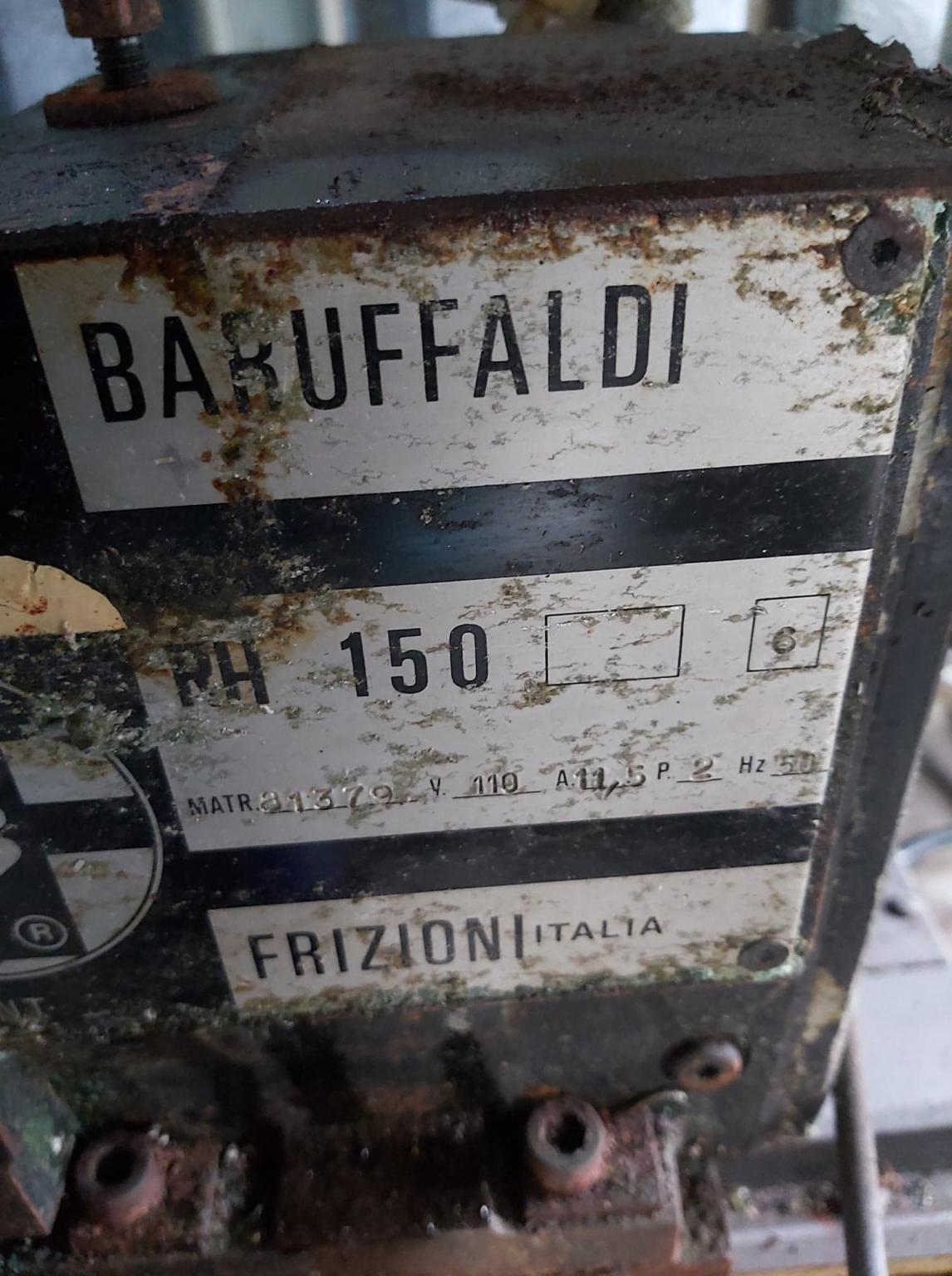

    its fitted with a baruffaldi RH150, 6 position turret.
    173e collet chuck and autoblok hydraulic drawbar actuator

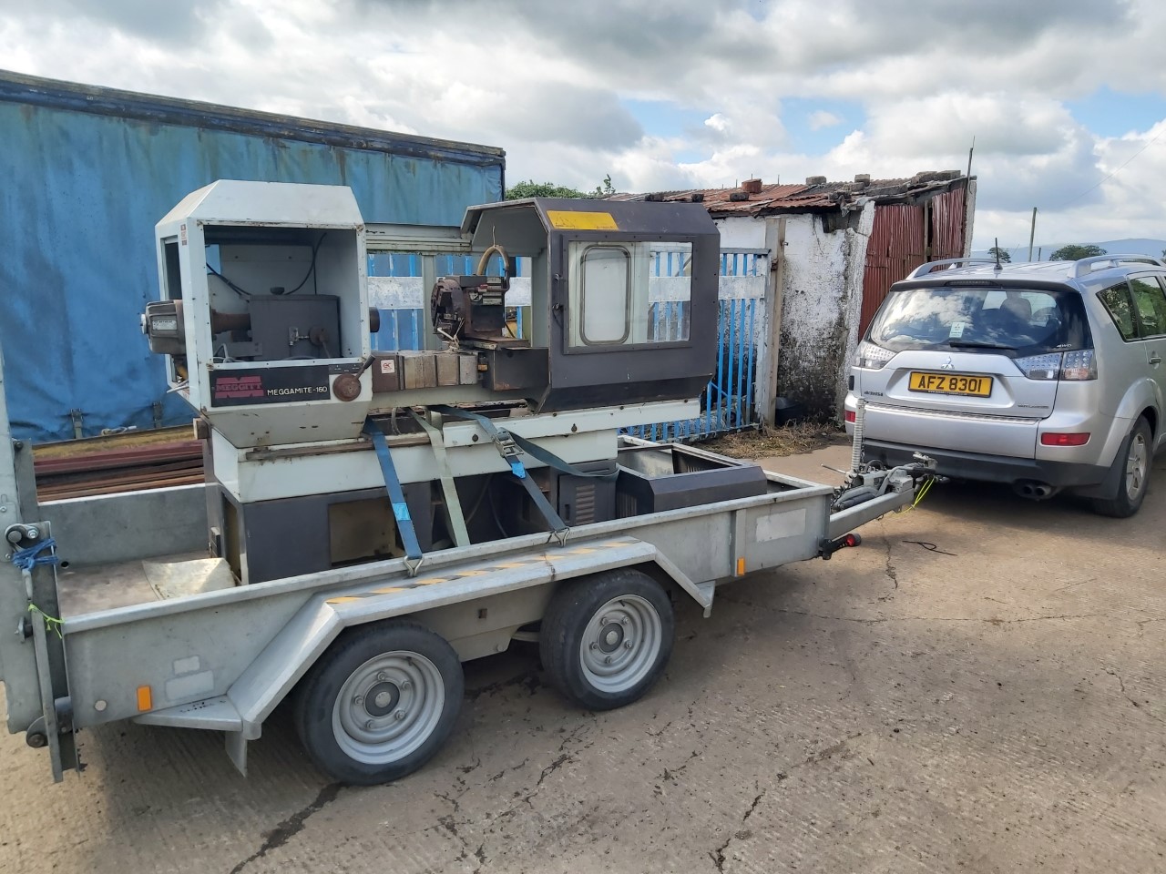

    I bet you took the corners slow on the way home!

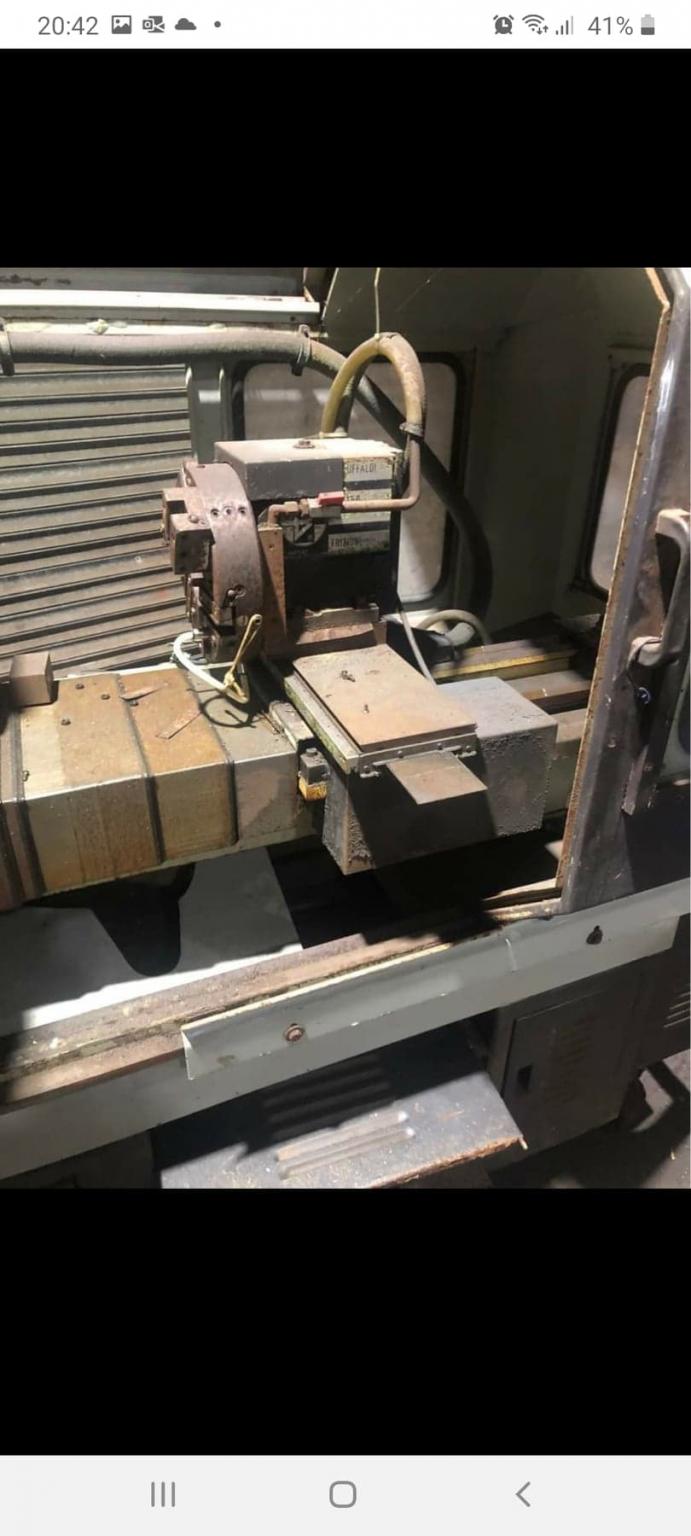

    well ive never seen a lathe this age with straight original way covers, they are in excellent condition.
    that and the paintwork inside the enclosure is mostly intact. this machine must have spent the vast majority its life in hibernation.
    lucky enough it was mostly motorway/dual carriageway the whole way so was plain sailing. just took it easy.

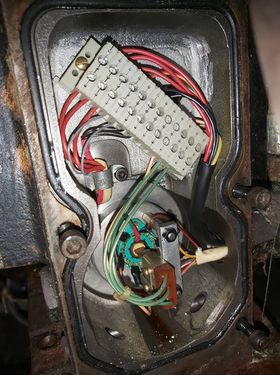

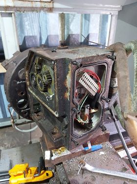

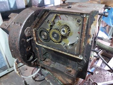

    im stuck between centroid acorn & centroid 12 and mesa 7i98 & linuxcnc for control. the biggest sticking point for me is driving the turret.
    i know from reading up on linuxcnc that i could (with some difficulty) write a custom hal component to drive the turret. really not sure what centroid requires. suppose its a macro akin to mach3?
    think i would prefer centroid for its conversational aspect. otherwise i wouldn't consider it

    anyone using centroid with a turret like this? anyone using turrets like this with any other softwares?
