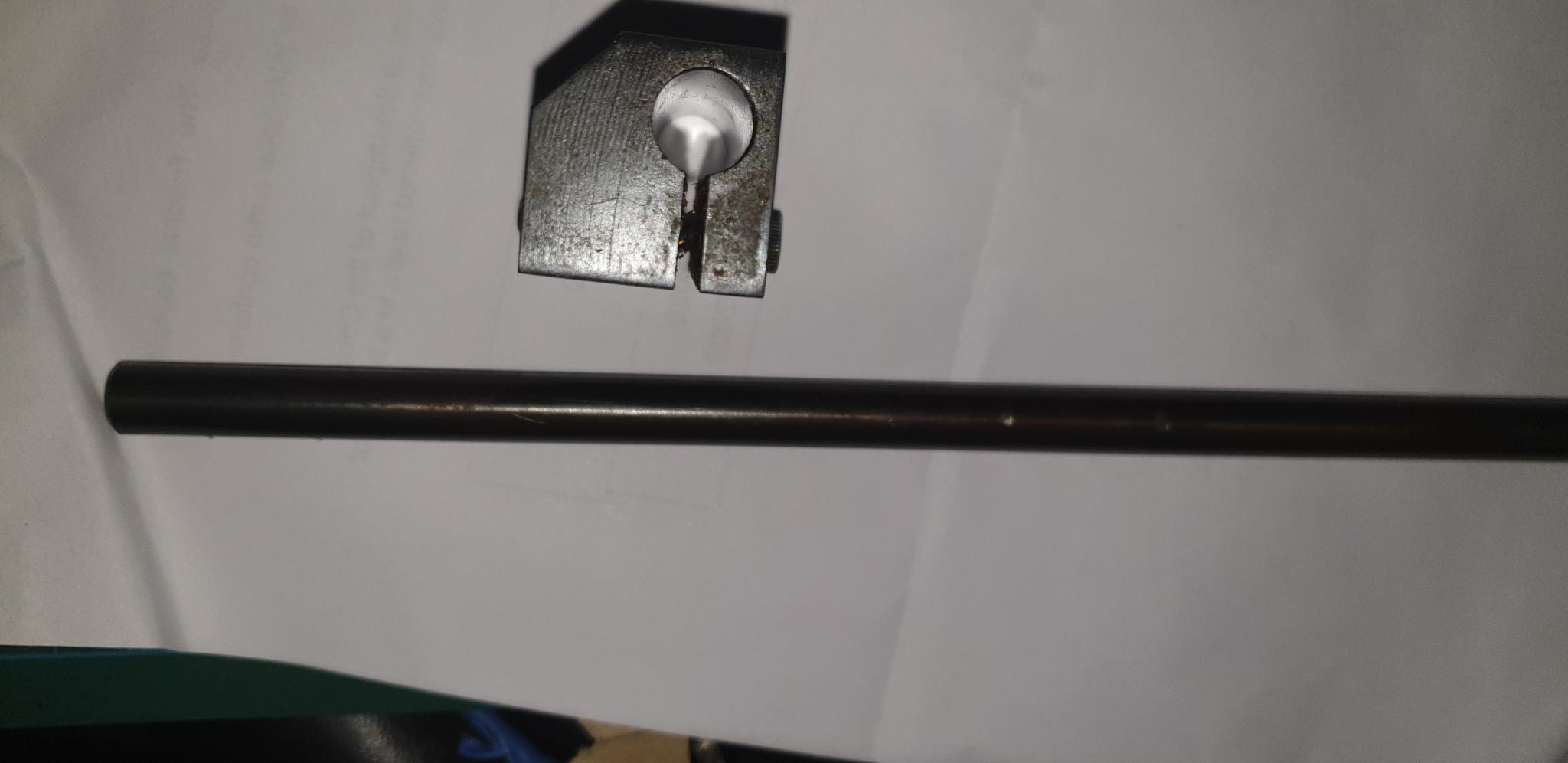

    Limits looks like someone's borrowed a part or 2 off the z limit, the black switch just behind the chuck and in line with the top of the z axis is your z limit switch, on top of the axis are a couple of holes this is where the limit switch adj rod fits Yours seems to be either invisible or missing. Operate the switch a couple of times with your finger as they some times get stuck, on the righthand side of the front your lathe is a hole with 4 3mm threaded holes around it, there should be a plate with a switch on it, which allows you to jog off z if the limit switch is on. Don't worry about that now i put it there as i might have forgot to do it later.

    Do you have a pic of what the rod should look like so I can produce something similar.

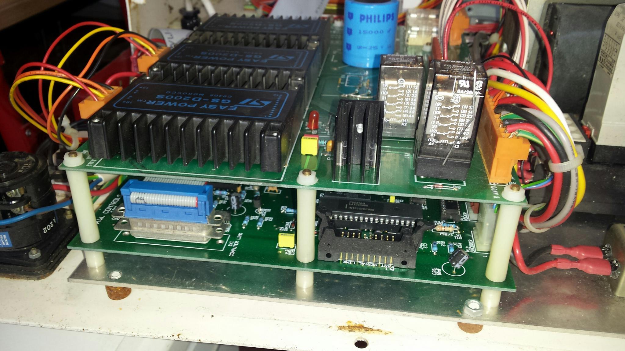

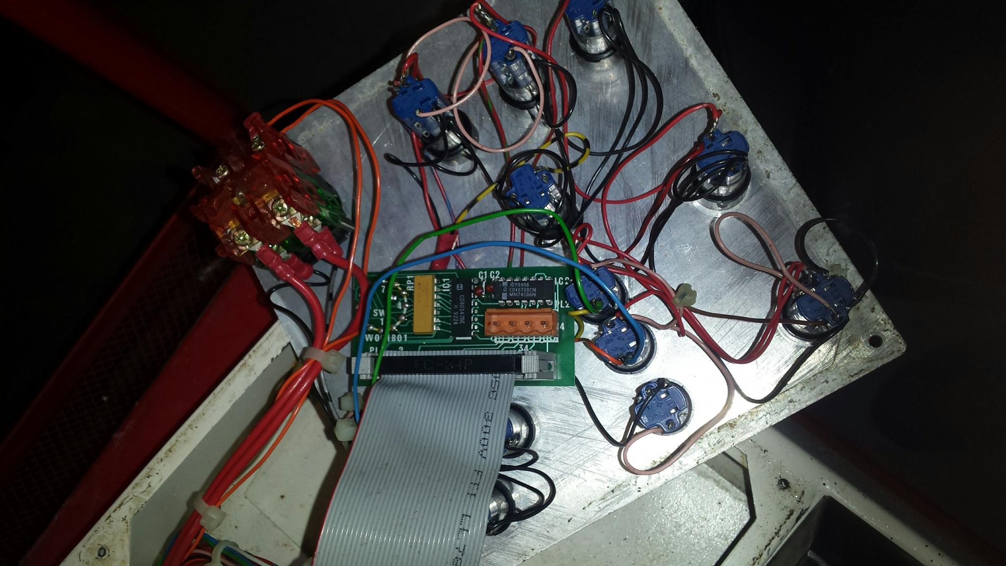

    Some pics as requested

    Am in the process of checking continuity through switches ( they certainly didnt stint on interlocks) and looks like there are two circuits
    Would be nice to have a wiring circuit for interlocks to be able to test end to end .. I cant see where these are connected to the panel

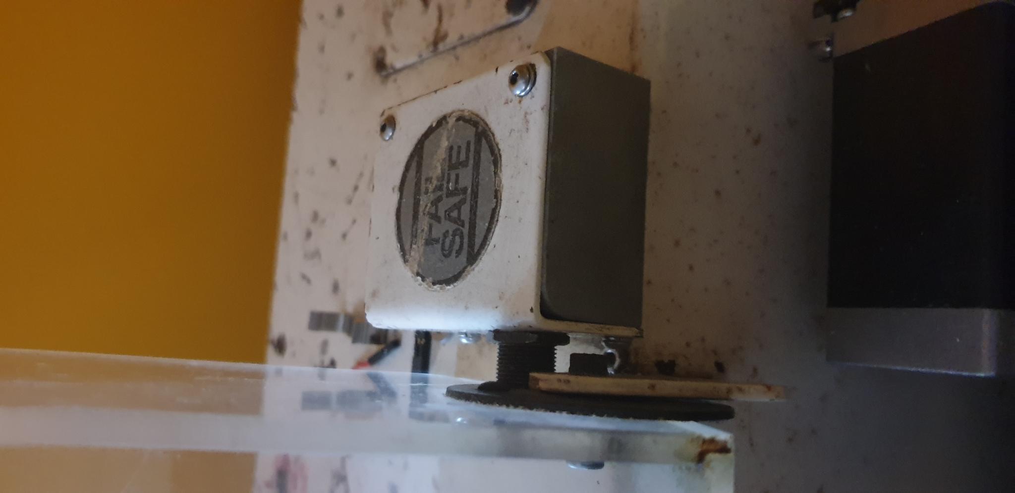

    Door to spindle drive belts seems to have 3. A button switch at opening end seems to have been disconnected, ball switch at hinge end has two microswitches.
    Have linked out the suspect ball switch on perspex cover although it does seem to be operating, but still no joy with traverses ,with manual on or Off.

    I get the principle on the x limit Inee . I can probably rig one of those .
    Am replacing the micro in my Fail safe switch . Seems to be switching but no positive click so I dont have a lot of confidence in it ,.
    Where is the ring of interlocks connected to the boards . Wires are hard to trace with all the zip ties they have used.

    Cant remember where they connect on the board, what i did when i first got mine was to remove the cable ties and replace em loosely unit i got to the wires i was following, bloody tedious but i got there in the end, i loosely replaced em as it was easier to trace other wires.
    just had a look at one of your pics to me it looks like the interlocks are wired to the top board in positions 7 and 8 of the connector which mostly went to the speed controller, havwe a look at one of your images I'm reposting, I've added a yellow circle is the wire in the yellow ring broken(orange wire).
    Dead quick check is do a continuity test between those 2 orange wires pin 7 and 8.. if you get no joy try a check between one pin and every wire in the ceramic connector then try the other pin.
