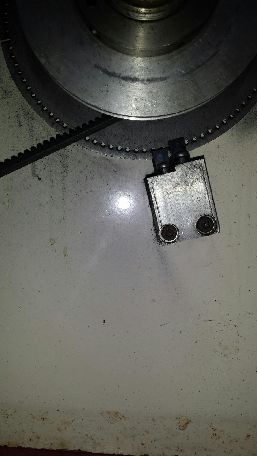

    Limits looks like someone's borrowed a part or 2 off the z limit, the black switch just behind the chuck and in line with the top of the z axis is your z limit switch, on top of the axis are a couple of holes this is where the limit switch adj rod fits Yours seems to be either invisible or missing. Operate the switch a couple of times with your finger as they some times get stuck, on the righthand side of the front your lathe is a hole with 4 3mm threaded holes around it, there should be a plate with a switch on it, which allows you to jog off z if the limit switch is on. Don't worry about that now i put it there as i might have forgot to do it later.
    If you remove the Boxford plate on the l/h front side it will give you access to the limit switch wires, and the wires for the index and position wires
    Don't connect to pc just yet, as it's better to check things work, It does look like someone converted it in the past what to your guess is a good as mine.

    Do you have a pic of what the rod should look like so I can produce something similar.
    Most of the limit buttons seem to have a healthy click but the ball switch , RH side back of the perspex guard has no click at all so doesnt sound to be switching anything. I will take it off and check it out but it looks like I need to remove the fan to get at the switch fixings.
    Is there a limit on the X traverse ? I dont see one.
    While I am checking these I will take and post pics of the things you asked for .

    Am in the process of checking continuity through switches ( they certainly didnt stint on interlocks) and looks like there are two circuits
    Would be nice to have a wiring circuit for interlocks to be able to test end to end .. I cant see where these are connected to the panel
    Door to spindle drive belts seems to have 3. A button switch at opening end seems to have been disconnected, ball switch at hinge end has two microswitches.
    Have linked out the suspect ball switch on perspex cover although it does seem to be operating, but still no joy with traverses ,with manual on or Off.
    Stepper motors and traverses move freely (untill you switch power on and then the motors lock)
    Dont seem to be any homing switches ??
    I f you guys have any wiring diagrams then i would love to see them .

    xis
ID:	28817   Click image for larger version.
    I get the principle on the x limit Inee . I can probably rig one of those .
    Am replacing the micro in my Fail safe switch . Seems to be switching but no positive click so I dont have a lot of confidence in it ,.
    Where is the ring of interlocks connected to the boards . Wires are hard to trace with all the zip ties they have used.

    Cant remember where they connect on the board, what i did when i first got mine was to remove the cable ties and replace em loosely unit i got to the wires i was following, bloody tedious but i got there in the end, i loosely replaced em as it was easier to trace other wires.
    just had a look at one of your pics to me it looks like the interlocks are wired to the top board in positions 7 and 8 of the connector which mostly went to the speed controller, havwe a look at one of your images I'm reposting, I've added a yellow circle is the wire in the yellow ring broken(orange wire).
    Dead quick check is do a continuity test between those 2 orange wires pin 7 and 8.. if you get no joy try a check between one pin and every wire in the ceramic connector then try the other pin.
