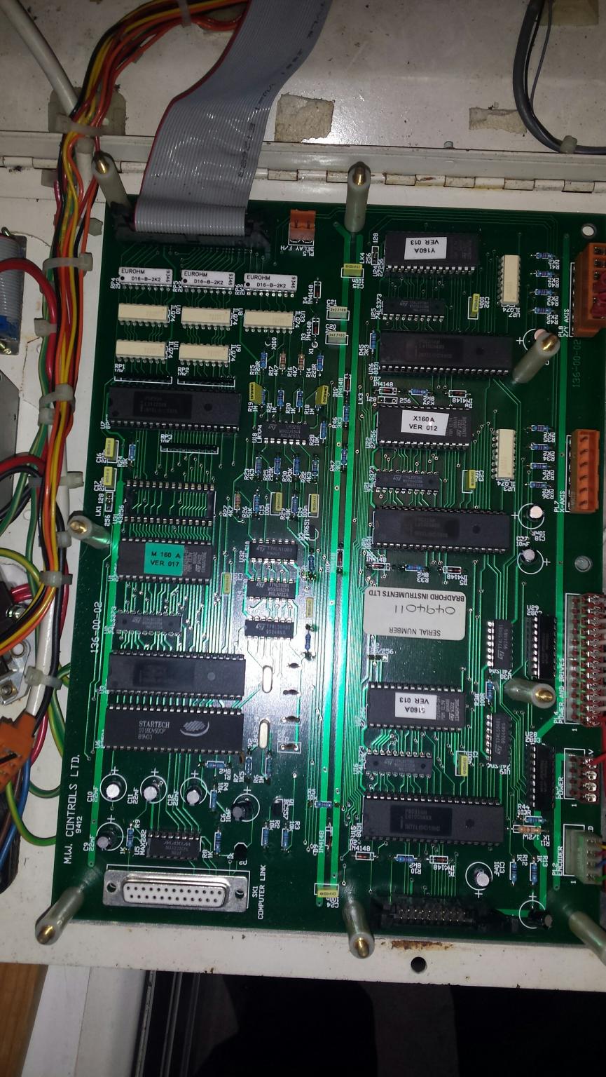

    Need to establish what is preventing these traverses from traversing.
    Off now to try and trace these interlock wires , Now where did I leave those sidecutters?
  4. #34
    Have traced the interlock wiring and tested . All seems fine
    Tries the rotary feed controller in all position - no difference
    Am I right in thinking that if interlocks were not in there proper positions then spindle would not be expected to start (which it does , forward and reverse and speed variation on both) so relay and lenze controller seem sound .
    Will go and inspect the upper board with the stepper drivers .

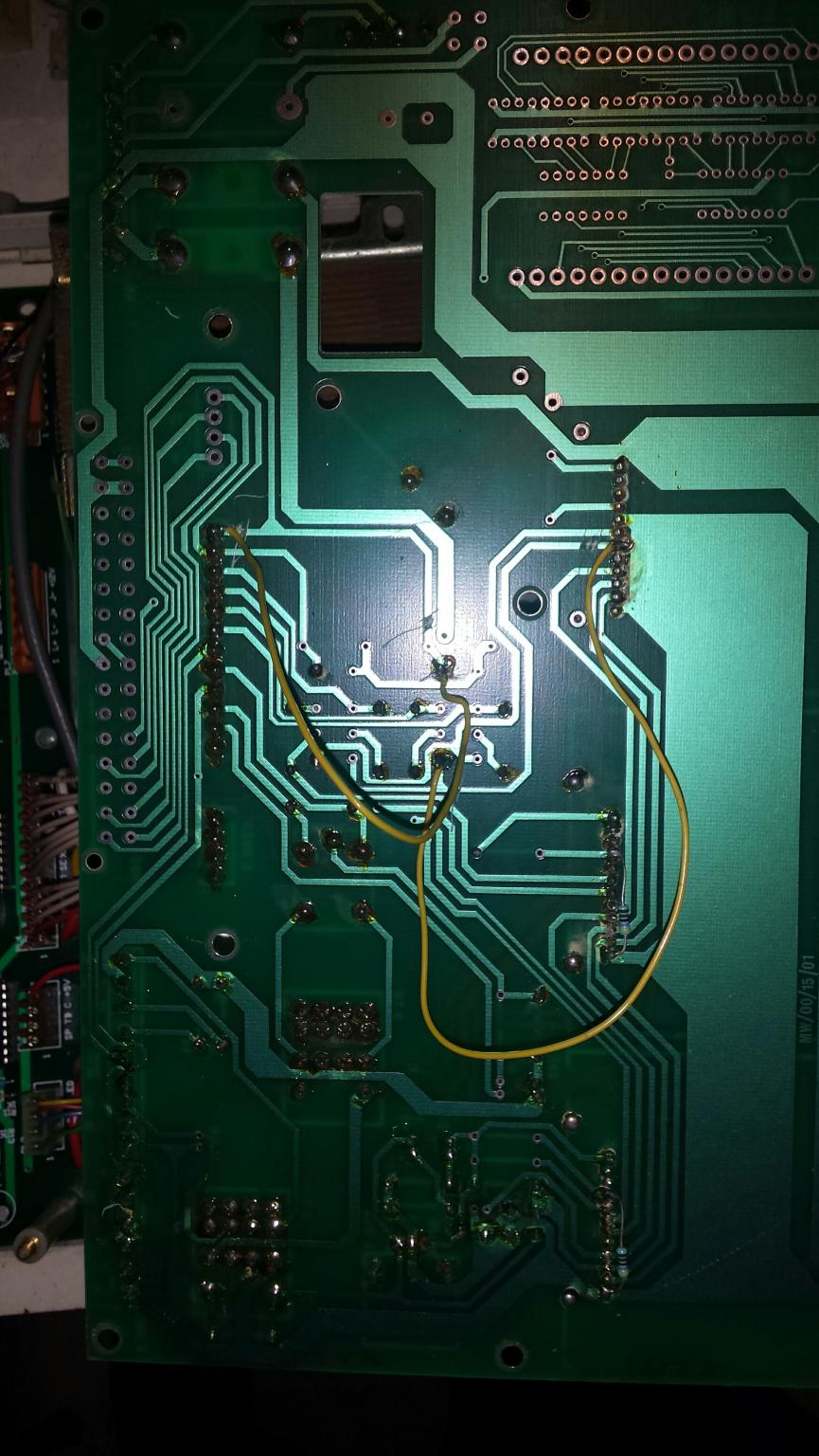

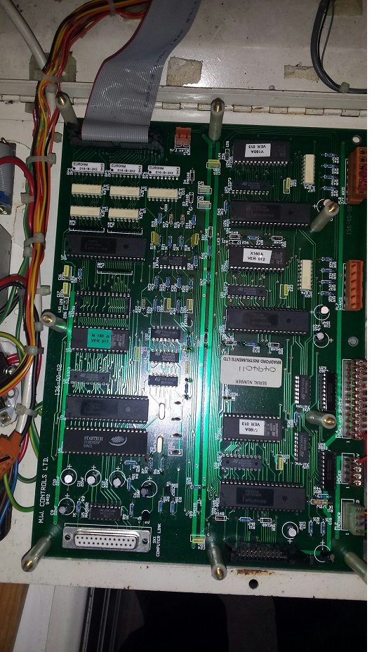

    Pics of boards
    Some dubius looking repairs on the upper one ???
    Any thoughts anyone

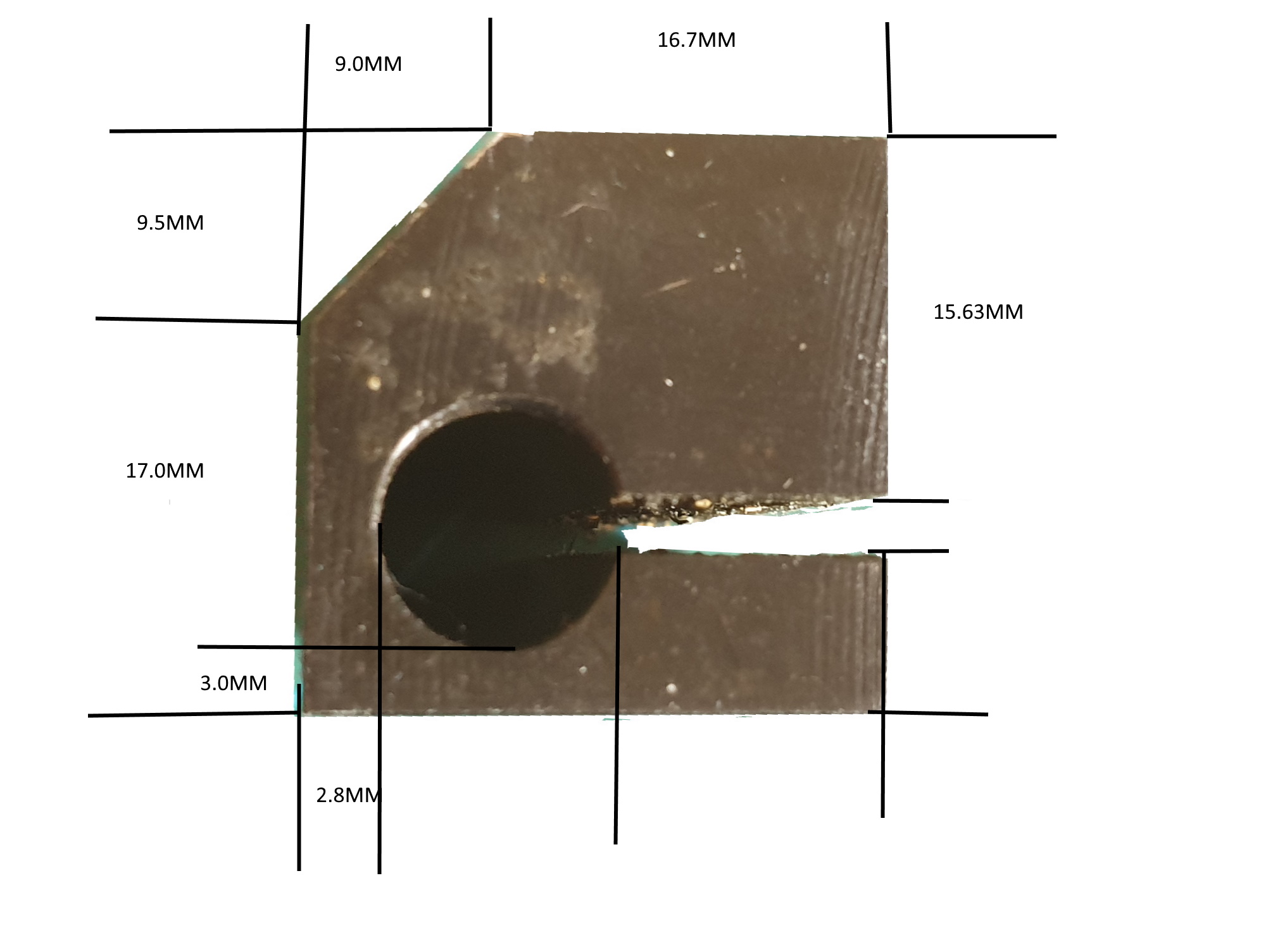

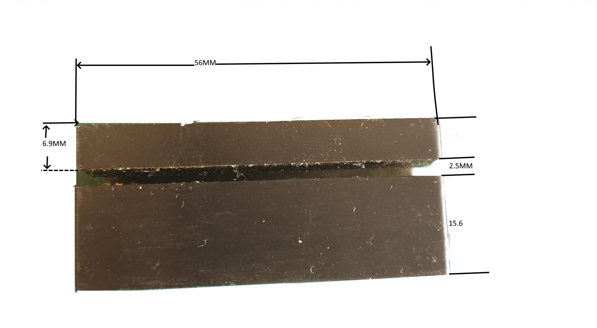

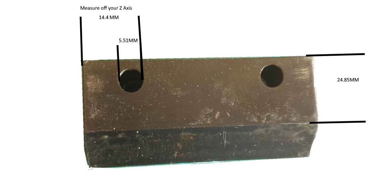

    Here's the dimensions of the Z Axis actuator rod.
    Forgive the look of it as I'm not good with paint programs. the rod is a 10MM dia bar. The 2 missing dimensions on one pic take from another as for some reason my paint program decided not to allow me to put text on anymore

  11. #40
    Thanks for that Inee and to all that have helped me with this thank you too .
    Manual doesnt help a lot , but I feel that interlocks and and spindle controls seem OK
    Voltages at transformer seem good and seem OK at the board connectors, and all LEDs light up , but I wonder if I can follow supplies across the board.
    Any suggestions on best way??
