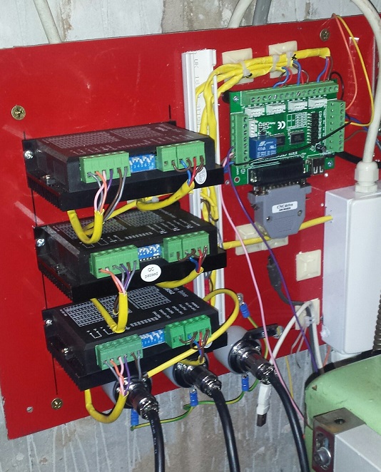

    Linux does sound a bit intimidating when and maybe a further complication. I think I would like to get this machine up and running before going to another level.
    I have been thinking out of the box
    My mill table has plugs on the drive board for each axis cable .
    If I were to make two leads to plug into x and z sockets and connect to x and z motors on the lathe then I should at least be able to test the axis motors .
    I do have Mach 3 on the computer so should be able to call up a Lathe profile and set it up.
    I might not even need to buy any gear at all. A good Yorkshire solution maybe , but must be careful not to upset the Lancashire men

    It should work for testing
    Long term it would not be a great solution
    Are the stepper voltages similar?
    Re linuxcnc for a basic setup the step and configure wizard will work perfectly
    Download the package and burn it to a DVD then pop it in a laptop or desktop and let it boot from the cd. You will be able to run a ‘test’ version to get a feel for it before you install it to a hard drive
    I can talk you through the very basics of linuxcnc if it helps
    Paul

    If you have the drives already then it's a no brainer to use for both. Clive S did this for years and run a Mill and Lathe from same Control box using a change over switch. Obviously you can't run both together but how likely are you to ever do that.?
    Like Depronman says for a basic setup the Linux CNC Config Wizzard is easy enough to use and it costs nothing to try. You already have a working machine and know all the I/O pins so just try a Config with the settings for your Router and plug into a parallel port. Lathe is pretty much the same just less axis.

    Hi folks
    Both axes jog fine when attached to my PC and Drivers, using my current mill profile and jogging X and Y so looks pretty much like the driver PCB in the machine is shot.
    I will set up a lathe profile on Mach 3 just to check that I can operate that!
    I will then go back to suppliers and see what they suggest with regard to their misleading description and the work I have put into getting to this point. I think I will insist on a replacement board at least , even if I do not use it.
